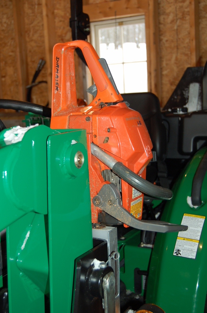

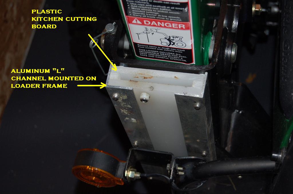

I finally took some photos of the chainsaw holder that I have mounted to the FEL post on my new Montana. I fabricated it out of aluminum L channel and plastic from a kitchen cutting board. The saw is now always in an out of the way, easy to reach location. It does not rattle at all and the cutting teeth are well protected. Greg

The unit is mounted using (6) 2 1/2" x 1/8" stainless bolts which go through the aluminum, then plastic, and spacers on the back side. I drilled through the frame and put nuts on the back where I could access and tapped the ones I could not access. Greg

I knew someone would bust me on that, let me see about a pic...

Nice idea. I have a question about it. It looks like the chainsaw is just sitting on the mount with the only thing holding it being the bar in the holder. If you hit a bump is there not the risk of the weight of the saw bending the bar. If that is the case I would think that a piece of industrial strength velcro wrapped through the handle around the FEL post would add a bit more holding power to the saw and be easy to use ?
/ Chainsaw holder
#17
Gemini
There is no bottom to the holder so there is no weight on the bar. Secondly, if you look carefully at the photos, you will see a screw with a nylon spacer in the center/top of the holder. The sharp prongs on the front of saw (which keep it from slipping on the log) fit nicely around the screw and keep it from moving. Because it is a snug fit, the saw does not bounce a bit when hitting a bump. Greg
