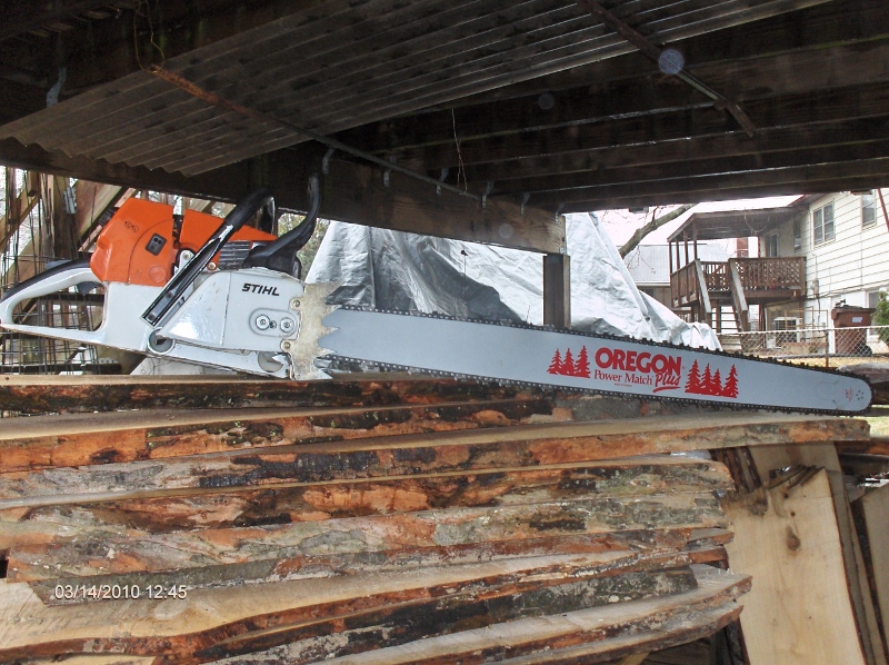

Saws 'n bars:
Efco MT 3600 ($50 - 10", 16")
Stihl 021 bought new about 10 yrs ago (12", 16")
JD CS 62 (won/free, 20", 28")
Stihl 660 $510 from ebay (28", 42")
Cut logs like a bureaucrat cuts red tape, lengthwise.
