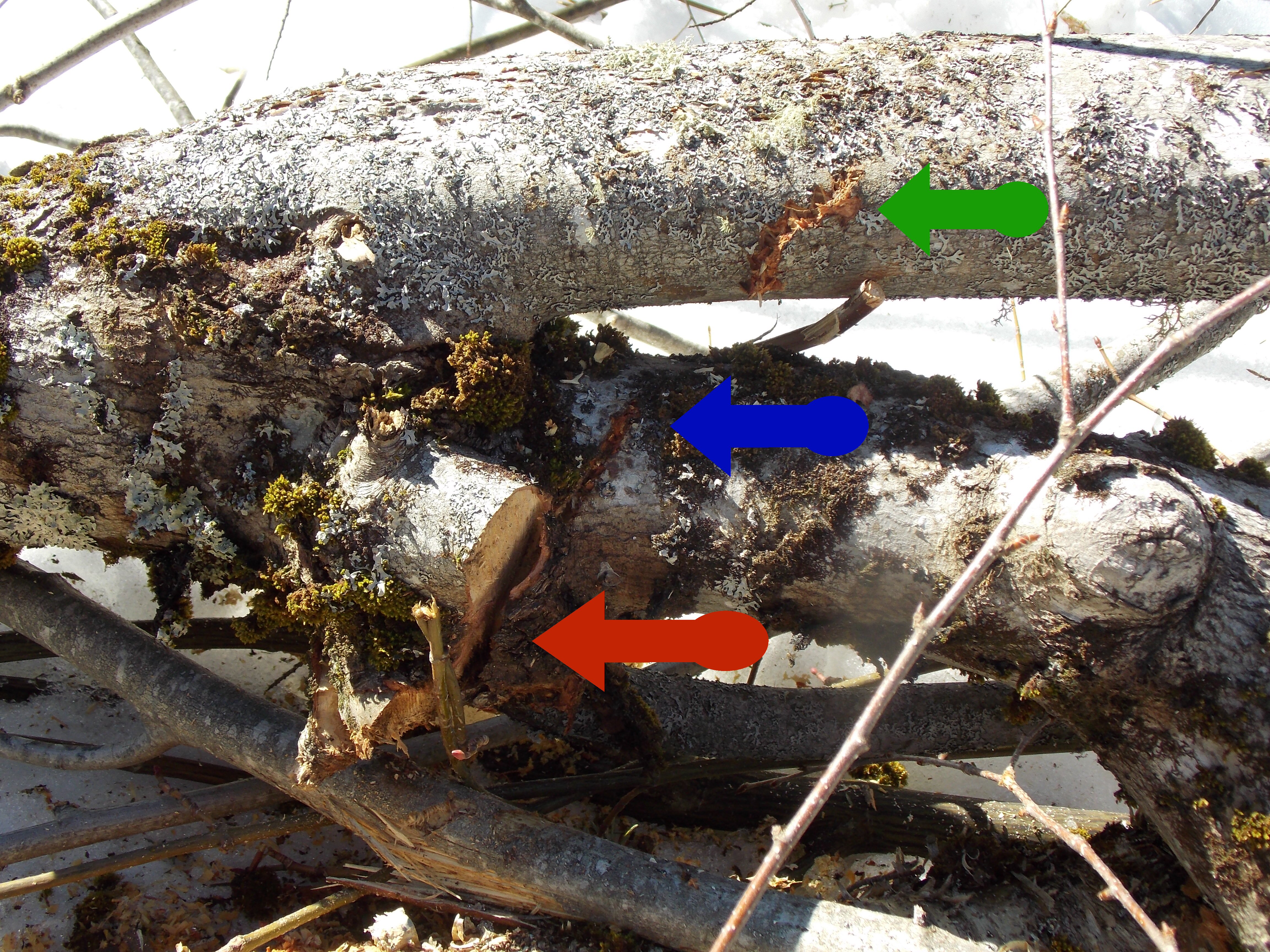

The third time was when I cut through a spring pole. That one sent the saw right between my eyebrows at full throttle. I managed to make it to the house, and than by ambulance, and 20 stitches and 4 days in the hospital.
Here is the spring pole I sawed through...
But there are only two logging accidents: minor ones, and the ones that kill you. All mine have been minor! (LOL)

Years ago when clearing up after Hurricane Isabel, I remember there were zillions of spring poles to contend with. They can be tricky little SOBs and will get you, as you experienced. I got real good at nibbling away on the tension side of the wood to relieve the danger, but even that can be problematic. Some of them will shear right down the middle (just like a small barber chair effect) and pop on you anyhow.
When I was sitting in the hospital, I was thinking, "this is no big deal, get right back on that horse and ride," But in real life it was not that way at all. I was pretty gun shy. For the first few weeks I would take the skidder and pull the trees off any spring poles that I saw, but there are a LOT of spring poles in the woods. That just took too long.
I got back to my old logging self after awhile, but it was longer than I cared to admit.
