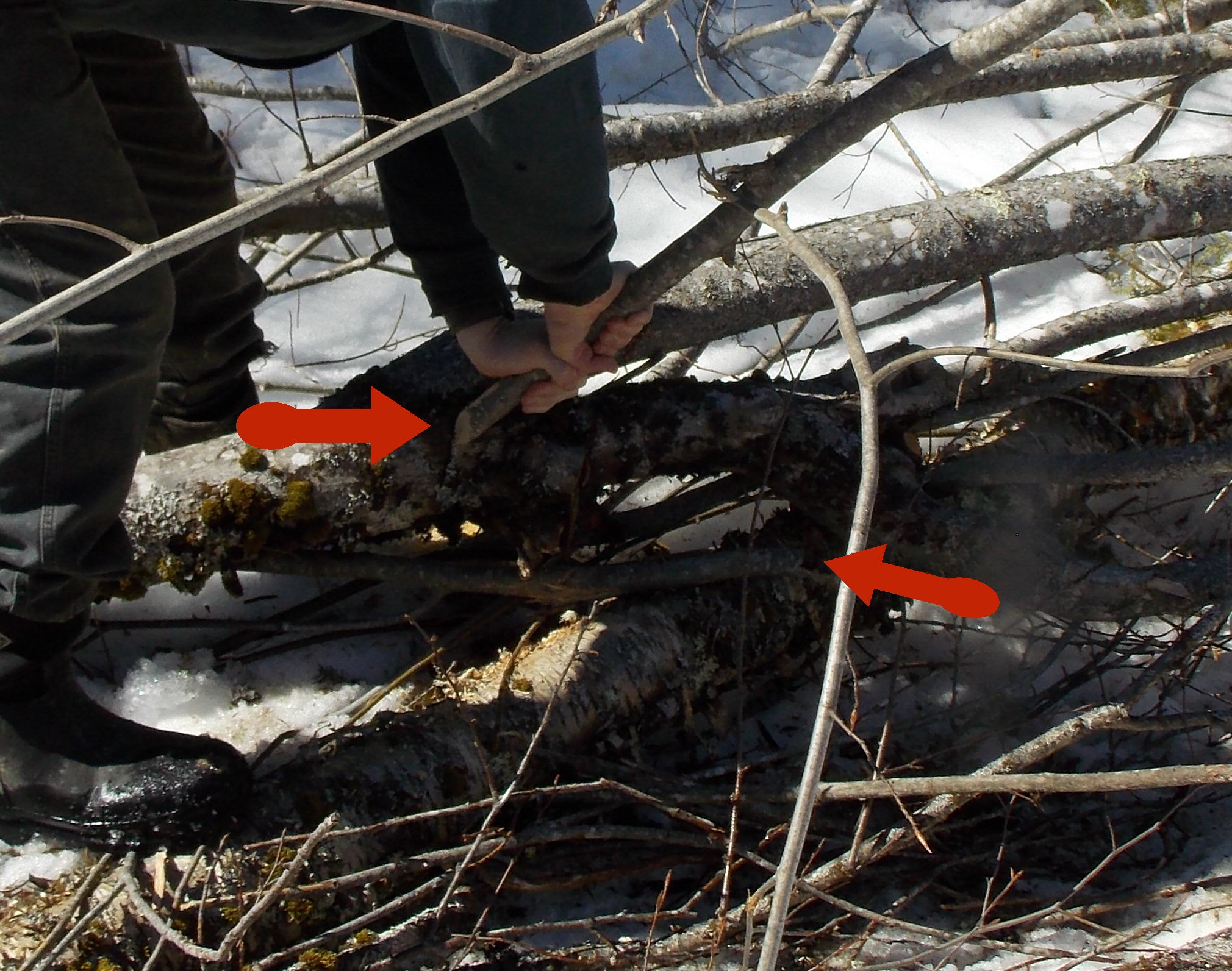

The second was when I working in waist deep snow, and topping off a tree. I was treading through the snow as my saw came down right through my upper thigh. I take sugar in my coffee so I had sugar packets and clotted the cut with that.

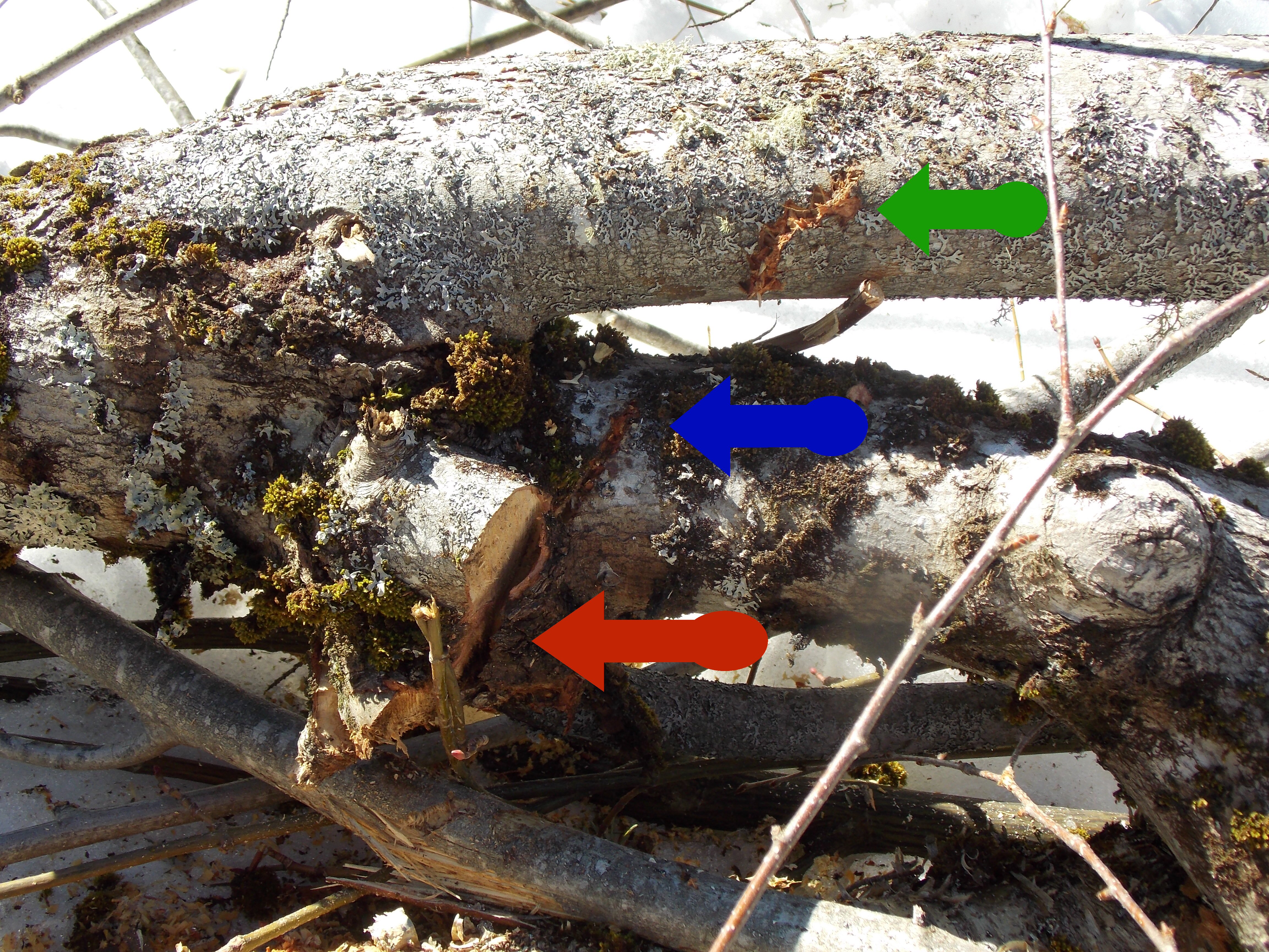

The third time was when I cut through a spring pole. That one sent the saw right between my eyebrows at full throttle. I managed to make it to the house, and than by ambulance, and 20 stitches and 4 days in the hospital.
Here is the spring pole I sawed through...

Years ago when clearing up after Hurricane Isabel, I remember there were zillions of spring poles to contend with. They can be tricky little SOBs and will get you, as you experienced. I got real good at nibbling away on the tension side of the wood to relieve the danger, but even that can be problematic. Some of them will shear right down the middle (just like a small barber chair effect) and pop on you anyhow.
