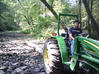

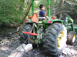

I had similar problems......trees down in the creek, etc... Except mine were big sycamores.3-5' diameter and they were hung up on the bank too. I could not get to them through the woods with my tractor, and the creek was 2'-3' deep or more. I was afraid that cutting them would snag me and I'd be trapped underwater (forget the chainsaw / oil concerns).
My solution was to use a bow saw to hand cut the loose branches and tops in the creek so it reduced the opportunity to create a dam, and then do nothing else ........let nature take its course......until this past summer when all the creeks dried up due to the severe drought. Then I just drove the tractor straight up the dried creekbed and using the FEL as support, cut long sections and dragged them out with chains.
Can you wait for a "low tide" time of year?

some camera phone pics with my son on the tractor in our creek. Dragging smaller limbs out.
