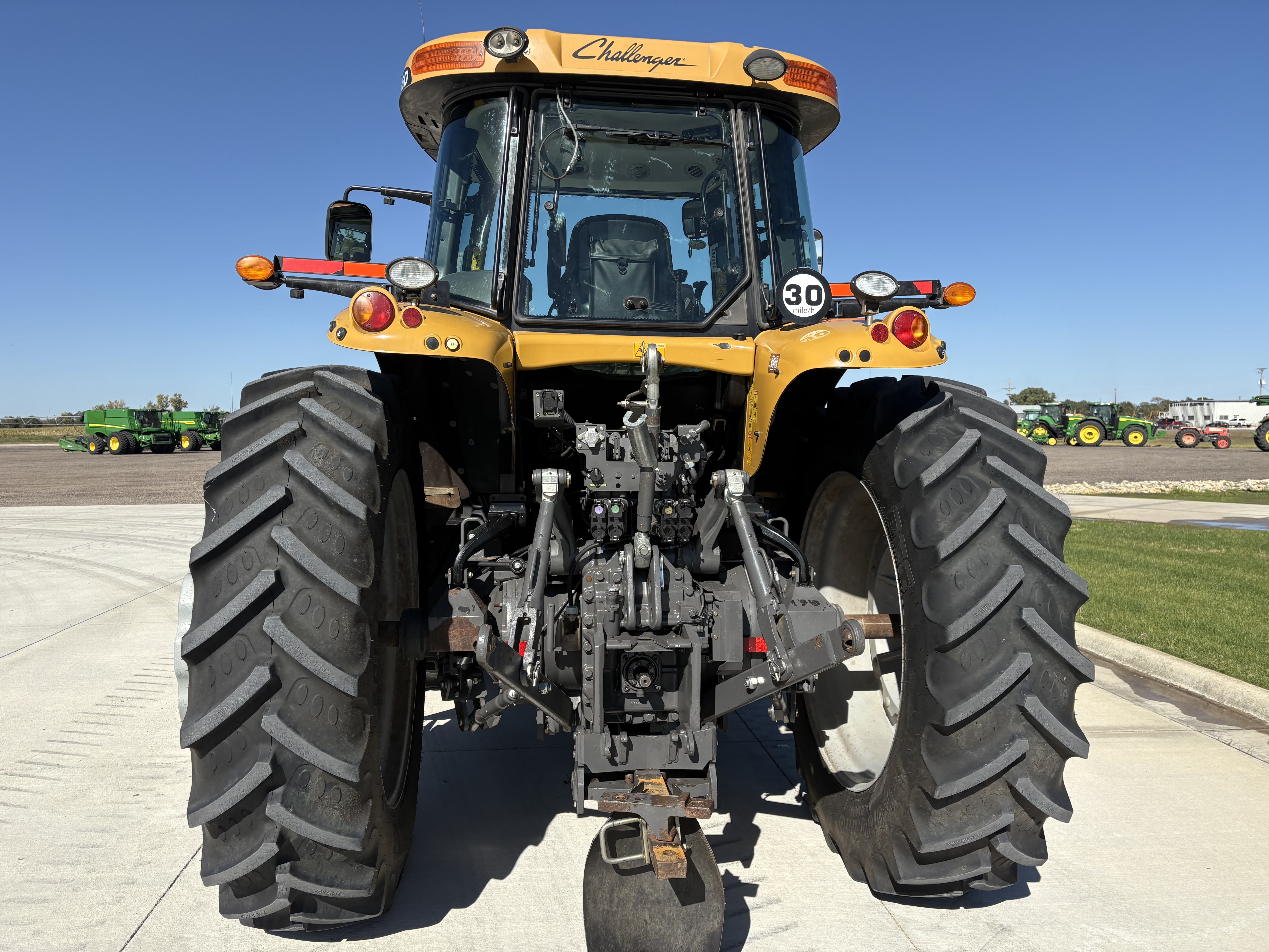

First wave of information came in. Visually, tractor is in very good conditions.
1. programming is done and was a very simple fix. She is now 50Km/hr (33 MPH) again. (y)
2. What we thought might be a seal between CVT and hydraulic system was actually a broken bleed screw. Simple fix. It would have been $3,000 to fix seals. (y)
3. CVT will get new filters and AGCO CVT fluid. Normal maintenance.
4. Hydraulic system will get new AGCO hydraulic fluid & filters. Again, normal maintenance. (y)
5. Actual hours on ECM are 3,200. Dealer told me ~2,200. This doesn’t surprise me and doesn’t really bother me either, as 3200 hours is still very low for a 14 year old AG tractor, so I will just leave that alone. I’m a little annoyed, but dealer did not have the software to get actual hours and I knew this.
Now for the “unknowns”:
1. Engine has slight tap under valve cover. There was a know issue with the AGCO Power 6.6L breaking a stud or could be a valve lash issue. (n)
If it’s a simple fix, I would still be at or about the $4-$5,000 I estimated it would need in repairs.
2. Both front suspension accumulators show leaking and are probably both flat. Both accumulators are $1,400. (n)
Right now Parts are 15% off, so I can apply that to all AGCO parts.
So far, I’m actually still feeling pretty happy. Most units like this with more hours were selling for $95,000-$115,000 (and may have needed any number of repairs, too).
I hope to get all repairs and including trucking and be under $85K
5 years ago, I bought my smaller, older 535B with a loader & trucking for ~$75,000. But it had 5,500 hours and needed brakes & other repairs, too.

Got another update.
The tap under the valve cover was a typical valve job. Little on the early side at 3,200 hours (I’m more used to every 5,000 hours). The valves were adjusted and new set of rocker studs were installed. It was a suggested update when valve covers are off. Tapping is reduced 90% according to my tech.
Instead of replacing front suspension accumulators, we are going to recharge them.
Seat needs a bushing and cab suspension accumulators are shot, so we are pulling them off and installing springs in place of the hydraulic cab suspension cylinders.
I will hit 4-5K with all that and the previous list I revealed a few posts ago. I am about to say “uncle” and settle with that. I have only bought one larger Ag tractor that didn’t need some repairs in the low-mid single thousands and this one looks to be no different.
