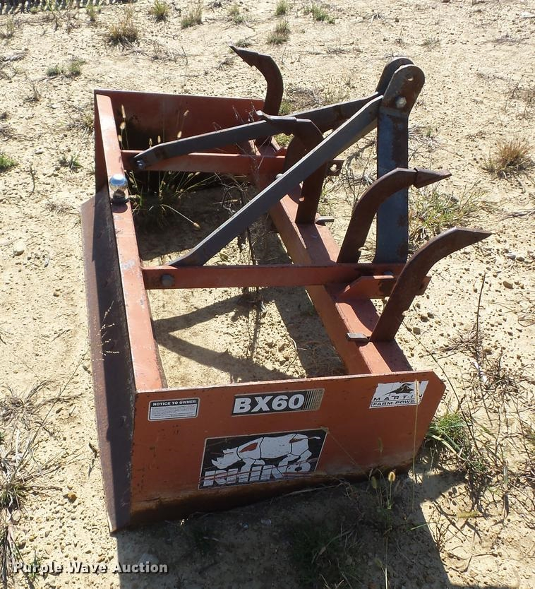

This is the model of box blade I have and because the sides taper up from the lower back corner I can get the scarifiers to dig a few inches in without engaging the blade. However, with square cut sides it may me close to impossible. The OP can modify his box blade so that the bottom edge tapers up a few inches and achieve what he wants. It may cause the blade to leak a little dirt out the sides when moving it, but I never found it to be a significant problem
   / Changing angle to use rippers only #38
Take a look at pictures of new Rhino BX60 box blades and you will see that the sides are square. What you have is a very worn box blade that has been used for too long tilted forward.
