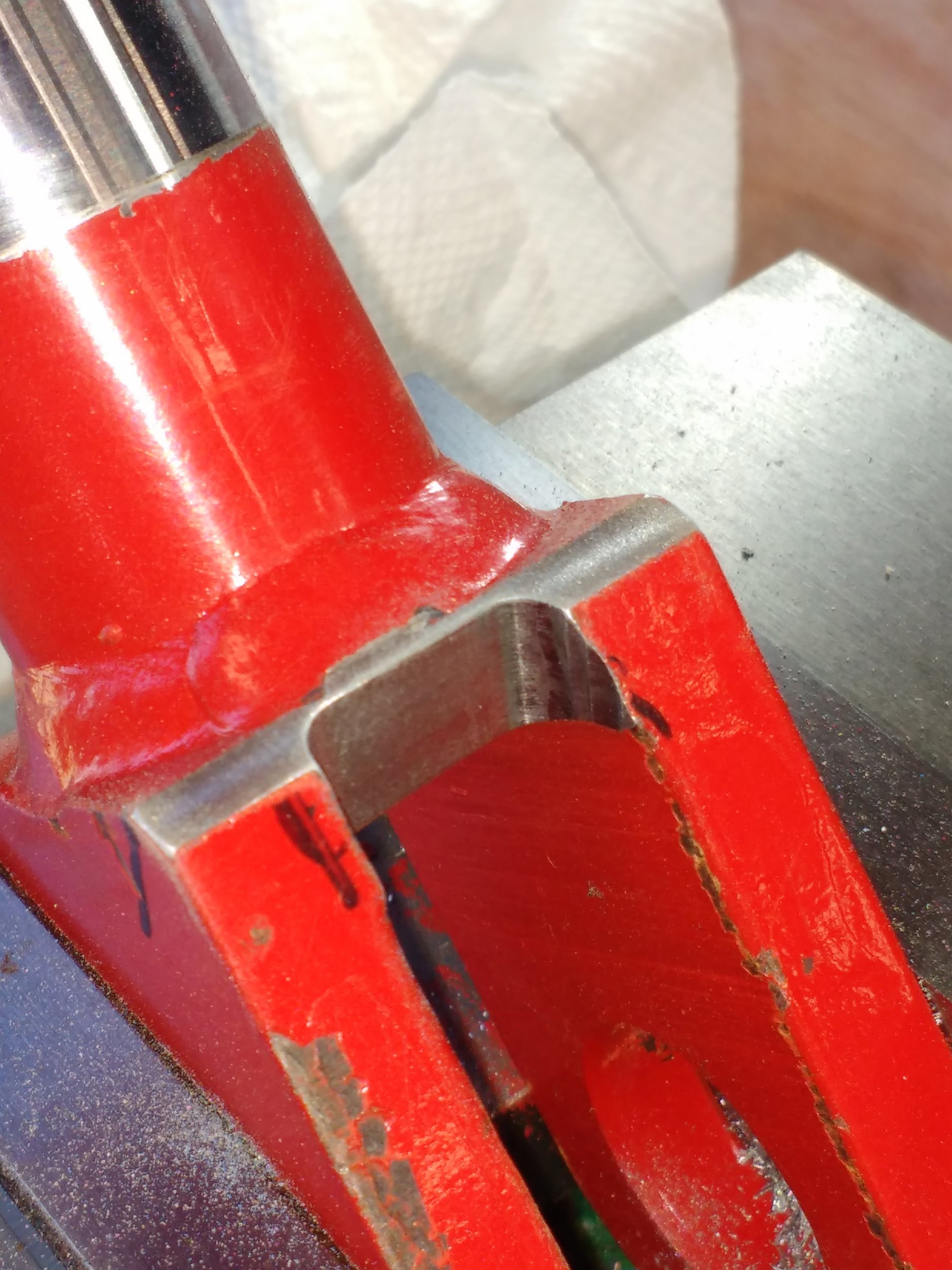

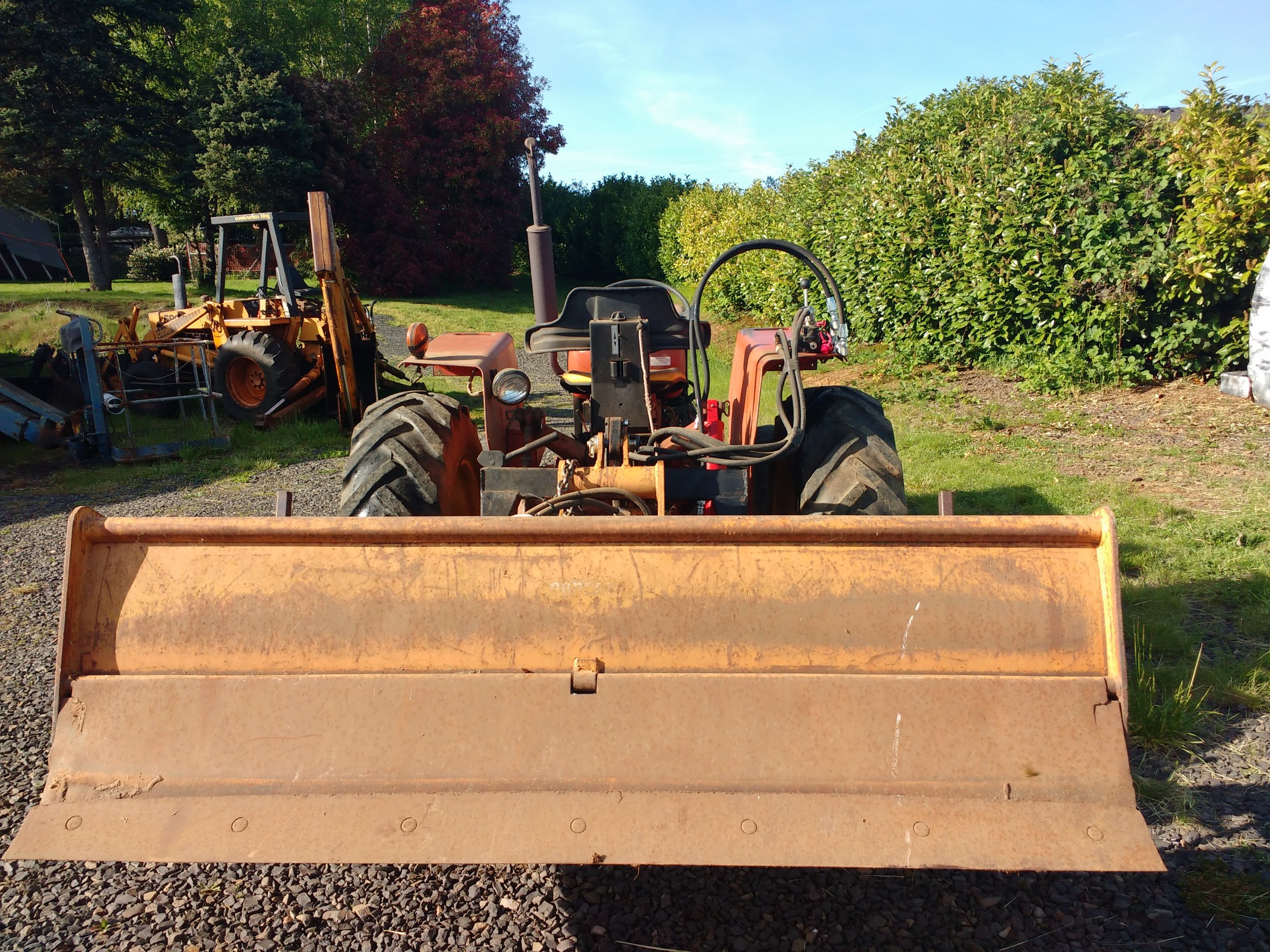

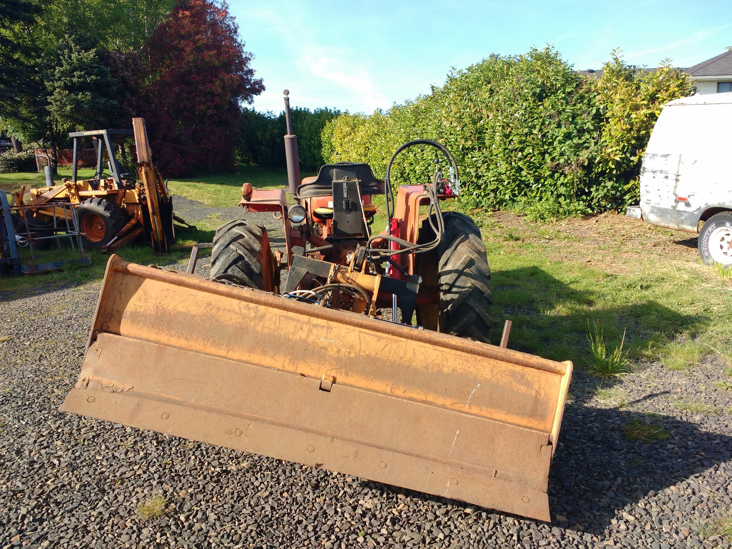

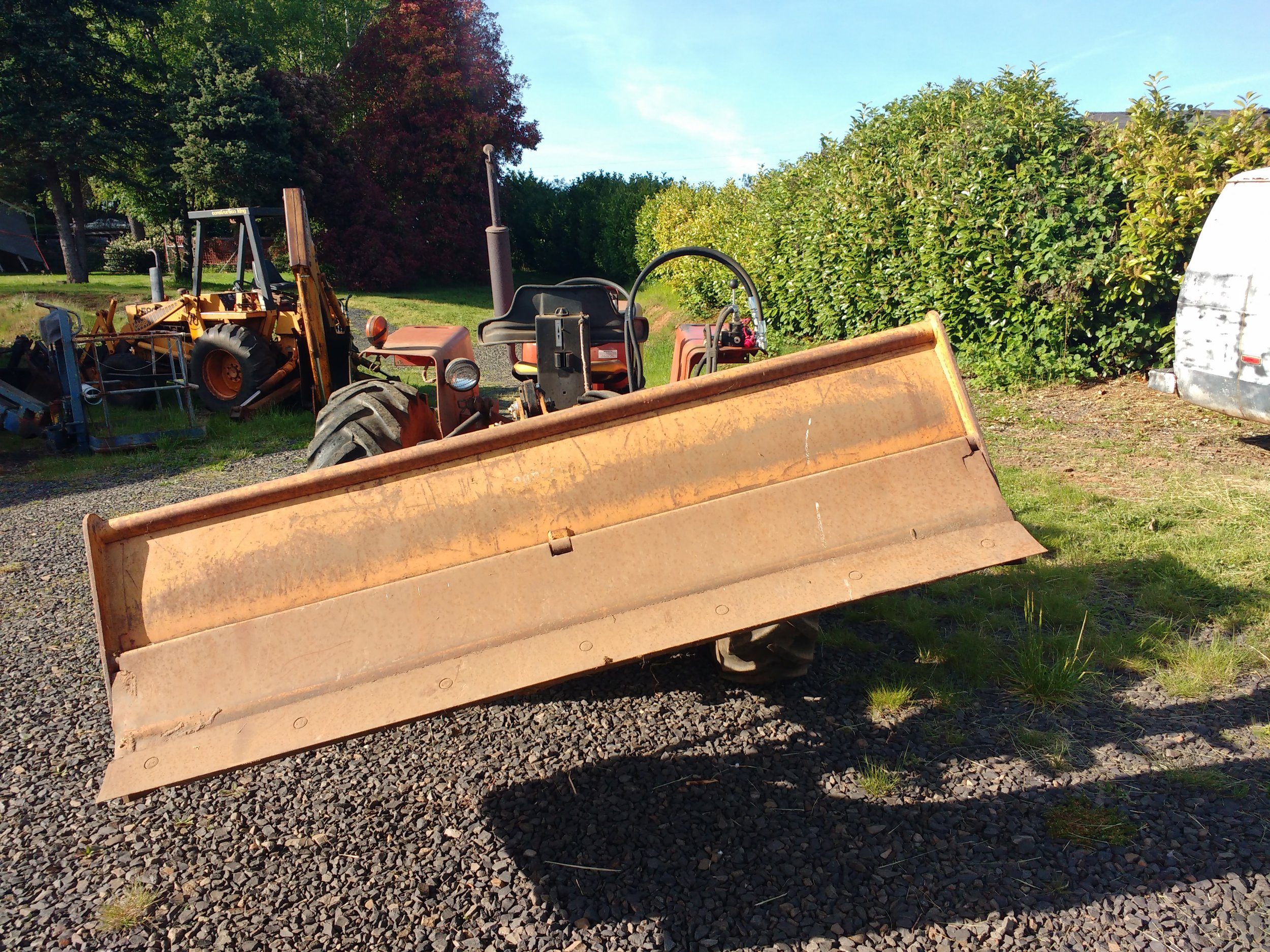

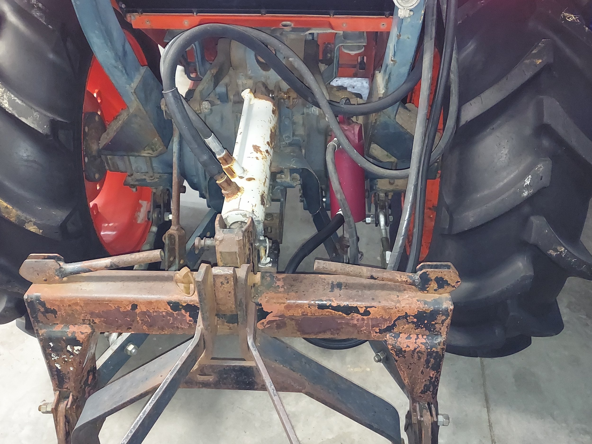

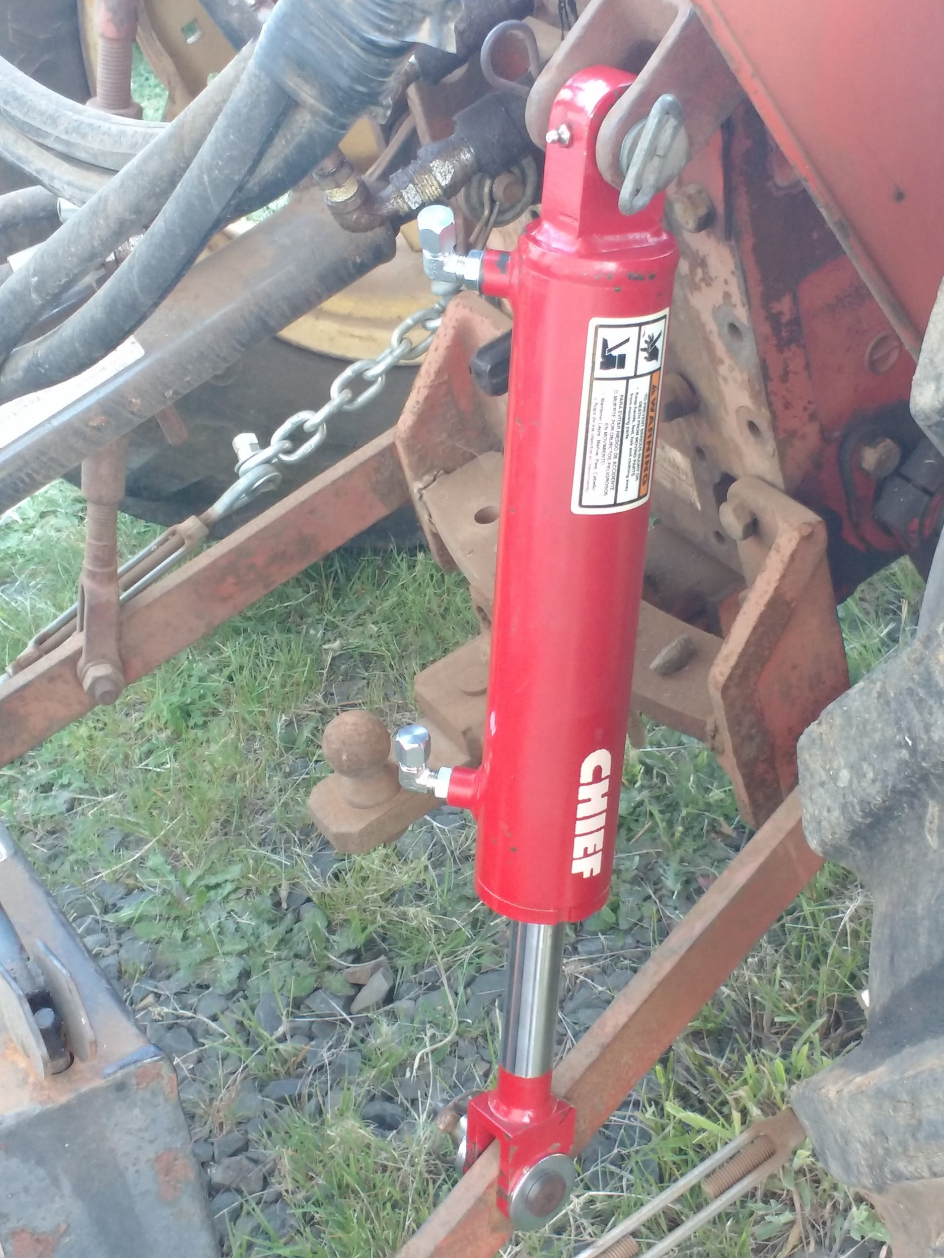

That was BEFORE I got tired of switching the backhoe with the 3ph (can't do that with Case hoes newer than mine) and bought another tractor - I got kinda spoiled with the Case 3ph attachment, it had top/tilt, float AND power down right from the factory - took me awhile, but I added top and tilt to my old Allis 160 - bought the toplink and did my own side link, lucked out (surplus center) and found a cylinder with 10" stroke that only needed a bit of machine work instead of replacing the lower yoke -
The longer stroke on tilt lets me have nearly 2 FEET of range from hard left to hard right. Now all I need is to finish rebuild of the ripper cylinder and add another diverter to the allis :unsure: ... Steve

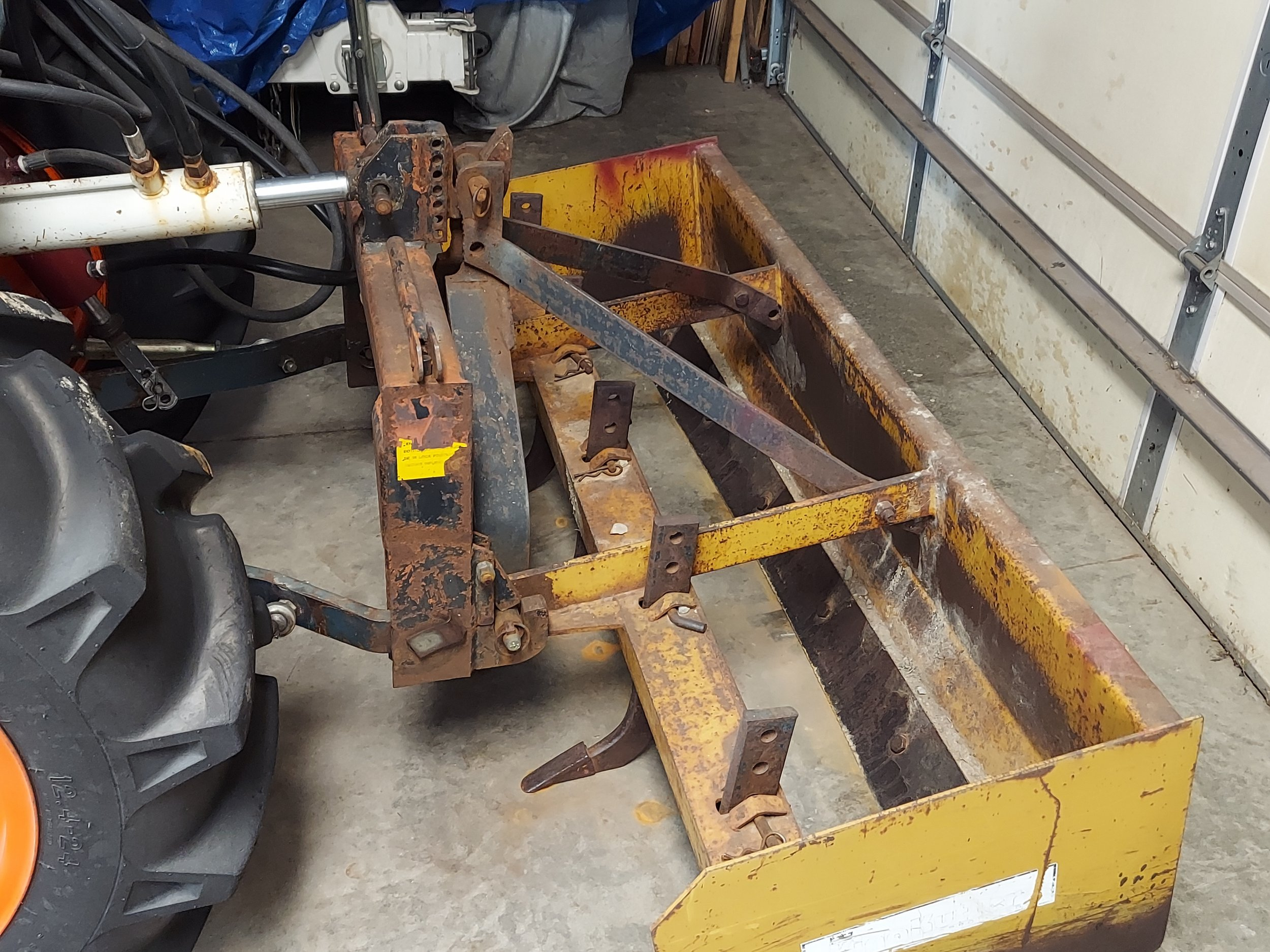

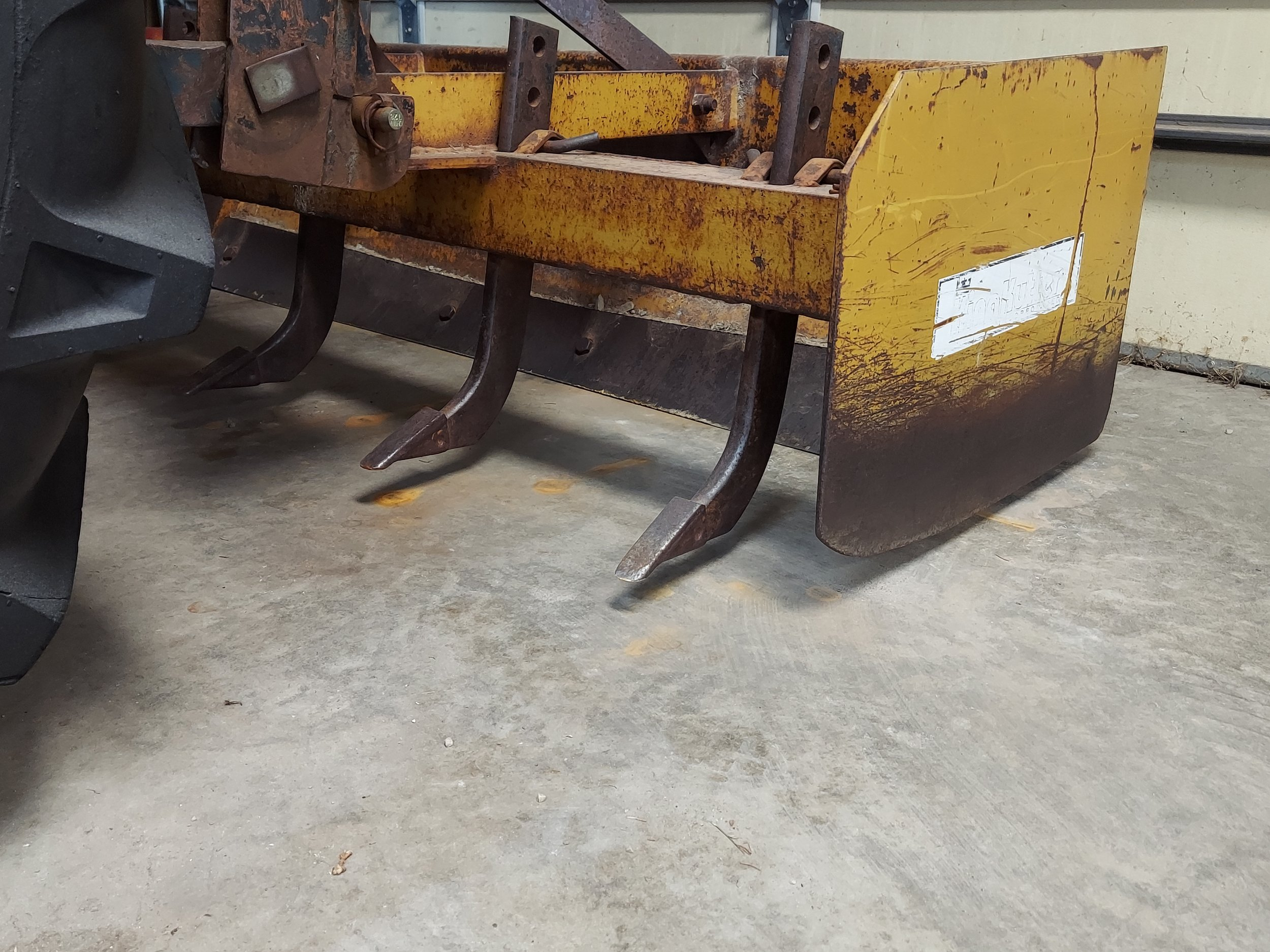

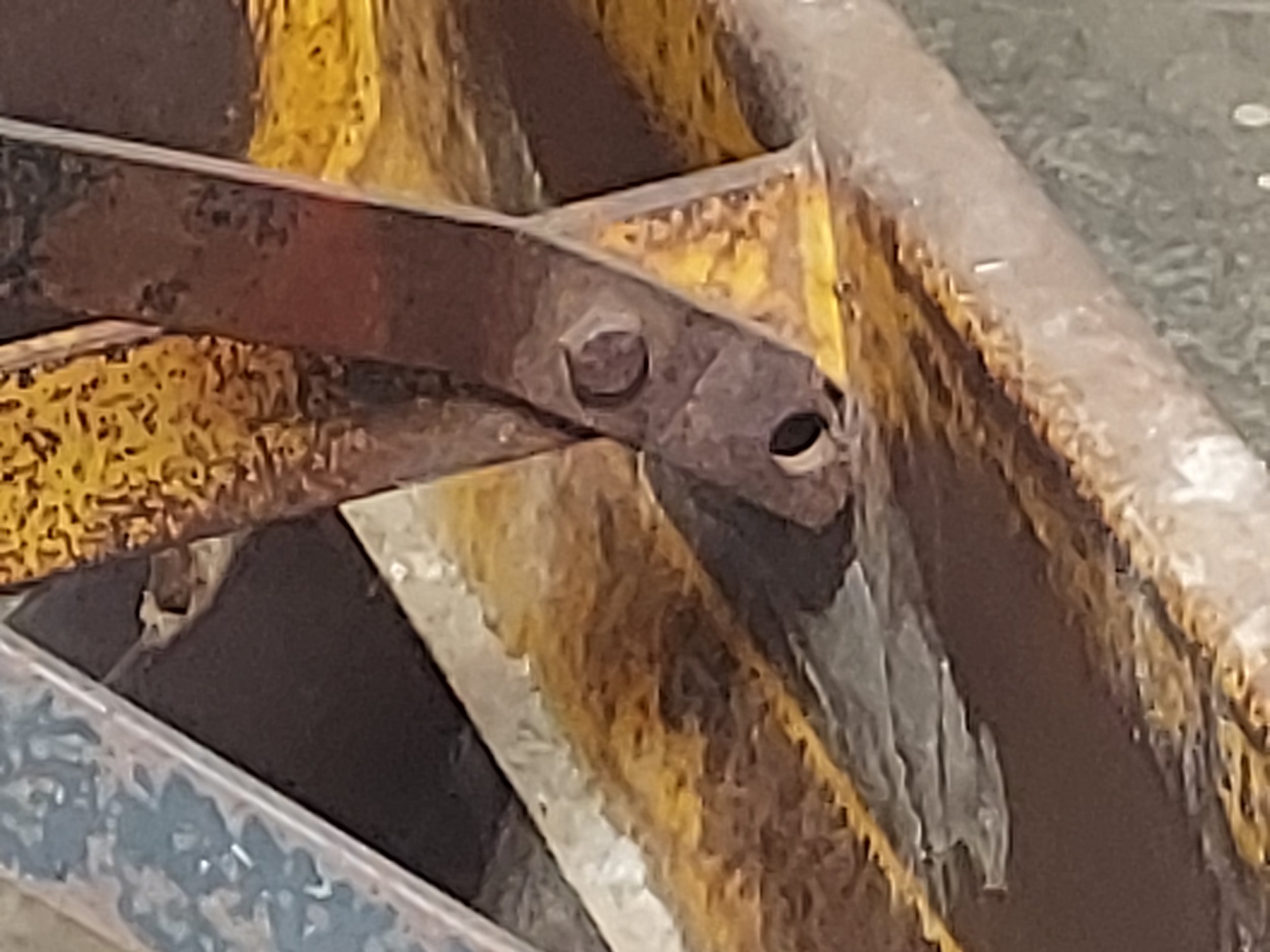

Just thought I'd throw some gas on the fire. I use my box blade to pull rocks and junk out and break up the soil with the unit tilted forward so the shanks are digging. Then tilt it back and smooth over or collect it all. I did notice that when we modified the King Kutter 25 years ago, there was a second set of holes in the support arms coming off of the center pin area. This allowed me to tilt the 3 point part of the box blade back a little so that when I tilted the whole thing forward, it really changed the angle of attack for the rippers. If I really want to dig, I repin the shanks to their lowest hole, but otherwise I found that the middle hole allows the shanks to dig, sometimes too much and I have to lift the blade up a bit. The sides of my box blade will dig in right next to the shanks because the shanks are pulling the blade down. I am using a quick attach, and have modified all of my attachments to fit on it.
Dang, that is sweet. Im guessing the 580 weighs enough for down pressure to actually accomplish something? The only 3pt with down pressure ive ever used is on my Case garden tractor, and down-pressure was pretty much just a 'reduce traction' feature until i filled the rear tires. It could use more weight to use more down pressure but i haven't got around to that. I suspect down pressure in general is far less useful when using larger implements that weigh more in their own right. I have tiny machines and my 60" box blade is probably the heaviest implement i own (not counting a backhoe) at 350 ish pounds. I did add 115 additional lbs to it by bolting a 54" loading dock bumper to the rear face. :ROFLMAO: I did notice that that made using the rear blade to push in reverse much smoother and less likely to skip up over things.
