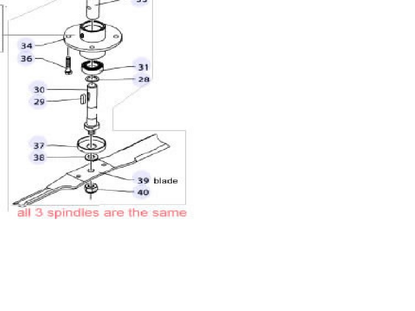

I've tried every way I know and can't get the blade off.. Any one have one of these. I think it's a 2013 model bought it in June this year. Thanks for any help.

Do You stop the blades from turning some how ? If I put a socket on the nut on the top it will just turn. If I stop the blades with a 2x4 it will just slip without the bolt giving..

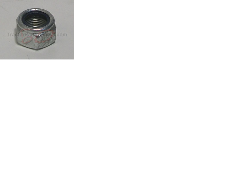

My three blades are held on by NUTS (the type with nylon inserts), and I do hold the blade with my hand during this process, but it does not require any real pressure.
