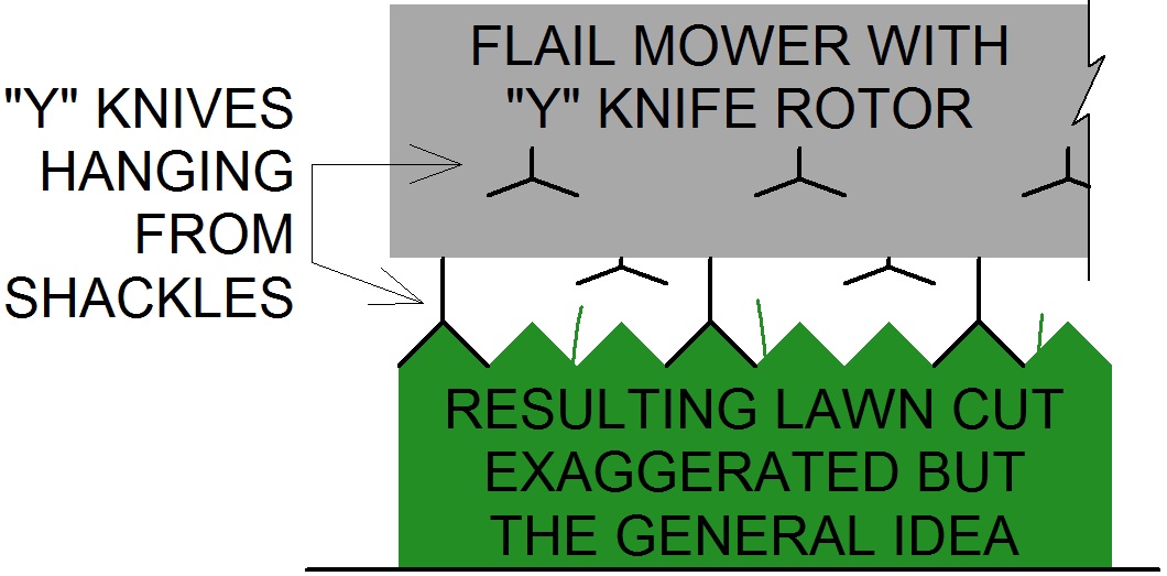

The "Y" knives on my dad's Caroni TM1900BSC result in a "good" cut but not quite great, & not quite equal to a finish mower ... which is what I'd like, if possible.
I think that part of the reason is that the flail has less upward vacuum. And I think another reason is that the Y knives cut like this:
attachment.php
The Caroni and other models of flailmowers have a very small rotor and no air paddles to create a Pressure Gradient to enable the knives to mow more efficiently. The majority of finish flailmowers in Europe have large diameter rotors and air paddles to do two things:
1. the air paddles create the pressure gradient to improve the mowers ability to cut grass and brush and fill the collection basket or 2. permit better cutting of turf if the grass is too long and the same pressure gradient created by the air paddles allows you to recut the clippings if desired and carry them into the collection basket or over the rotor and back down to the ground after they have been cut a second time.

I have used it on a lawn mixed with St. Augustine & Bahia grasses when the Bahia stalks had started exceeding the height of the St. Augustine, & the results were just what I drew: Good job, but not great ... leaves me wanting to go over it again hoping to get the Bahia stragglers the 2nd time.
