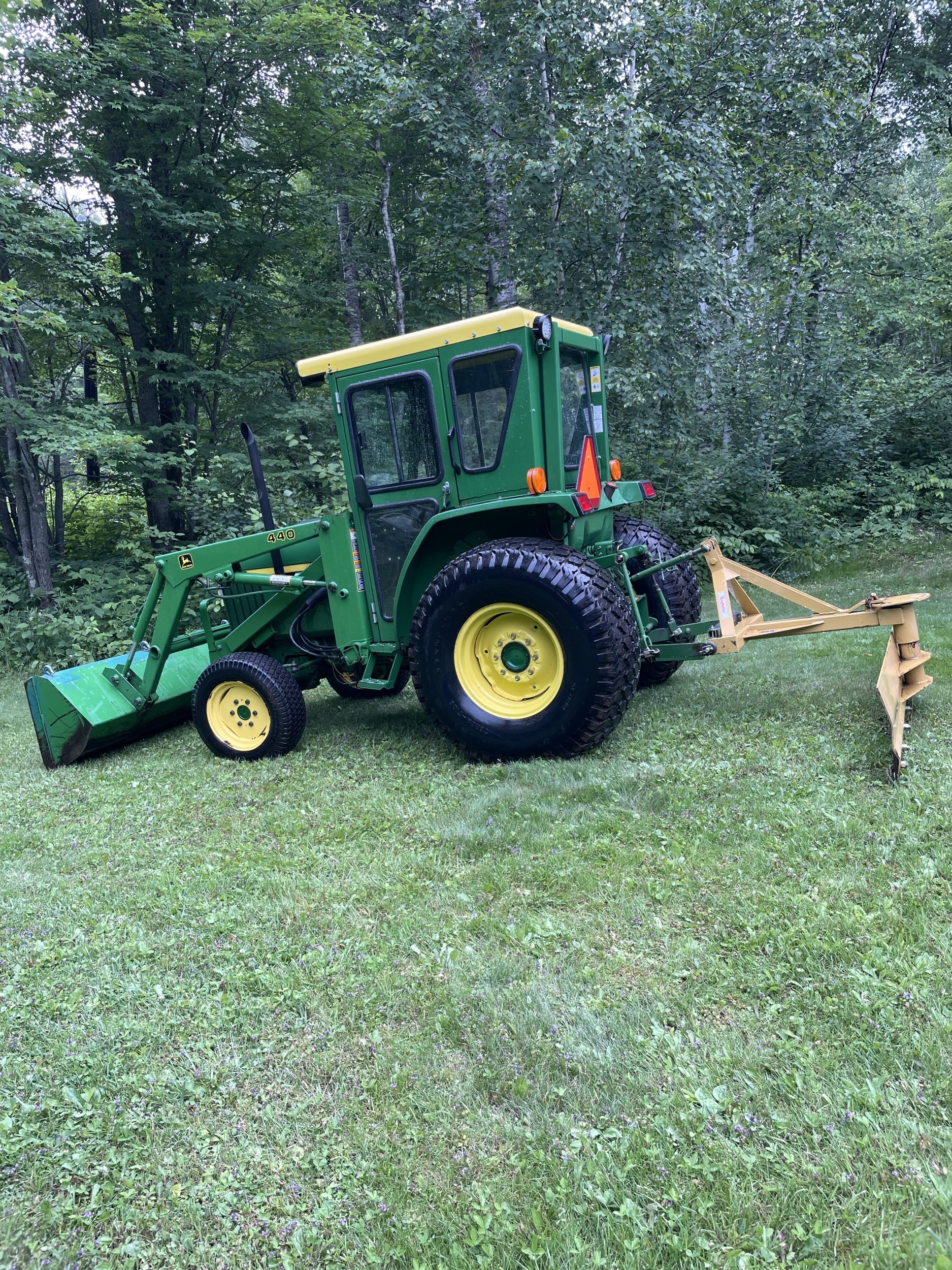

John Deere 1070
Here’s my ‘96 JD 1070. I use it primarily for snow removal on my long, gravel driveway and it’s never let me down. I enjoy the heated cab. My only complaint is with the manual transmission and bucket controls it’s hard to enjoy my hot coffee!
The tractor was owned by a local school district, kept indoors and used primarily for mowing the athletic fields. (It came with a 72” belly mower if anyone’s looking)
Now, my question. It just rolled over to 1,000 hours. I didn’t get any maintenance history when I bought it, but I’m assuming they followed the recommendation to change hydraulic fluid every 500 hours. It had 800 hours when I bought it and I’m going to change it now before next winter, but never having done it, I’m a little concerned about things like air lock, etc. I have the maintenance manual describing the steps and I bought a new JD filter and ten gallons of aftermarket hydraulic fluid.
Any tips, tricks, normal problems with doing this?
I’m working alone, so I want to get it done on my own.
Any thoughts or suggestions?

Very nice tractor. And the right previous owner. That series of JD/Yanmars is one of my favorites, and we've had a dozen tractors here.
The hydraulic can't air lock. It's an open hydraulic system and always vented. The air will be swept out by the moving fluid in a matter of minutes at most. You probably won't even notice. Working the loader will help that, but again I doubt that you will know.
Check and see if you also have a cleanable screen type hydraulic filter on the side of the transmission (sump). I believe that yours did. That will definitely need a cleaning at 1000 hours. The additional hydraulic spin-on filter is like any other. Use a genuine spin-on, it is heavier built for a reason.
On the hydraulic fluid, if you got JD Hy-Gard trans/hydraulic oil you are good to go. BTW, DO NOT use hydraulic oil. Hydraulic fluid will ruin it. What you want is dual purpose transmission/hydraulic fluid. Your transmission and hydraulics share a common sump.
That dual use fluid is much more expensive; it has to be thin enough to be hydraulic fluid but have the shear strength of a gear oil. That magic is done with additives - which is why it is so much more expensive. This isn't some sort of conspiracy; good trans/hydraulic oil will go a thousand hours but it is costly. The JD Hy-Gard is a proprietary formula - as are all the trans/hydraulic oils. There are no lubrication or additive standards for trans/hydraulic oils, so there is no way an after market oil can meet a spec that doesn't even exist. The JD Hy-Gard has the specific additives for the internals of your transmission & hydraulics. It isn't the only good oil on the market, but the all cost about the same. Part of that cost is in the additives. The high dollar oils have an additive formulation that protects brass and bronze alloy bushings, Look it up if you are curious. There are other good transmission/hydraulic oils. I'm not pushing JD products, if you know what you are looking for, Chevron makes one and so does New Holland, Caterpillar, Kubota sells one that they don't make, and there are lots of others. But they all cost about the same.
You have found a tractor that should last a lifetime. If you would rather use aftermarket oil to save a few bucks I'd stop and question the whole project. Maybe just change the filters and call it good. There's a way to do that which kinda works. Why gamble?
