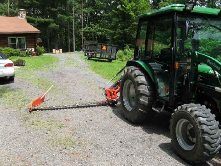

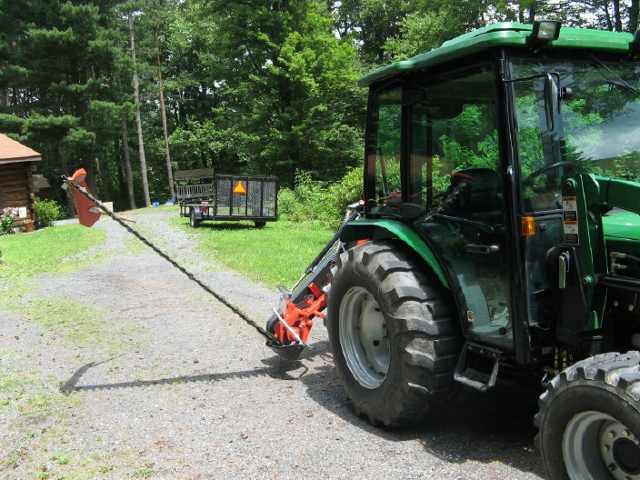

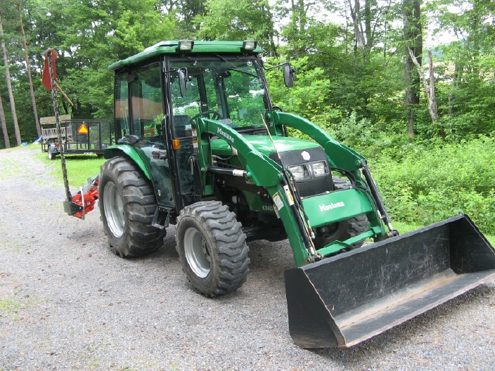

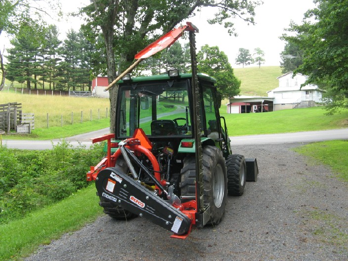

The Befco mower... Yes I have it!! I got the 7 foot model. It is a real mower. I have mowed the county road for a mile each way from my house... I have mowed about 2 acres of field... and trimmed about 2 miles of tree limbs on our farm roads with the mower set straight up.... I have cut limbs up to about an 1 inch or a little more with NO problem. I have also lost a nut here and there, so you need to inspect all nuts and bolts after mowing... It is a shaker, but the lift is GREAT... It can be positioned anywhere from 70 down to 90 up at the touch of a lever.... I am quite pleased with it. I will get some pictures up in a day or so.... It is raining here now....

Hey are some pictures of the mower... When I get a chance I will add some video to YouTube....

I ordered mine off the web.... Mowers
I also paid by check which got me 5% off so the total came to just over $4906.
The 8 ft model was several 100 more and I did not need the extra foot... as far as the tractor handling it... No problem. The ad says a tractor of 25hp will work and I am sure it would. I just did not want to pay the extra for the 8 ft. Like I said I am quite pleased with the mower.
