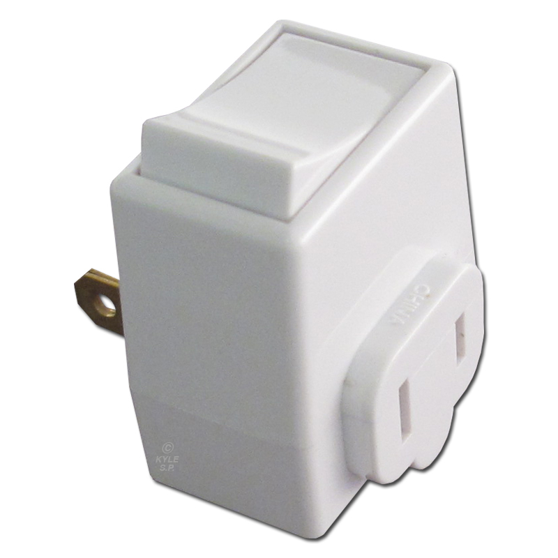

Recently my internet has been getting slower than tower congestion and sometimes stops working with a message about the DNS Server. I just turn off the power switch that it's AC power supply is plugged into, wait a few seconds and turn it on. Works fine for a day or two.

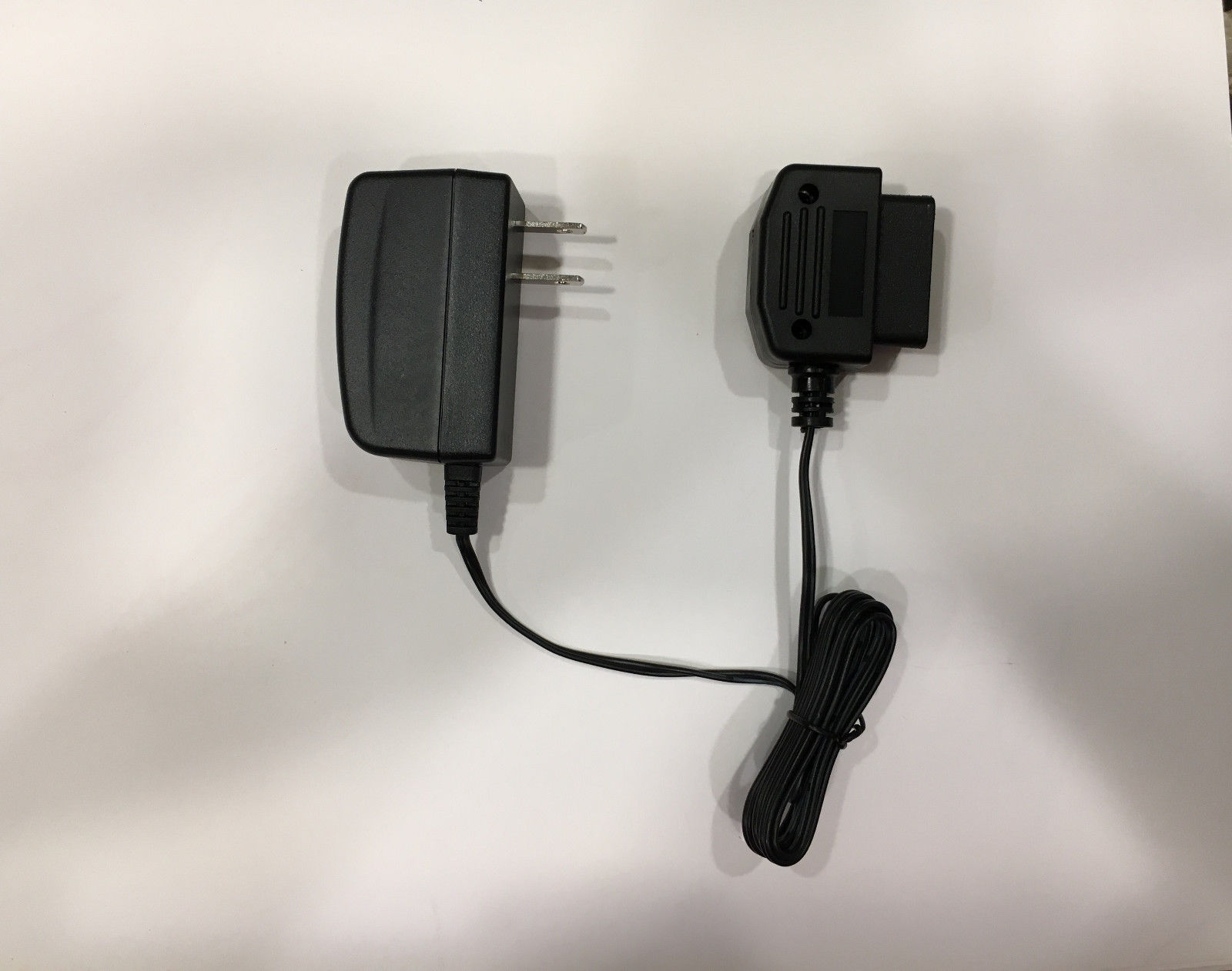

Tell me please there what AC power supply will fit, need some kind of definite?
I always try a reboot first.
The one I got om eBay: AC Adapter for AT&T ZTE Mobley OBD 2 LTE Wi-Fi Hotspot Device | eBay

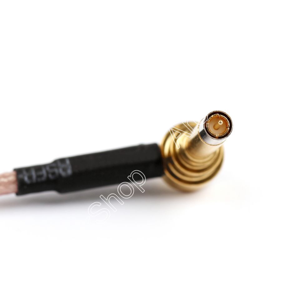

Maybe some of you can help me decide what connections I need. I want to move my mobley and gl-ar300 router out of the hot window but I need to keep the antennas where they are. I wrote down the mobley antenna connection somwhere but not sure what to use as an external antenna. I guess for the router I just need to know what the antenna connection is called so I can search for an extension cord.
Any help with this is greatly appreciated.
The mobley is the critical piece. You can move the router with a longer usb cable, it doesnt need to be in front of window. I tried a remote antenna on the mobley without success.
The Mobley antenna connector is MS156:
More antenna info in the first post here: AT&T Stand alone AT&T Unlimited ZTE Mobley Hotspot now only $20!!!!!!!!!!
Have you tried positioning the Mobley for fastest signal, not strongest signal? Go back and read my experience using fast.com: https://www.tractorbynet.com/forums...onth-stand-alone-post4756325.html#post4756325
