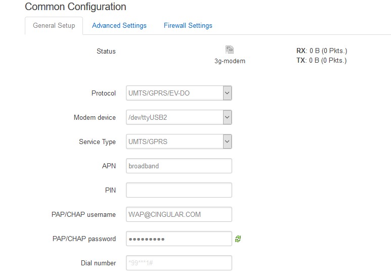

On one of the AR pages, maybe network page, there is link near top that says something like advance features. When you click, you get another login page. This takes you into linux level interface with a lot more options.
Yes I've been there. Could not find anything helpful....but that could be because of my limited knowledge.
Point of confusion....the connection between the router and mobley is via usb cable. I remember when setting this up, I couldn't really find any documentation about the usb port on the AR150...and still can't. But I hooked it up that way based upon long ago post in this thread....I think...and it work....until now.

jcummmins has your ar 150 ever worked with your mobley ? or are you trying to get router to work for the 1st time?
if it is the 1st time- mine acted the same way until I input the DNS setting to the AR 150 I originally thought the cable was bad but it was fine. I don't recall having to change the default USB setting.
I know it is possible to get to the ar 150 screen and change settings without any other internet access than is provided by the mobley and no other data cable than the 1 provided with the ar 150 is needed except for AR 150's power cable, I used a 5 volt phone charger.

GL-AR150-4b6 router and yes usb cable to Mobley.
Obvious in router view it says cable connection for internet not connected.
I tried to find the setting under advance, network, to set usb2 from usb0, but router screen different than yours and can't locate.
It simply acting like the cable isn't plugged in.
Sometimes the obvious but unlikely solution ends up being the actual solution. Try a different USB cable.

On my issue I plugged into my truck and drove to the ATT store to verify I was in range of a working tower. Still no signal from the Mobley. Called customer service and spoke to some very helpful people that determined my unit has failed. I was instructed to contact ZTE for a warranty replacement and swap in my existing sim card.
   / Cheap $20 a month Stand Alone Unlimited Rural Internet through AT&T Wireless #1,316
Before you send it back did you do a full 30 second power on reset of the mobley mine quit a few months ago and the Only thing that got it working was a power on 30 second hold of the reset button

Well....I switched cables...no change.
I did finally find the page in the router that buckeyefarmer gave the screen shot on. It's set with the usb2.
No I did a few second reset while on the phone with ATT. I never saw a clear indication of a red led though. Just tried this on your advice. My LED never turns red so it appears reset isn't even working on it but it came back to life.
THANKS!
Edit: My elation was short lived. Speeds are in the toilet now. Made sure stream saver was still off but getting 790 kbps. Gonna try restarting again.
