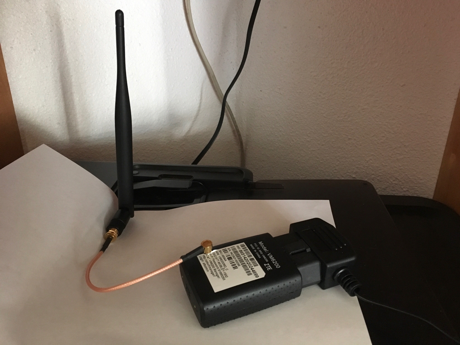

Got the antenna mod install, pretty easy. Followed to HoFo link.
I then drilled a hole in the case:
Only seeing about 5-8 db improvement, but that good enough to move the Mobley to the interior spot I want to place it. A quick Speedtest 15/5. Considering my successor ISP is want $80/month for 10-15mb dl (shared, not guaranteed) this for $20 is a bargain.
I want to stabilize with a bit of museum putty. Will likely try the Yagi antenna at some point.
Now to get Mobley hooked to a Picostation.
Does the case snap open easily?
   / Cheap $20 a month Stand Alone Unlimited Rural Internet through AT&T Wireless #254
Yep, 2 little Phillips head screws near the OBD connection, a tab each side about half way along the length. I found then with a small flat screwdriver by carefully opening near the screws.

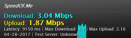

How can I find out why my speed is so slow?
Today with -101 dBm:

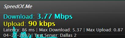

Yesterday with -120 dBm:

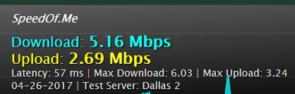

Fastest on 4-26 with -100 dBm:
One man's slow could be another man's fast. I was getting -117 dBm and 2Mbps in places and was concerned, until I drove into town and pulled 14Mbps (didn't record dBm) at a random site.
