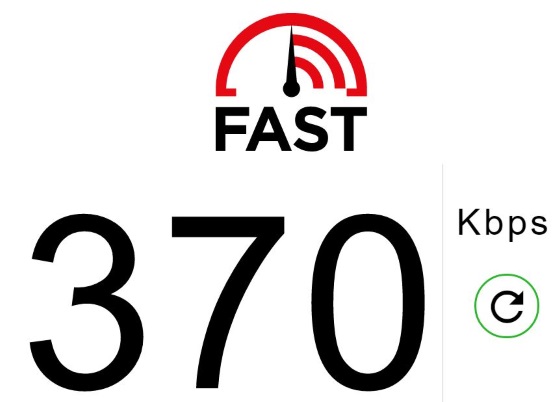

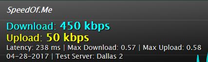

Usability is almost unusable on TBN right now:thumbdown:
Signal is 103 dBm, speed is terrible.

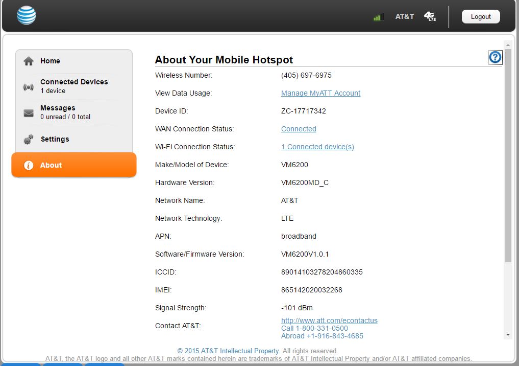

Today with -101 dBm:
Where are you seeing those signal strength measurements? Is there a unit that is displayed, maybe something like "RSRP"? Or is it just saying "dBm"?
Second, when I talked to ZTE support about the problem of my Mobley's signal light not coming on he indicated that anything below -90 dBm (i.e. your -101 is lower) is "extremely bad signal that is almost unusable. I took that with a grain of salt, because with -92 dBm I was getting I was reliably getting 25-30 Mb/s download. But still, signal strength plays a major role.
Rob
You needed more like a couple of pounds of salt! :D That's nonsense. -101 (assuming this is RSRP) in the LTE world is not bad. But what matters more is SINR (Signal to Interference Noise Ratio). You can have a strong signal and still have a very poor quality signal, and your speeds will reflect that. It's a lot less common in a rural areas, but it could happen. If you are sitting on a hilltop and getting strong signal from multiple sites, you can get clobbered and have poor service, with full bars showing.

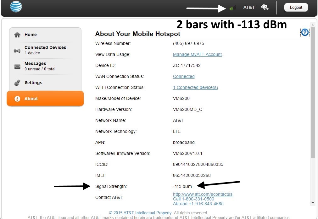

how are you finding the Mobley signal strength?
Go to 192.168.1.1 and log in.
Click "ABOUT", signal strength is near the bottom.
It updates rapidly, so you can change location and see the resulting signal strength.
Lower number is stronger signal.
Note the 3 bars indicator at the top
And 2 bars with a weaker signal.

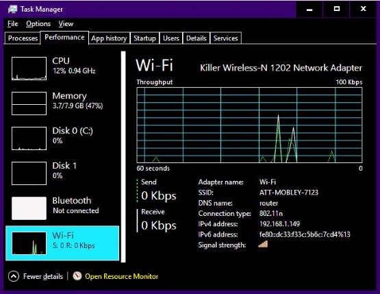

Looks like you have 3 bars of signal.... sure your not to far away from the mobley wifi signal wise.
   / Cheap $20 a month Stand Alone Unlimited Rural Internet through AT&T Wireless #275
Yep, not too far, it is 8 feet, line of sight to the window.
Task manager shows 5 bars wifi signal:
