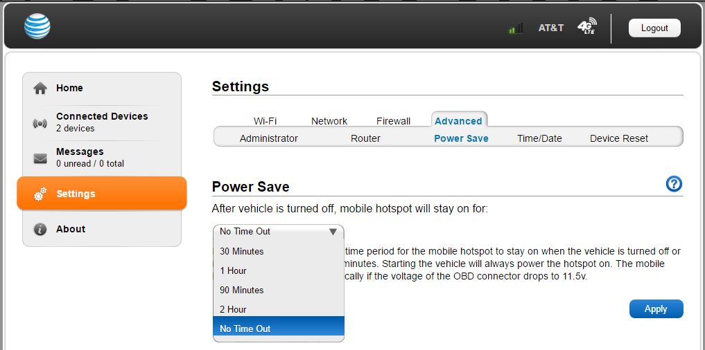

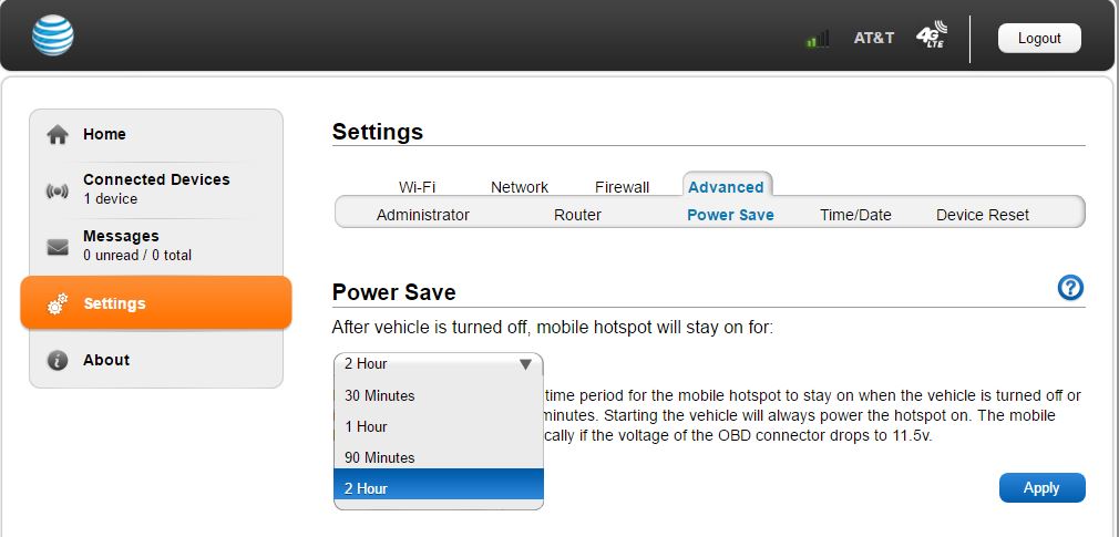

In the picture above, do you see the software version with V1.0.1? New devices start with V1.0 and then update to a new firmware over the air. After your device has updated to V1.0.1 you can set the device timeout to "never sleep" in the advanced settings somewhere. If it just updated your brower may have the old version of that page cached and you might need to look from an incognito window to see the new option.
The one I purchased through AT&T just over a week ago seemed to come with 1.0.1. That's the version I saw as soon as I was able to get into the web admin interface.

   / Cheap $20 a month Stand Alone Unlimited Rural Internet through AT&T Wireless #287
Yep, that works for Chrome, incognito, note "No time out"
Regular window just shows "2 Hour", even though it is set to "No time out". :confused3:
   / Cheap $20 a month Stand Alone Unlimited Rural Internet through AT&T Wireless #288
X2 with chrome incognito. Weird.
