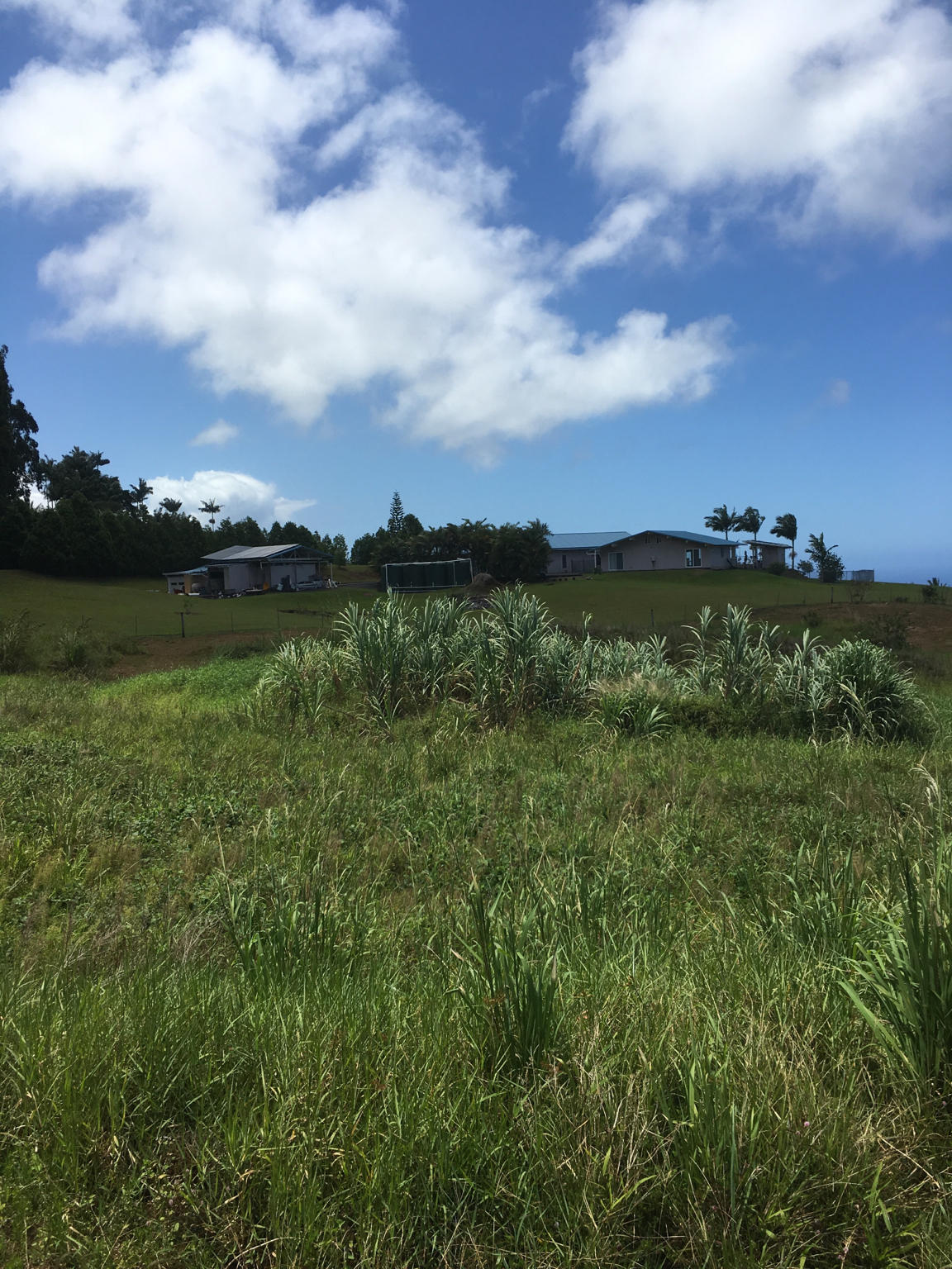

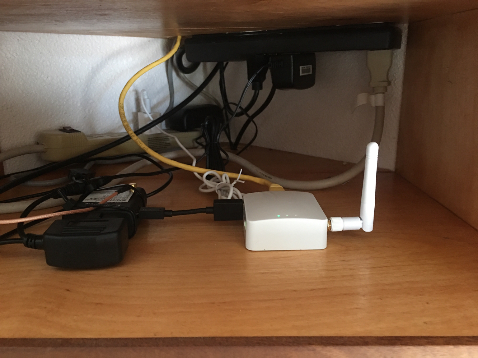

So here I sit in my tractor ready to mow, 4-500ft from my Mobley pulling 10.2mbs dl.
Little GL Ar150 router k
Hooked in then Ethernet to my picostation
Listening to amazon music as I mow
