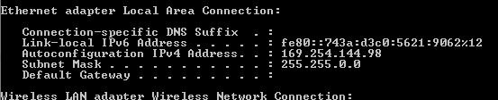

it doens't show up, with an IP tool
my mobley does, our androids do, but that's it.
i have ethernet cable connected to the router in the lan ports..
ipconfig gave me an address but that one wouldn't let me back in either
here is the ipconfig screen,, missing an address under default gateway,

fail
Definitely reset your router to factory. Part of your issue may be that both the router and the Mobley default to 192.168.1.1 (and they cannot share addresses) - first order of business would be to make the router anything BUT that address. In the DNS fields, you do not have to use the Mobley/ATT DNS, you can enter any DNS provider you wish; I tend to use Google (it's faster) and their DNS is 8.8.8.8 and 8.8.4.4
That should at a minimum get your router and Mobley communicating.

ok thanks, rebooted, then did the first 3 screenshots from what website,
how do i know that the router is pulling the signal from the Mobley and not
another (dsl) router in the house?

Kill any extraneous internet sources, routers, access points - eliminate the question

Unless you have another modem (cable, DSL, cell, etc.) hooked to the WAN port of the AC-1900 or you've connected another router via ethernet to the AC-1900 then it is not using any other upstream device as a source. Keep everything else unplugged from the AC-1900 except the Mobley and whatever you want to use as a test client then you know for sure only the Mobley is the Internet source. You certainly don't want to hook this new router to any other router in the house for the use you're targeting.
The Asus/T-Mo AC-1900 does not share the same admin IP. It listens by default on 192.168.29.1. Nothing to change there. Per the thread I linked to earlier for Dutch there are only two things to change in the AC-1900 - APN and DNS servers.
