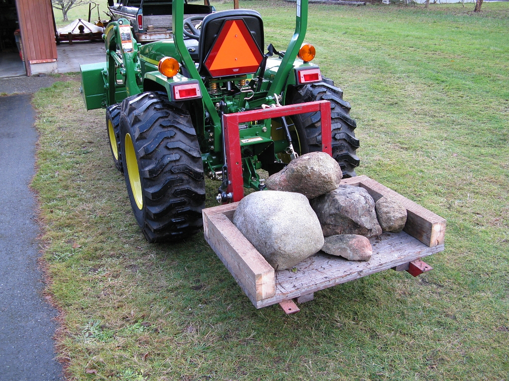

   / CHEAP BALLAST BOX?? #30
Here is a variation on the carry-all style ballast box.
