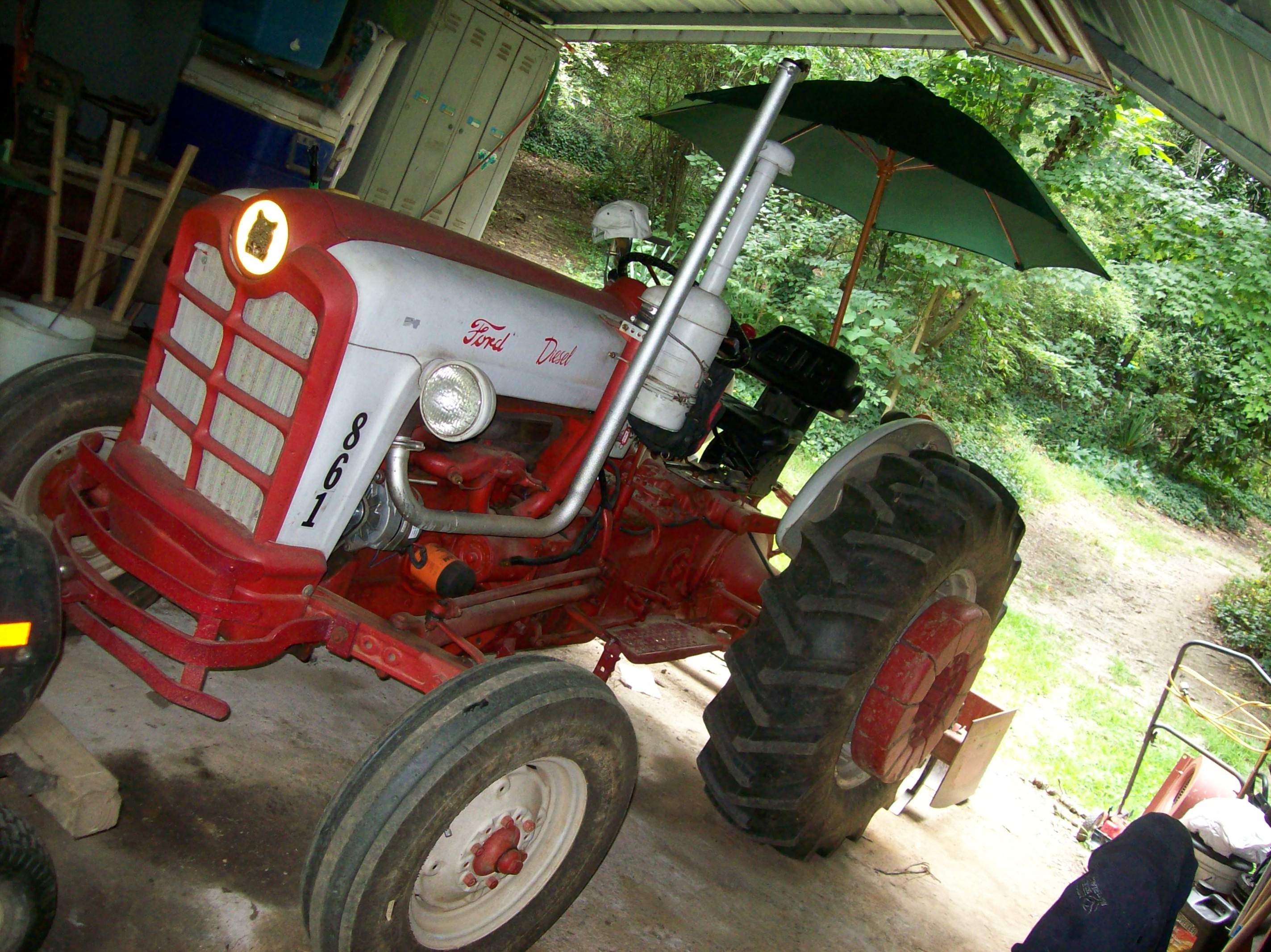

Looks good. Last week the wife gave me a yard sale umbrella she had and said I could attach it to my tractor. Beats a hat and my favorite expenditure; it was free.

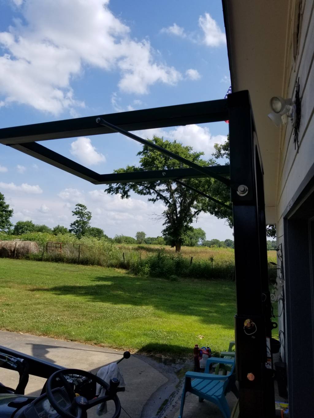

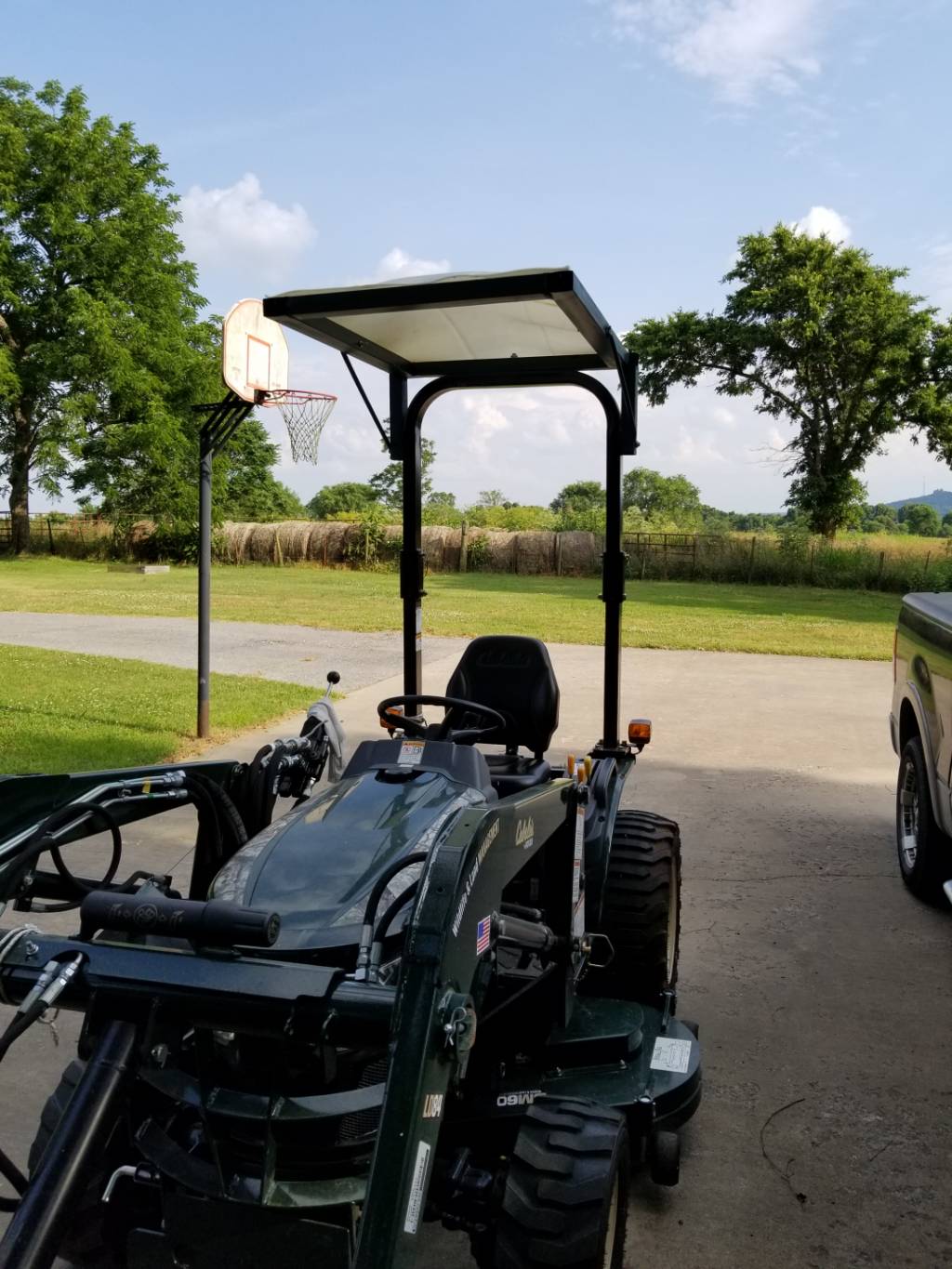

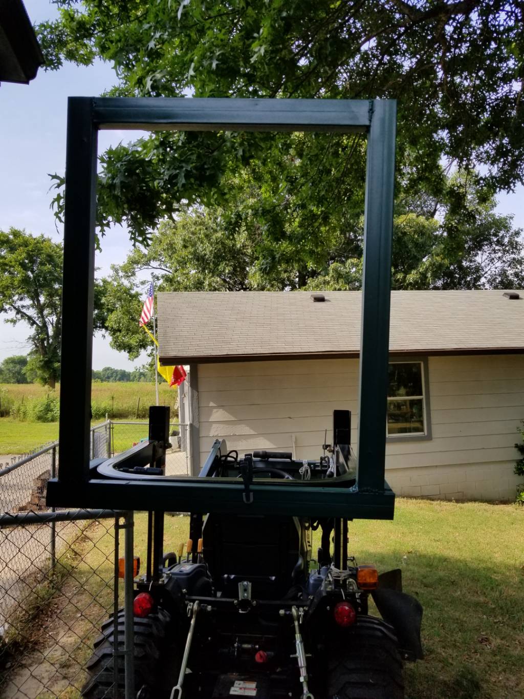

I'm going to tack on to your thread to give you an appreciation for giving me the impetus to build one for my little guy.
I have little extra money right now and went scrounging around the place. Remembered I had some scrap metal tubing that originally was the runners for the shipping crate of my big laser. Cheap Chinese maybe 26 gauge tubing. Probably was a '58 Chevy bumper. I broke it up, cheap tack welds were easy as the freight line had already done a number on one rail.
Sanded off the rust, use some sanding wheels I'd gotten for my hand grinder. Used my fancy HF wire welder,(the cheapest model) to weld it up. Really junky tubing, even this junk welder kept blowing through on low power. But its holding. Scrounged two braces from an old DirecTV dish mount. (Yep, don't throw anything away guys). Drilled through rops on top and either side. Tapped for 3/8" so only through outside. Drilled through hole for top brace, metal tok thin to tap. Painted.
Added a fancy top. Care to guess what I think is?
Scrap plastic drum. Cut up and screwed down with screws. Didn't buy anything I didn't already have.
Zero cost.
Yeah, drum was a few bucks, maybe $6 in bolts and and a couple of bucks in welding wire and $5 for paint. But I didn't go buy anything for this build.
Pictures below.
