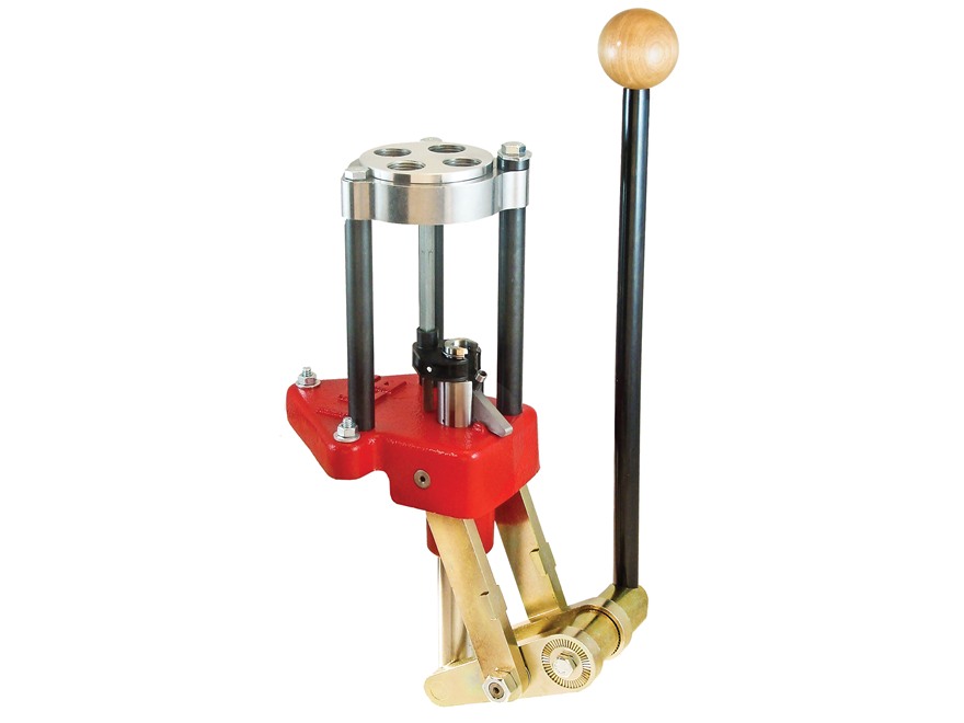

Sorry I'm late to this party, but in my opinion, the Lee Classic Cast turret press is about the best beginner press available for someone who wants to reload both rifle and pistol calibers, and eventually will want to load pistol fast enough to produce a good amount of ammo. The quality is high enough that it is also a long term answer, even as a lifetime purchase.
Forget any negative comments you've ever heard about Lee's equipment. The Classic Cast turret came along at a time when they really started to improve quality. It's a very good piece of equipment. Well designed and well built. DO NOT confuse it with the earlier Lee turret presses, which are made out of cast aluminum. The Classic Cast is linked below. Check out the reviews on MidwayUSA. Near universal praise from many reviewers.
It takes 10 seconds to convert between single stage for rifle (or learning pistol) and auto-indexing for fast production of pistol rounds. Caliber changes take about 30 seconds, if you have spare turrets (less than $15) set up with your other die sets. Produces very good ammo in either single stage or auto-indexing mode. 150 to 200 pistol rounds an hour is realistic, although at the upper end of that rangem it requires a pretty quick pace, maybe faster than some people would be comfortable going.
In my 15 years of reloading, I've had Hornady, RCBS, Forster and Lee presses, single stage, progressives and turrets. About eight years ago, I settled on the Lee Classic Cast turret as the only press I need.
Lee Classic 4 Hole Turret Press - MPN: 964

That unit does look pretty good. And the ability to buy new turrets for just $12 looks good. That way all your dies can stay adjusted in the turret. Almost just like the Dillon tool heads!:). I am sure the production rate would be less than a new Dillon 550C, BUT the price is right, and if it is as well made as you say, it looks like a good value.
