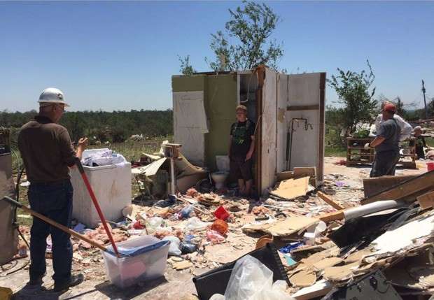

I didn't see this. Was this in Oklahoma? I wonder why those walls left standing remained standing? Could it be the vent pipes in the walls?
Anyone else see this picture this week? That poor kid was home alone and as I recall from the story, he was on the phone with one of his parents, who told him to go to the center of the house to the bathroom with no windows. He lived. Holy cow! Ain't nothing left but two walls and the toilet. Man!

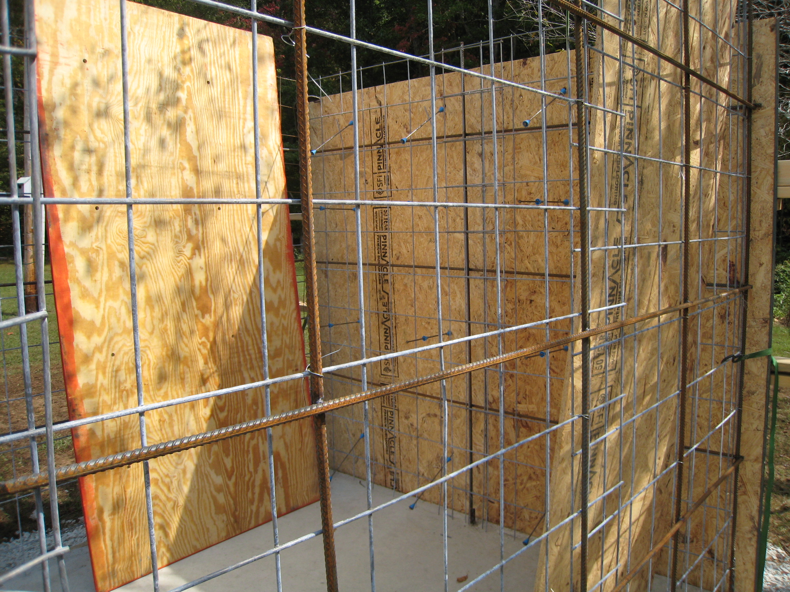

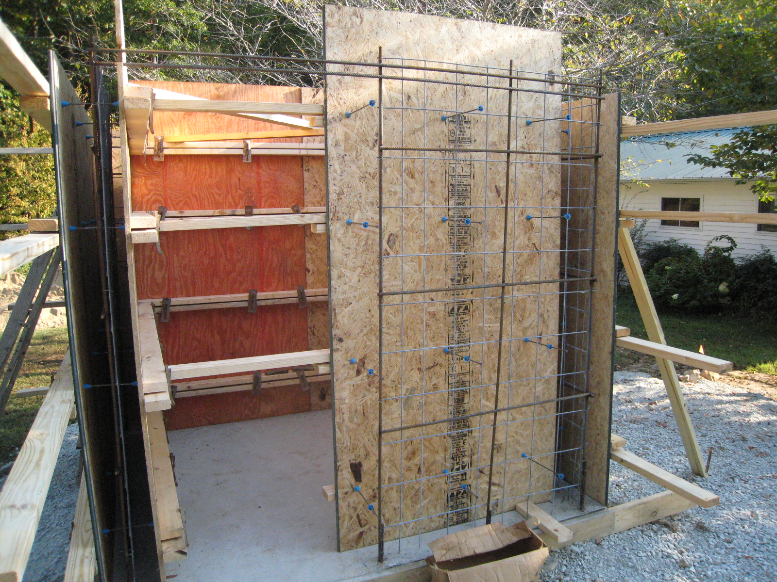

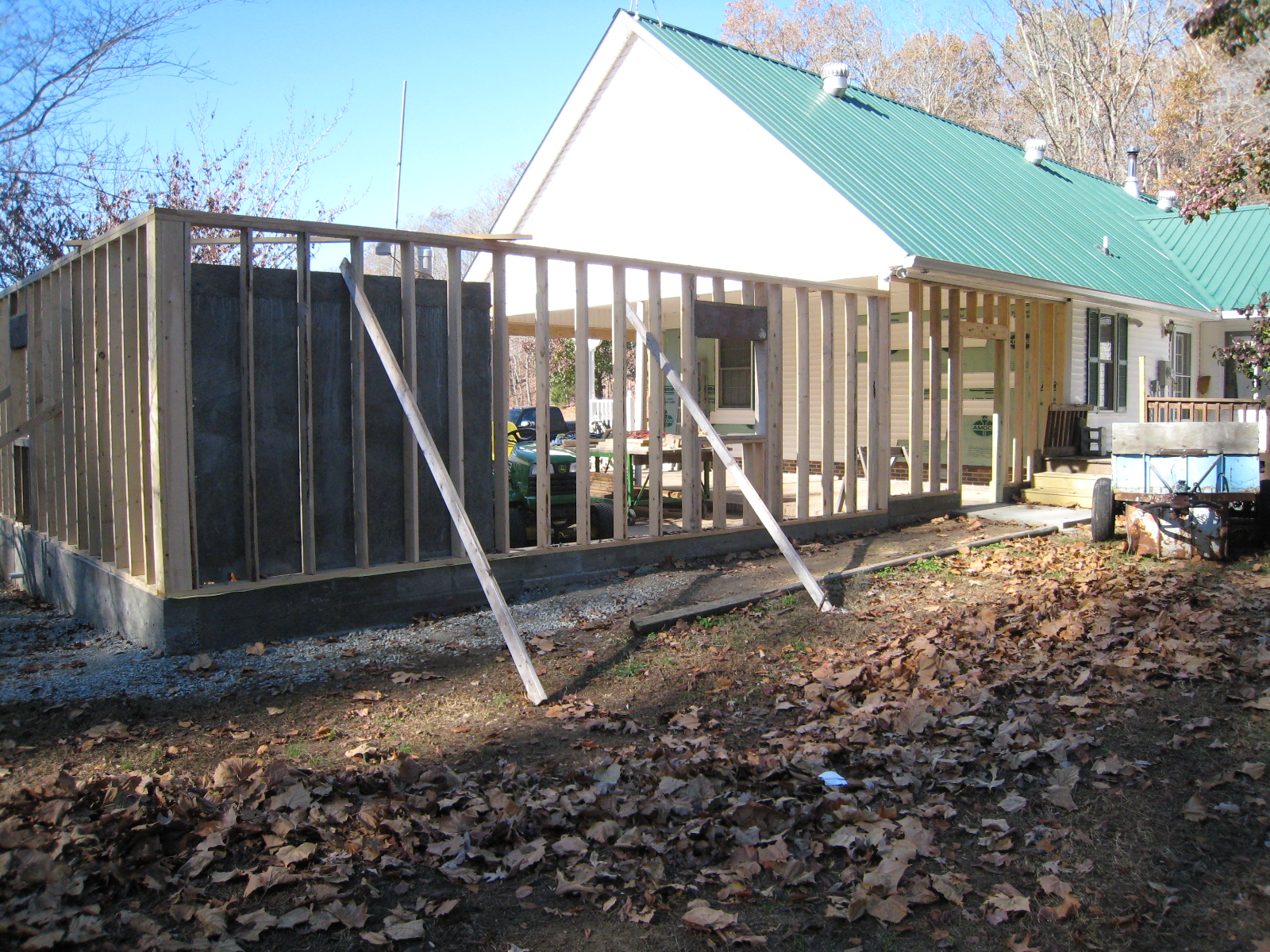

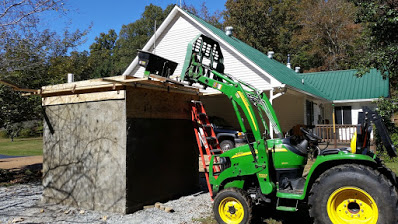

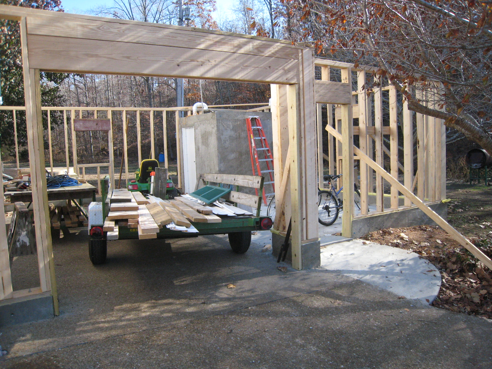

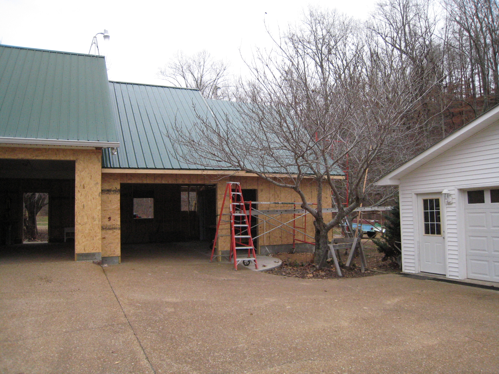

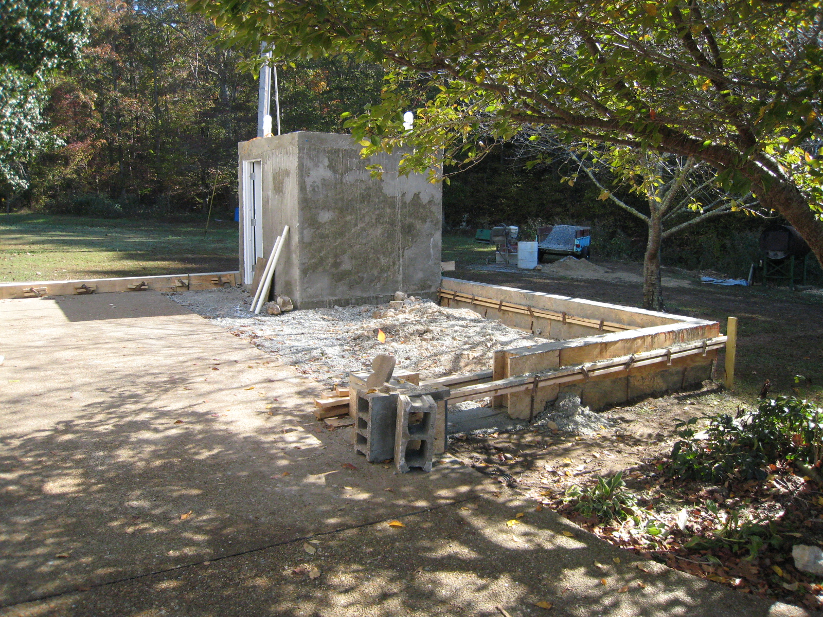

I just wanted to share a few pictures of my storm shelter build by me and my wife in September 2014. We used 8" of concrete in the floor, walls and the ceiling. We used 1/2" rebar in the floor, walls and rood and all welded together, although some say don't weld rebar but to bend it and make an arc to concrete in. That would be to much work for me. I did put pretty heavy cattle panels in the floor, wals and roof also to help hold it together in case of a hellacious wind.
The concrete was stubbed out with 1'/2" rebar in the wall protruding into the footing going around the perimeter.
The door is a commercial door but not one with the 3 bolts for a latching mechanism. I am using an angle iron brace on the inside to keep the door from blowing in.
Inside I have 6'8" wall to wall so I built some angle iron bunks bolted to the walls. The roof is 7' inside dimension and was just right for my tractor to dump concrete into the formed roof. All the concrete was mixed by hand which was a bear but I didn't want any concrete truck squashing my blacktop, plus there wasn't anyway to get concrete to the roof, economically.
We built this and framed the garage around it and it works for us. I know I didn't follow federal guidelines for a commercial shelter like someone posted here, but I am just a handyman trying to scrape by.
Tractor filling SS Roof.jpgIMG_1839.JPGIMG_1841.JPGIMG_1853.JPGIMG_1857.JPGIMG_1866.JPGIMG_1869.JPGIMG_1887.JPG
