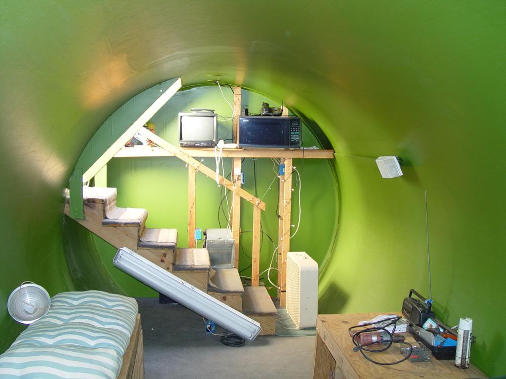

I made a storm shelter from a old steel tank that had not been used for toxic chemicals,
actually I cut the steel tank in half and used it for the top of the shelter/cellar, it was a 10 foot tank, and I layed block wall and filled and reinforced it with rebar and concrete and pulled th tank on top of the stem wall and welded it down to metal top plated I had welded to the rebar in the wall,
In the back wall of the tank there is bolted on plate for an emergency escape.
/ Cheap storm shelter? #10
Storm-Bunker-made-from-fule-tank.jpgIf I was doing it again I would probably just roll the whole tank in the hole and then either fill with some gravel and pour a floor or put in a floor and make lift out sections for storage under the floor,
some thing like the picture,
