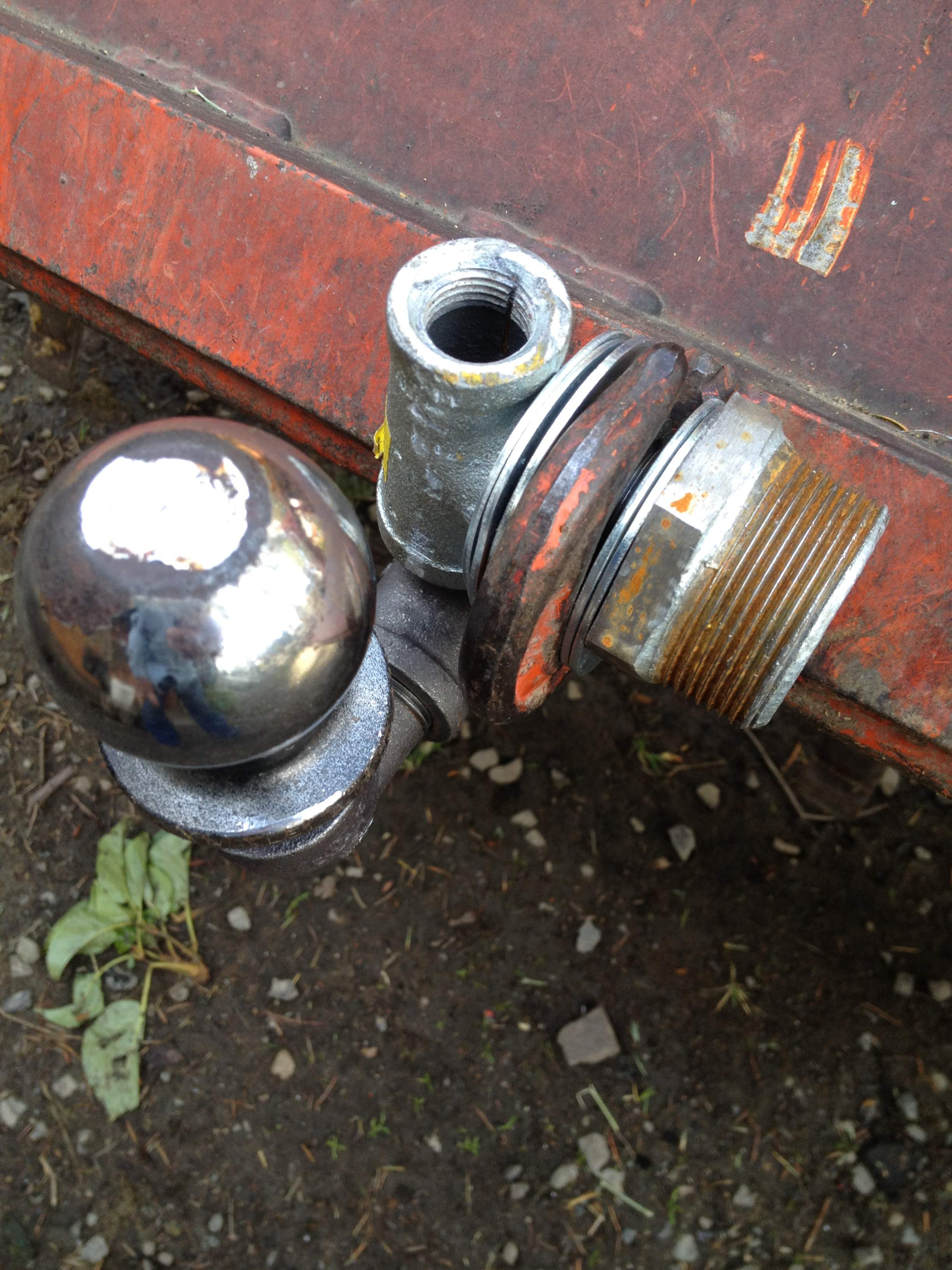

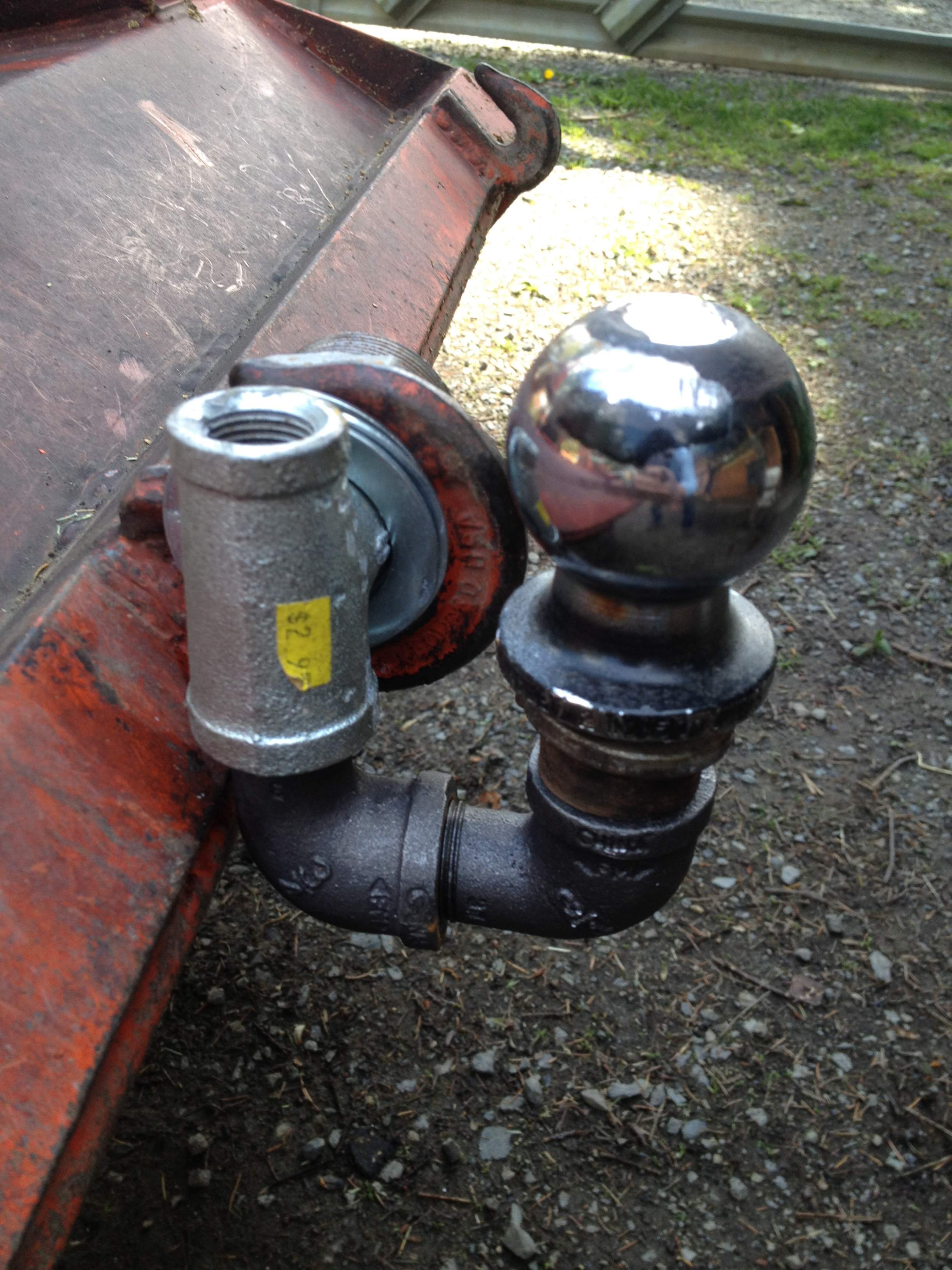

We have some trailers on our property I often need to move around and I kept wanting something I could put on my B7500 quickly to do that. I like using the loader for this - it keeps the trailer in front of me and makes precise maneuvering very easy. I finally ginned something up with some plumbing hardware and a 2" hitch I had around.
The plumbing hardware in the photos is all 3/4". It connects hand-tight to the hook in the middle of the bucket, so it's very fast to put on and requires no tools. Three notes: 1) my trailers top out at 3500 lbs; 2) our land is pretty level; and 3) with this setup I need the trailer tongue up a bit to get the hitch ball under it (especially if I have my toothbar on).

The ball seems close to the hook, does that bind when moving things?

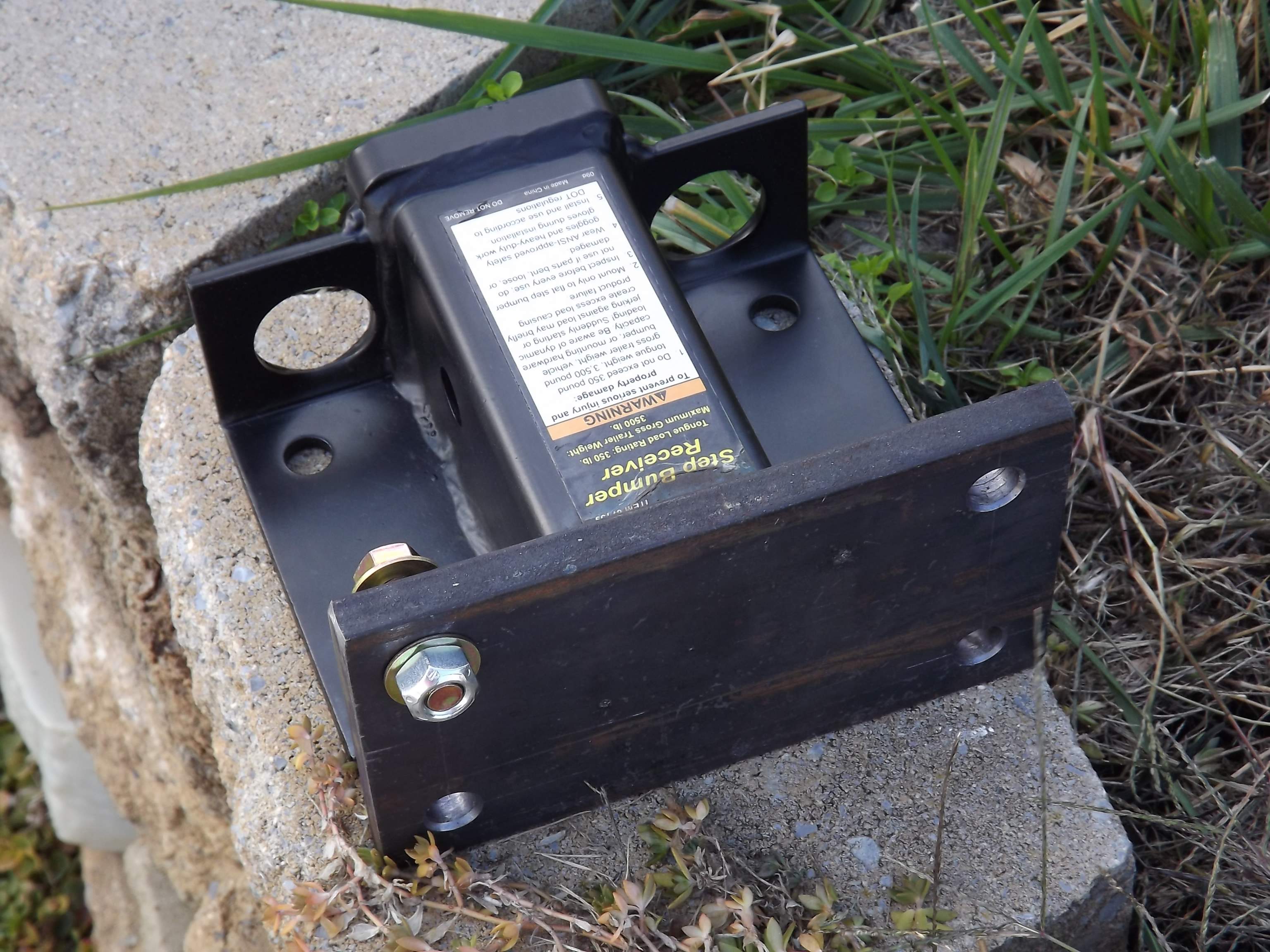

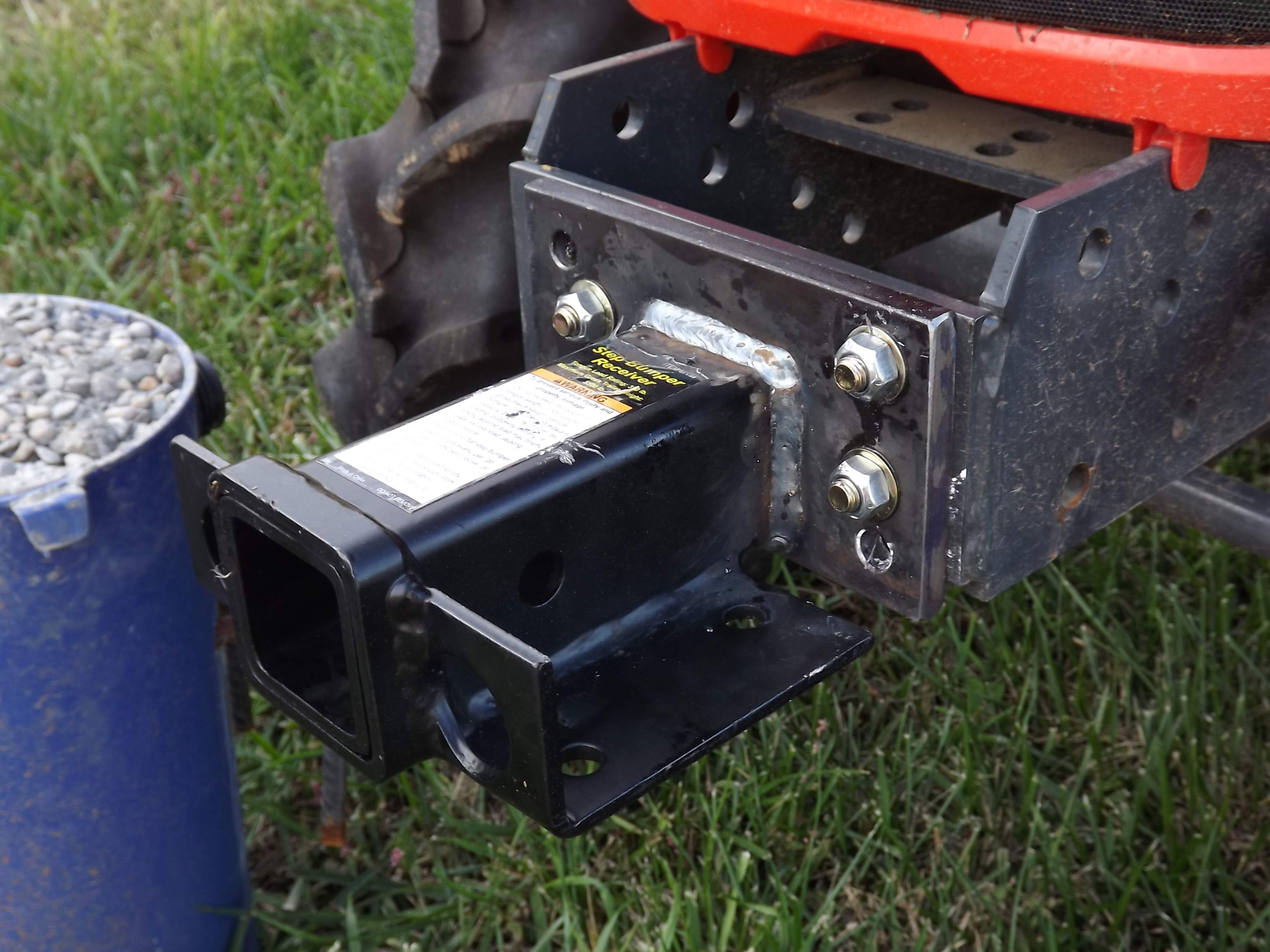

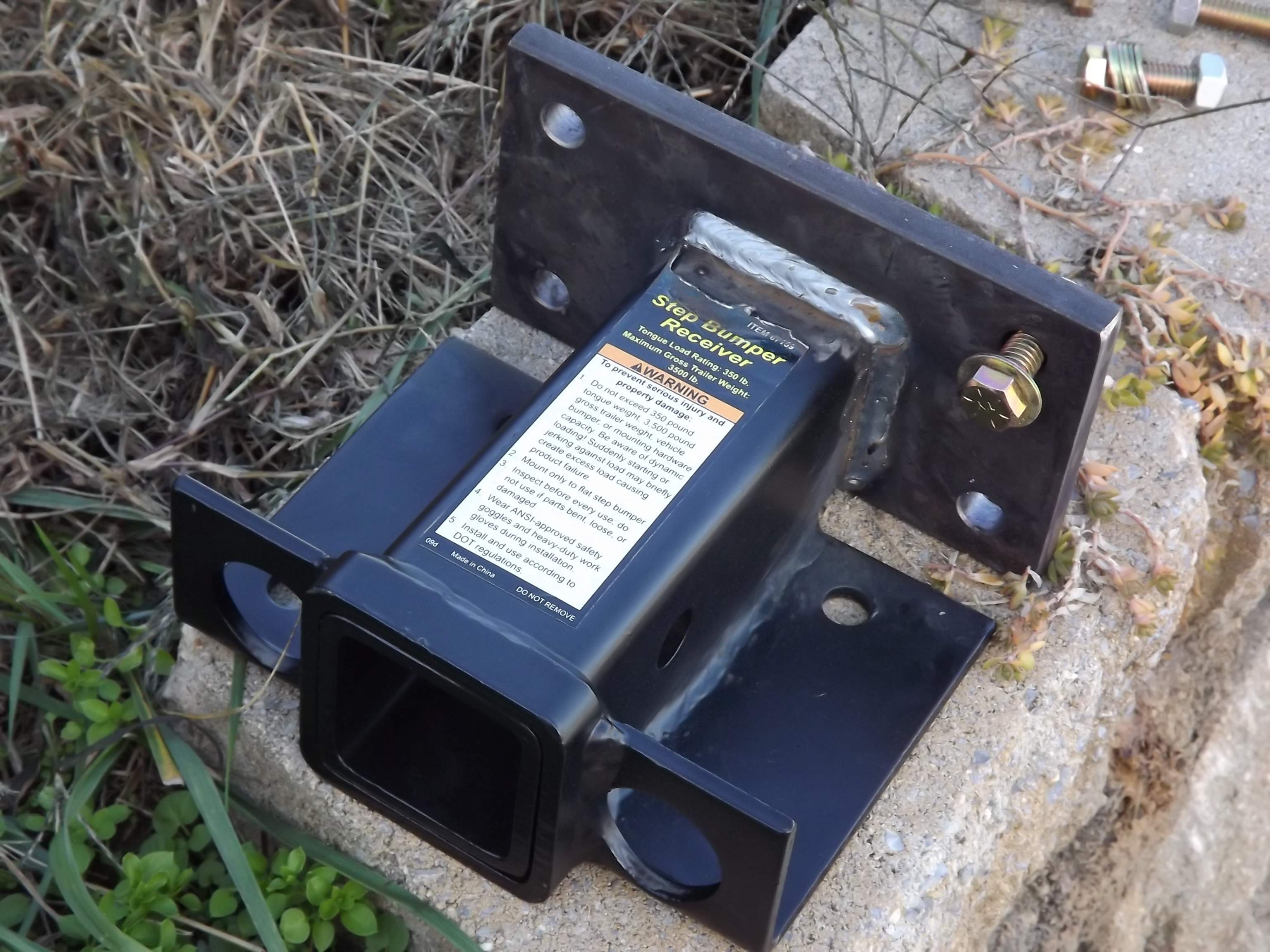

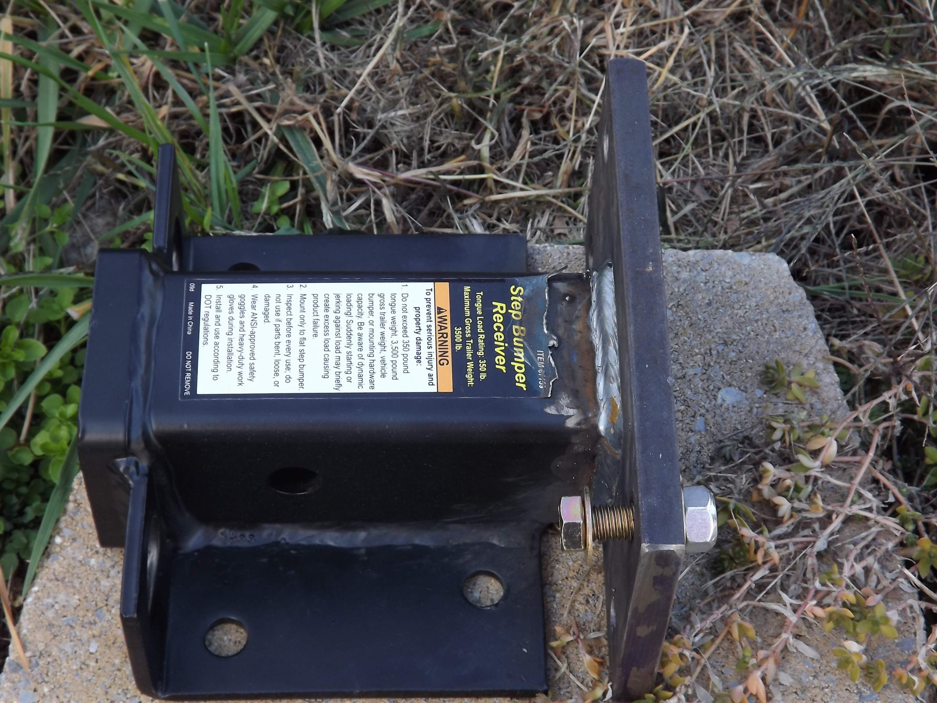

I bought the Reese hitch receiver from Harbour Freight and my Bro in law welded it to the plate which I bolted to the tractor front plate. Two plates with space between them to hook over bucket with a couple of drilled holes in top plate for some clamp type bolt may be an option.
Like this plumbing option. Good thinking.

Nice setup and probalby the best looking weld I've ever seen on this site.

That weld is MIG, hard to screw it up. Once the settings are right, off you go.

Old Blevins.... "Old plumbers never die, they just keep screwing around". :D Some ingenuity there, and will probably do the job for you on level ground what with all those joints that might get unscrewed. Mike
You're right - it is close. But I haven't had it bind. Haven't tried any tight turns with it yet, though. If I find a problem, I'll post back.
Yeah, if we had hilly ground or heavier trailers, I'd have to get a beefier setup.

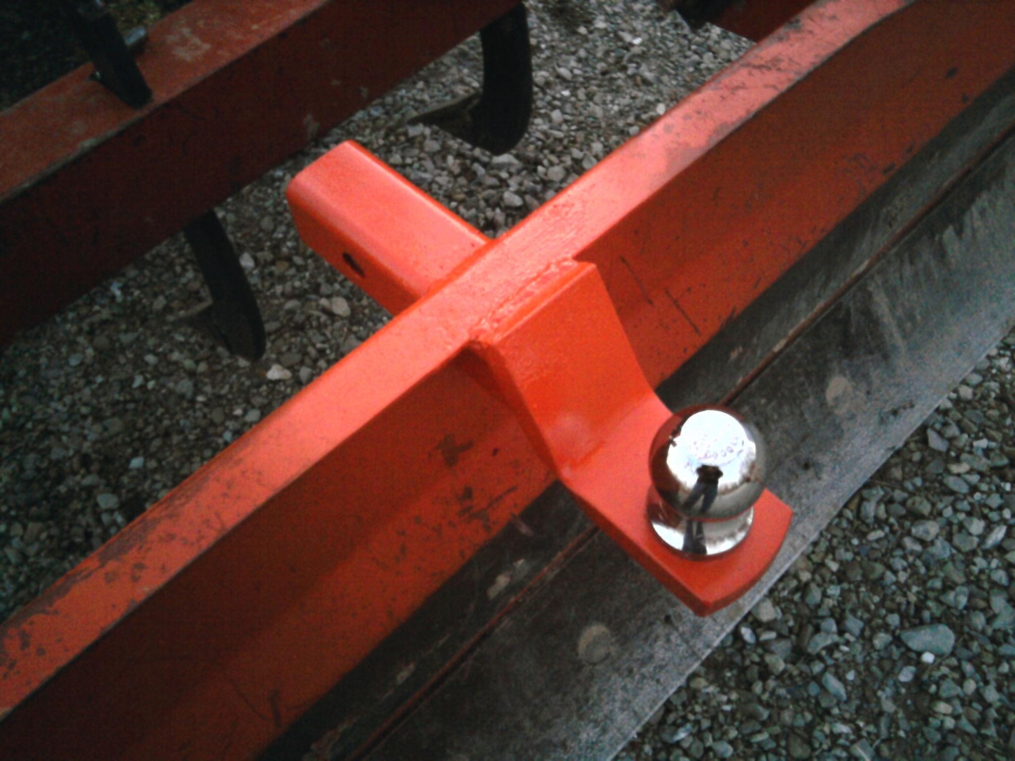

This is what I did with my box blade. I have no problems moving around my trailers and hooking up my chains and pulling logs with it.
