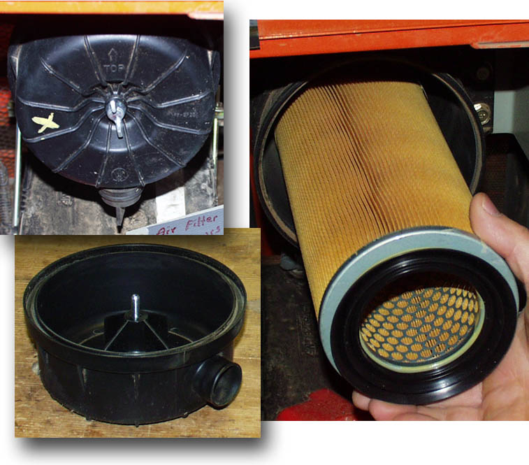

In lieu of that, I dug up some digital picts I took during my last maintenance spree. I was looking to see if your theory about a vented air cleaner lid held any water (just an expression /w3tcompact/icons/wink.gif). Unfortunately, I didn't see anything that supports that idea.
Now, I've been known to miss the obvious before (like what my wife wants for Valentine's day), so I've attached a somewhat hefty picture for your scrutiny. Hard to imagine this is holding anybody's interest at this point, but it's now an Unsolved Mystery. /w3tcompact/icons/smile.gif

I agree, Harv, that picture sure doesn't support my earlier theory. (I quit last night since out here in the country, and with my ISP, you can usually just forget about doing anything on the Internet between 8 p.m. and midnight).
