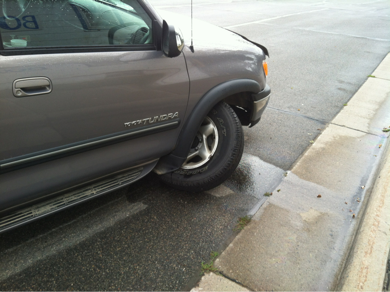

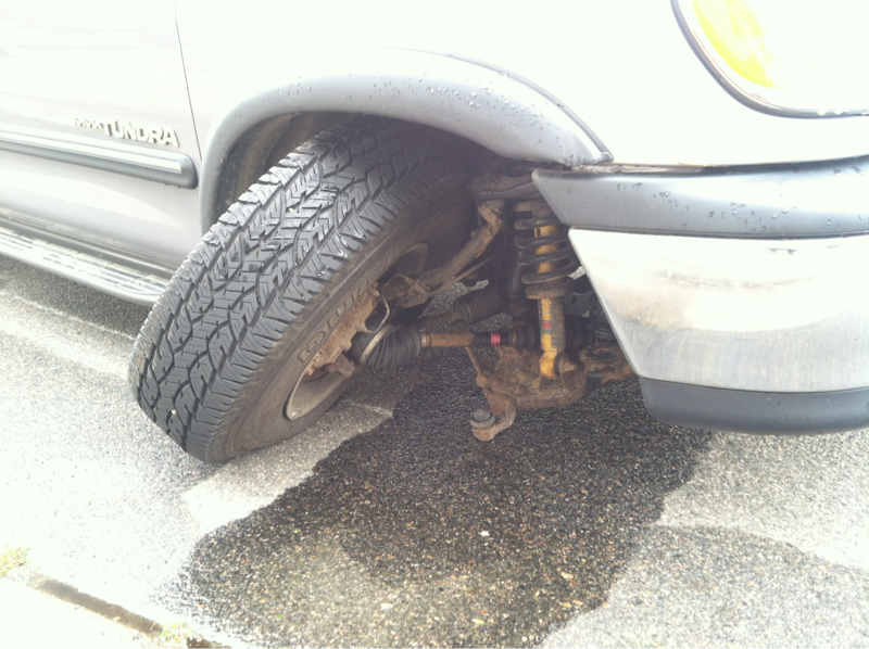

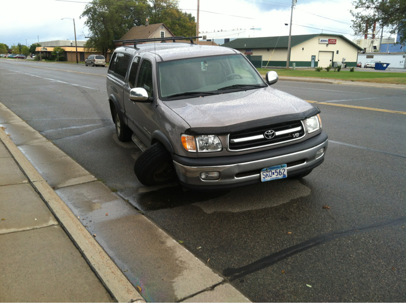

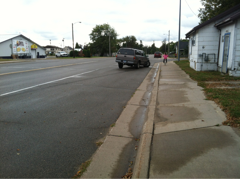

Came across this deserted Toyota Tundra today. Skid mark showed that the right lower ball joint separated on a flat street with a 30 MPH limit. Could have been much worse at highway speeds.
