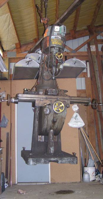

I loaded a small 9" SB lathe onto my small flatbed trailer using a Cherry Picker.
I knew my tractor couldn't handle my milling machine, so I put a chain around a rafter, and lifted it off the trailer with a come-along... mind you, a HEAVY DUTY come-a-long.
And there she sits, right under that rafter.
