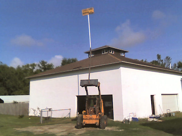

I don't know the lift of your machine but mine will lift 200 pounds 29 feet up easy. see attachment and this is not my actual boom, the NOW boom is much stronger :D

Yes, it's homemade all the way with a 4' main pole with a 3" inside, a little welding and you can be in business. And the best part is.. It's easy and mine will only lift 1,750 pounds

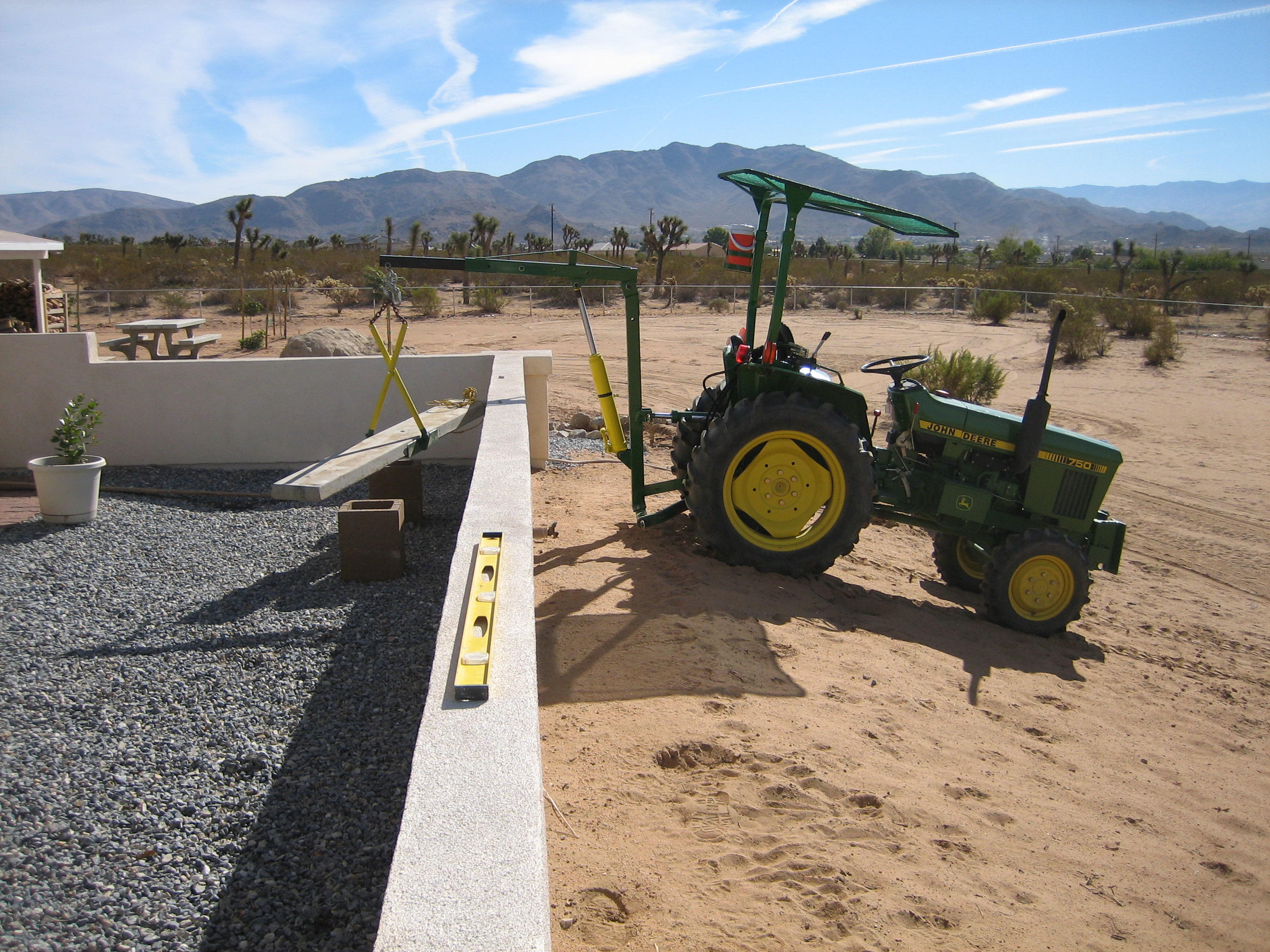

I think this is what you are looking for. Had this 2 ton engine crane not doing any thing so decided to make use of it. All it took was to weld on hookup for top link (I have T&T), take it off of the crane base and bolt it onto a draw bar and away you go. If you want to get fancy then you can paint it your tractor color. ;) The T&T gives it more reach flexibility and the tilt gives you fine side to side adjustment. Now if you hook up hydraulic from tractor to crane cylinder that would be real sweet.:D

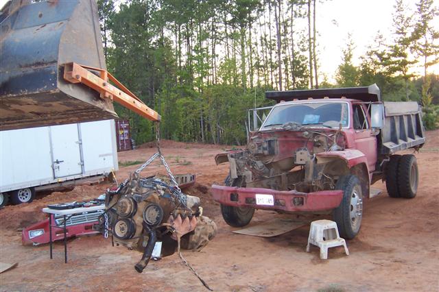

I took the bar off my cherry picker and bolted it through some holes I drilled into the side of my FEL. I don't think the holes cause any strength issues, but that's just a guess on my part.
I've lifted engines this way and carried them to my shop across rough ground, so do know it works very well.
The best part is that it only takes a few minutes to install or remove.
