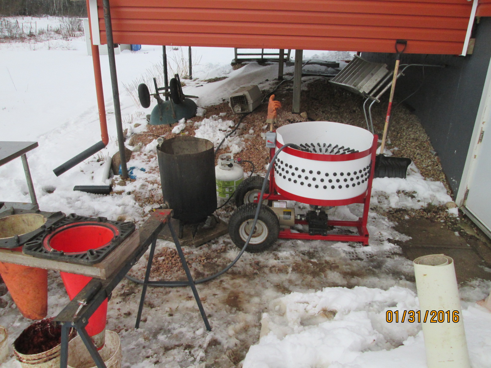

On my 3rd chicken plucker build . The last 2 have been a Whiz bang plucker style . This one is larger with a 30 " spinning plucker plate for doing turkeys better.
So my question is plucker picking plate should spin at 172 RPM and with a 1725 RPM motor to a 10:1 gear reducer the math adds up. But this seems to spin very fast !!.
My question is with this set up will a plucker plate that is 10" 20" or 30 all spin at 172 RPM at the outside edge?? Or does some how as diameter increase so does the speed?

The outside of the plate spins at the same speed as the inside.
A larger plate will have more torque, but also require more power from a motor to get it started, and over come the additional load you could potentially put on it compared to a smaller plate.

Although the RPM's are a constant, the SURFACE SPEED gets faster the farther you go out. Think of a merry go round and trying to run to stay in the same spot. Toward the inside near the axis, you can do it by a fast walk. Go to the outer edge and you will be in a full out run.
   / Chicken plucker biuld
Ok . Thats where I get confused . You say the surface speed increases . Do I want to slow the rpm down to control the surface speed to an acceptable speed?
   / Chicken plucker biuld #6
Yes. Have you thought about making the speed adjustable? Several ways you can do it depending on your budget.

My first looked like yours only was painted.

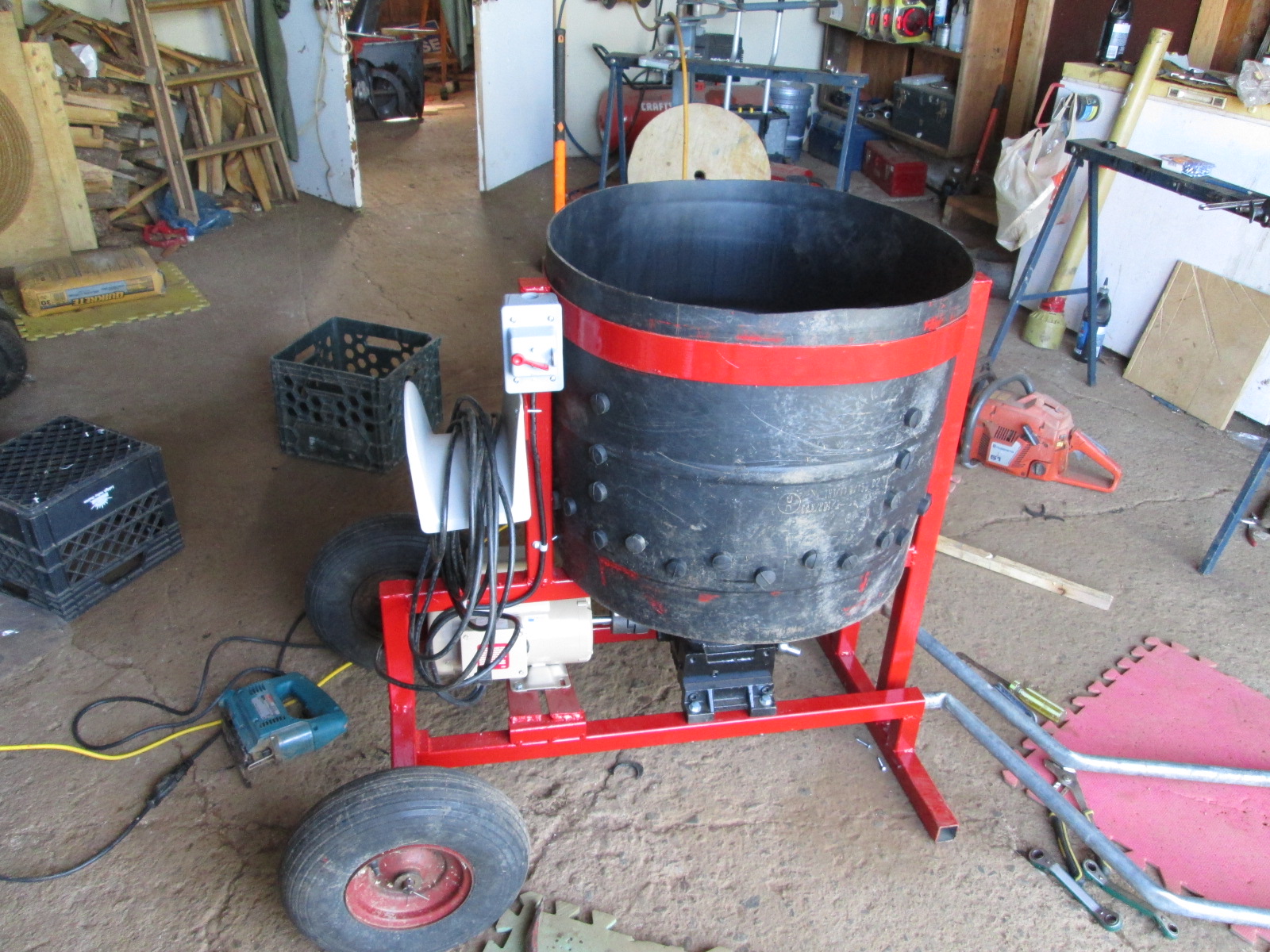

This was my second. 22.5 tub
And this is my third 30" puck board tub Solid 1/8 steel bottom with ring attached. 3/16 aluminum picker plate Over 200 fingers.
Popped the breaker several times yesterday as the feathers are getting caught in the shoot and slowing the plate when the feathers jam between the plate the tub wall.
The feather momentum is so fast that the from the wall of the house to the plucker was covered

Some rough calculations:
A 30" feather plate has a circumference (pi times diameter) of 94.2 inches
At 172 rpm the rim is traveling at 22.5 feet per second or 15MPH. 172x94= 16168 inches per minute. 16168/12=1347 feet per minute. 1347/60=22.5 FPS or 15MPH (all numbers rounded)
Using the same numbers for a 24" plate gives about 12.25MPH
To get the same rim speed from a 30" plate as you get from a 24" plate, you'd need a shaft RPM of about 138.
On a 1725 motor that'd be a reduction of 12.5 to 1.

Could you please post some photos of the plate inside the drum and maybe some info on where you got your gear reduction from? :)
IMG_1184.JPGIMG_1185.JPG Princess Auto in Canada. This reduction system is great as it comes apart to move the I/P and O/P shafts from top to bottom or left and right depending on direction and how its going to be mounted. The plate is 3/16 The 3/4 shaft is welded to a 1/4 x 3 x 6 plate and bolted to the plate. The extra 4 holes were drilled with a hole saw and are slightly big to hold the fingers.
I will get some electrical box knock outs and plug them.

No belts on this one Direct drive gear reduction.
