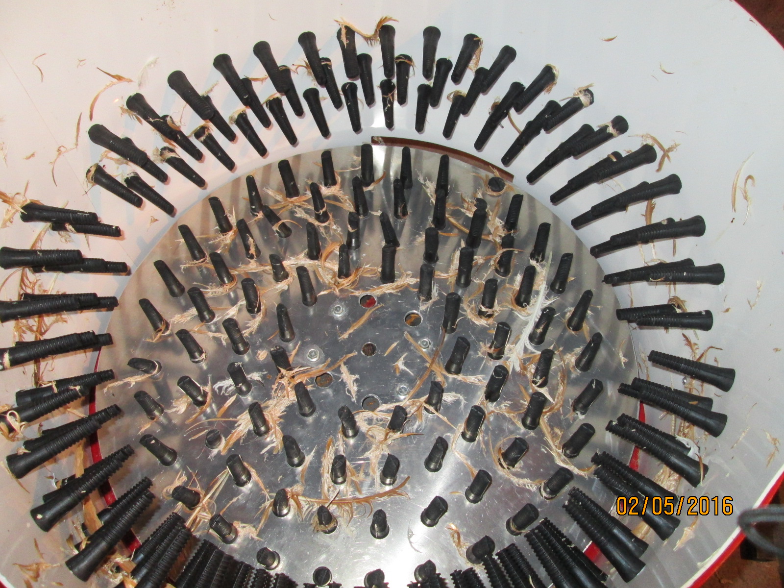

I laughed at the concept myself, initially.
The way our chicken processing system is set up (~ 60 birds per year for the freezer) is that my wife is Chief Plucker.
She's 72 and standing up while hand plucking 60 birds is no longer an option. Too hard on her feet and back, and WAY too hard on her arthritic hands. We even gave up raising our own birds as I just couldn't bring myself to spend the money on a power plucker nor did I really believe they worked as advertised.
One winter of eating store-bought pigeo...er, I mean "chickens"... was enough to illustrate just what a bad idea that was.
So I broke down and built a whizbang.
Is it perfect? Nope.
Is it faster? Without a doubt.
Is it better? Close call, but it enabled us to continue to raise our own birds for a few more years, so worth every dime IMHO.

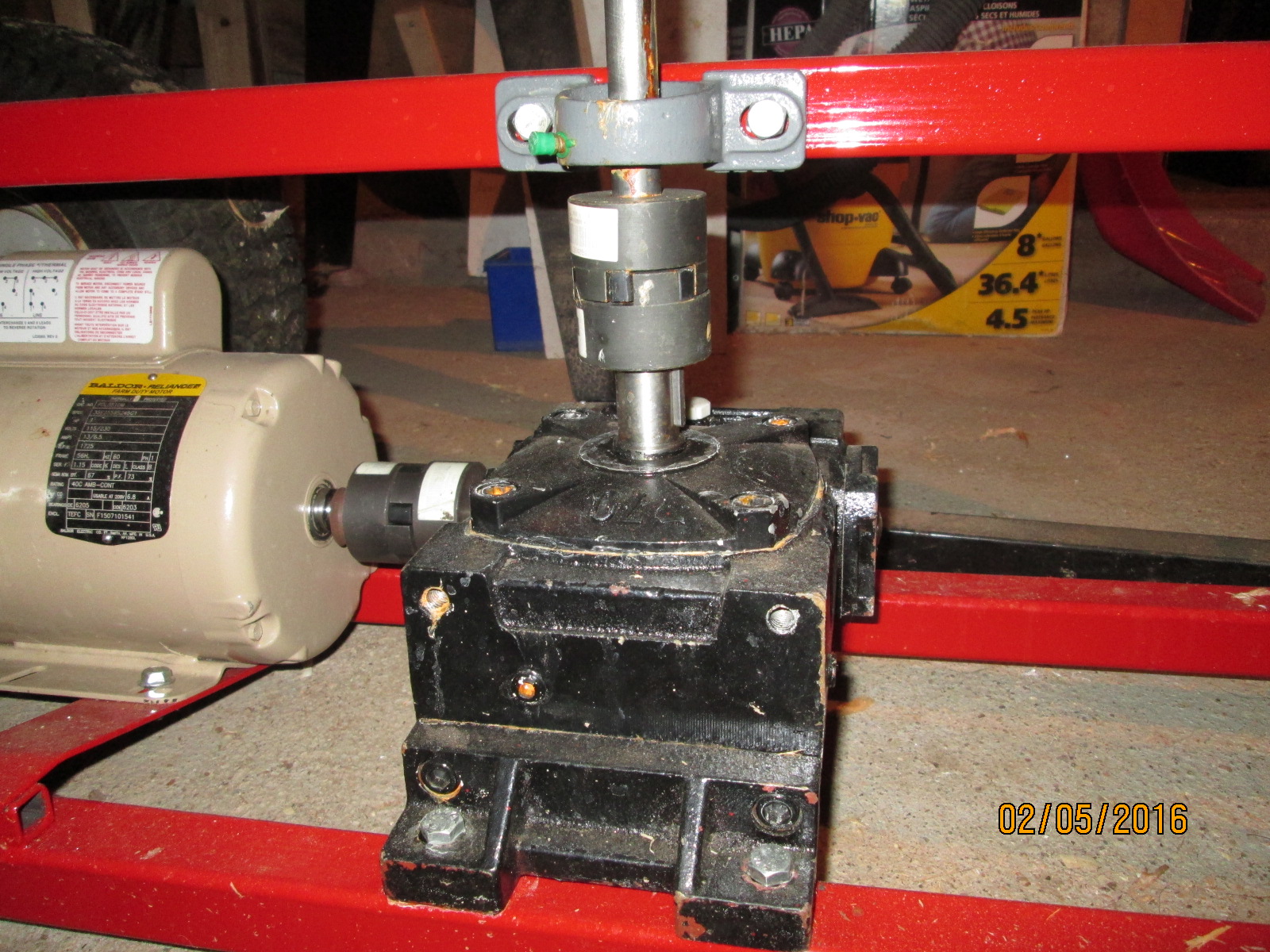

I haven't read the whole thread and maybe it's been suggested already. What about a 10:1 reduction gear box driven with a 1hp 3phase motor controlled with a VFD? Look here, they have hundreds of gear boxes that sell cheap. Use their search function and just type "gear box"

Some rough calculations:
A 30" feather plate has a circumference (pi times diameter) of 94.2 inches
At 172 rpm the rim is traveling at 22.5 feet per second or 15MPH. 172x94= 16168 inches per minute. 16168/12=1347 feet per minute. 1347/60=22.5 FPS or 15MPH (all numbers rounded)
Using the same numbers for a 24" plate gives about 12.25MPH
To get the same rim speed from a 30" plate as you get from a 24" plate, you'd need a shaft RPM of about 138.
On a 1725 motor that'd be a reduction of 12.5 to 1.
Based on one season's experience with my home-built Whizbang, I need to slow my feather plate down too.
