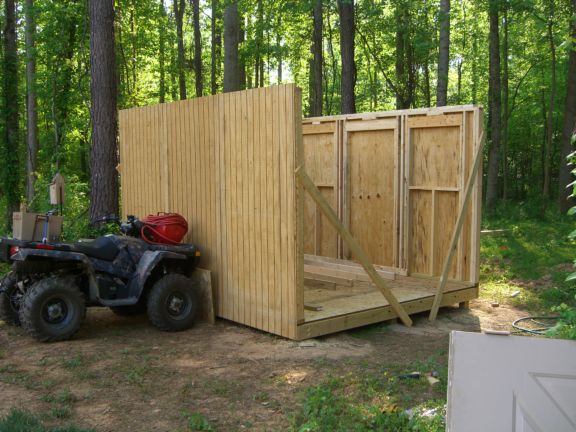

Well, its been a while since updating this thread with my coop progress. Not because I haven't been working on it, its just that the work has been in small increments and I didn't stop to take pictures.
My last photo showed the floor structure complete. Since then, I framed and added the exterior sheathing to the front and back walls. I had to wait for some help to raise the walls as they were too heavy for my wife and me to do. Today, I was able to have a couple of friends come over to lend a hand (and strong backs). As my help didn't arrive until after 5 PM, my goal for the day was simply to get the front and back wall raised.
Here's what that looked like:
   / Chickens, and things related #443
As you can see, the siding has not been cut out for the windows and doors yet.
Well, once we had the walls up and braced, my buds suggested we start framing the side walls. I didn't want to take advantage of them.....but I did anyway.:D

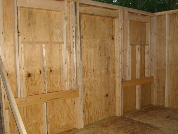

   / Chickens, and things related #444
So, we framed one end wall and one of the guys suggested I go fire up the grill. Actually, I had already had my wife do that so he then suggested I go start cooking. Well, I didn't want to take advantage of their generosity by leaving them to continue doing the hard labor while I go do something easy like flip burgers......but I did anyway.
While I'm grillin', they hang the exterior sheathing on the end wall and clean up the work site.
Here's the interior as it appears now.

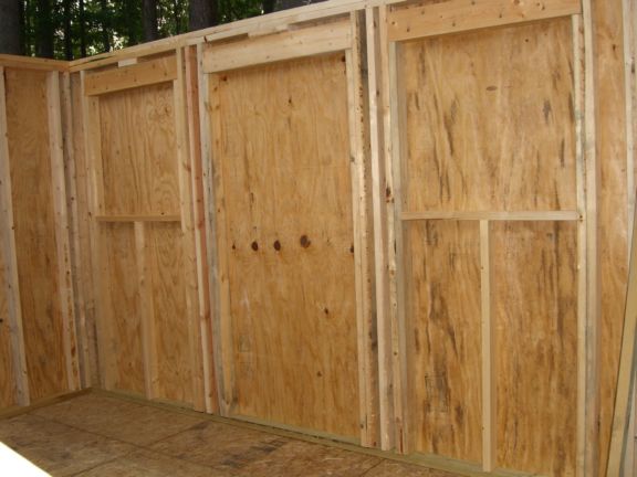

   / Chickens, and things related #446
And, finally, the rear wall. Again, there is framing for a door and 2 windows. To the left of the man door will be a cut-out for the chicken door, but its not framed out yet.
The final wall will contain the nest boxes. As I am still working on them, I couldn't take any more advantage of my friends today by having them frame up the last wall. But, there's always next weekend.
