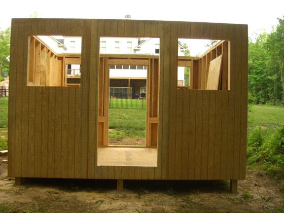

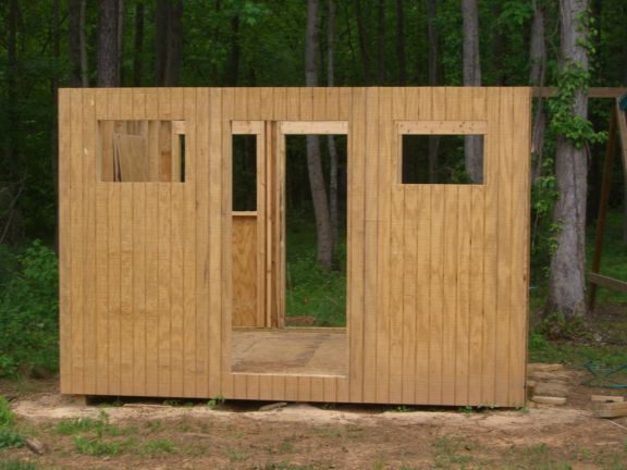

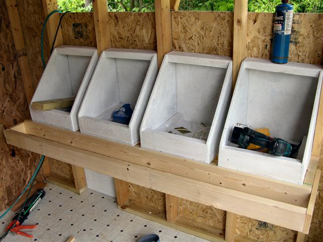

Here's a few more photos of my coop / shed.

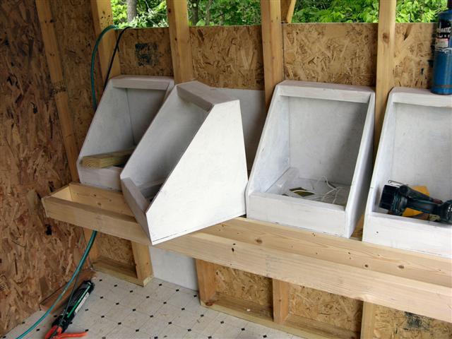

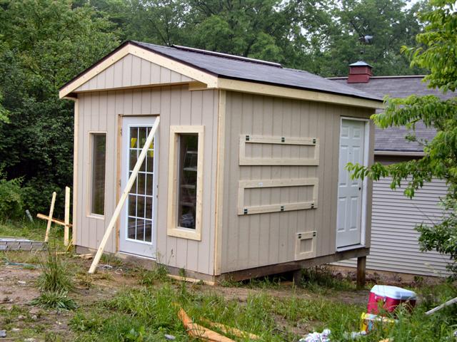

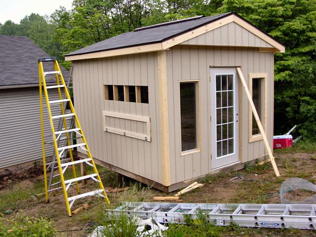

Last Friday, I built the nest boxes. Saturday, I framed most of the 4th (and final) wall. Weather came in late afternoon, so I had to put things up before I was finished. I completed the framing on Sunday, but could not set the wall. I did the construction right outside my basement shop so I need some help to relocate it to the coop. I had no volunteer help on Sunday so the wall didn't get moved. I did cut out the exterior sheathing from the doors and windows and put in the final 4 lag screws holding the rim joists to the 4x4 support posts.

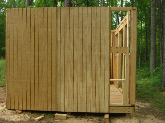

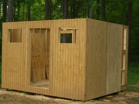

   / Chickens, and things related #467
Monday evening after work, I grabbed wife and son to help me move the 4th wall. We set it in place and I then squared, plumbed and nailed it in place. I also got 2 pieces of the exterior sheathing hung. My help had long since disappeared so hanging the sheathing by myself required a little creativity, some clamps and a lot of luck.

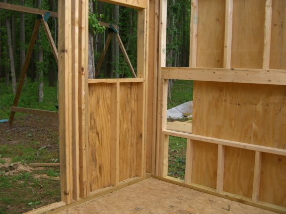

   / Chickens, and things related #468
You can see from the last pics that I still have a half sheet of siding to install.

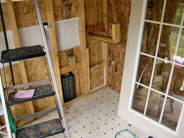

From the inside, you can see the long rectangular area below the header. My nest boxes will slide in this opening, which is why I needed to complete the nest boxes before I could frame this wall. With this design (borrowed from a coop plan I found on the internet), we will be able to gather eggs from from outside the coop as the nest boxes will have a hinged lid on the exterior portion. I'll install the nest boxes after the roof goes on.
