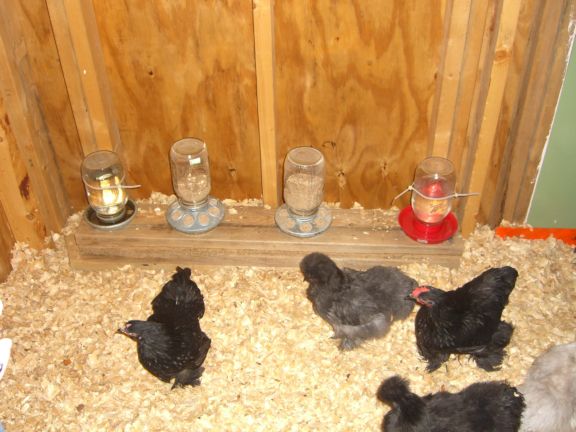

The birds getting settled in.

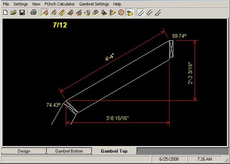

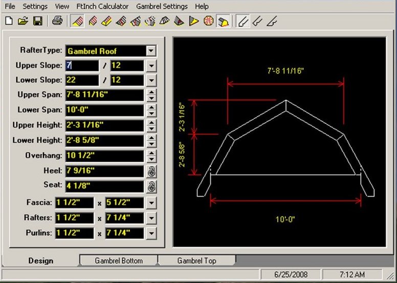

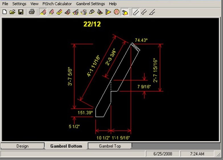

Guys maybe you could help me out here a bit. I'm also in the process of building a little coop (10 X 12) and want a Gambrel roof. Using the measurments that are supplied on these pictures should 2 X 4s or 2 X 6s be used for construction of the rafters and how would you recommend spacing of such for our Ohio snow loads?
BTW: This is a really great thread for all things related to chickens. I came in late and have been reading the thread for more than a couple of days.
Thanks to Tororider for bringing it to my attention.
