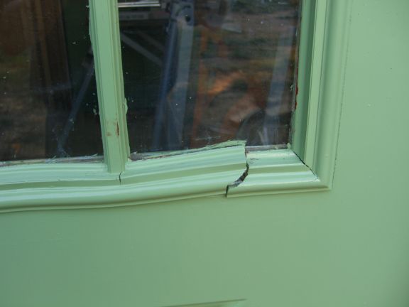

Finally (for tonight), you folks may remember that I bought my windows and doors from a salvage yard. $5.00 for each window and $20.00 fro the doors. So, its easy to accept the blemishes and irregularities with these prices.
The front door is steel and has plastic moulding around the windows. I'm attaching a photo that shows the damage to the plastic trim.
I was wondering if anyone has an idea of how to fix this plastic molding. I'm thinking that maybe a heat gun will soften it enough for me to bend it back into position and then fill the seam with epoxy. Should this work or is there a better idea?

Eddie will probably know the best way to fix, but the heat gun sounds like a decent idea to me. The only thing I would worry about is cracking it more. Could you just seal the crack with some type of caulk and call it a day? Or remove the whole piece and replace it?

If the heat gun is not a good idea - I'll just caulk it and admire the character it adds. Don't think I want to get into replacing it. Wouldn't even know where to begin doing that.

For a $20 door, there's not much that you can do for it that wouldn't cost more then buying a new door. If I was to do anything, it would be to fil the crack with some paintable caulking and cut off some of the sharp edges.
I don't have any confidence that heating it up will accomplish anything. Cutting it off and replacing it will work, but you'll probably have to use wood to get a good match. Even then, it will take hours to cut, sand, feather and blend it all together. A new door is allot cheaper.
Or you can cut it down to size and fill in the rest with bondo. Again, lots of sanding and feathering, but in time, it can be made to look perfect. Buying a new door would be allot faster and cheaper.
Call it character and move on to instalilng the AC units for the birds. :)

I need to insulate before installing the AC. I guess I better move on to installing the toilet and shower.:D
Thanks for the counsel, Eddie.
