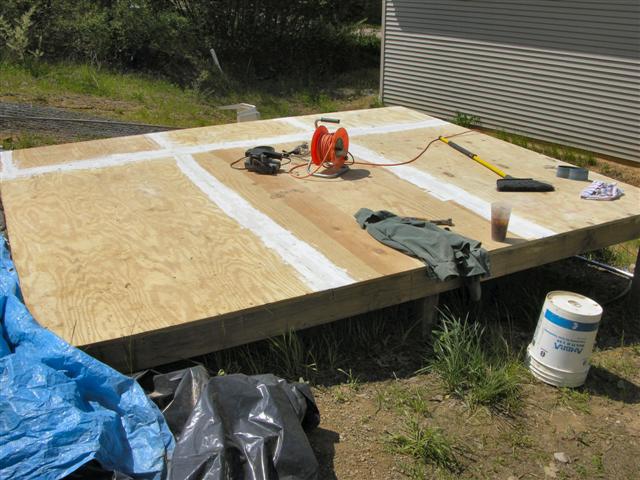

Yesterday it rained plus we were fortunate enough to see HIGH winds so no work was able to be done on the coop.
This morning I helped a neighbor wire a foam marker on his New Holland that we put together for his boom sprayer.
Then the sun popped out so I got back to work on the coop. I used a leveler to fill small imperfections at the seams in the flooring. I wanted things somewhat smooth before we put the sheet vinyl down. Once the leveler is completely dry I'll start spreading the adhesive.

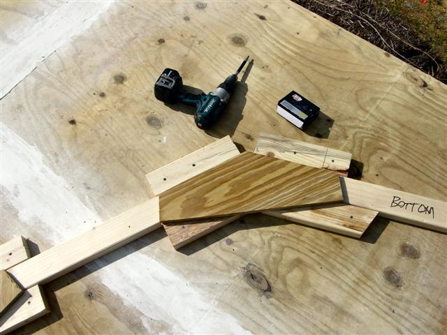

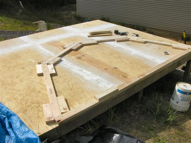

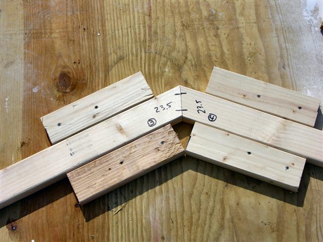

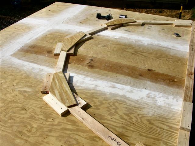

We want to use a gambrel roof style and I was a bit concerned about getting all the truss to be the same with all the cuts and all.
Everything that I have read says to use stakes in the ground to hold the various lumber pieces so that it all comes together the same. Yeah like thats gonna be real accurate.
I thought if I only had a piece of plywood large enough small pieces of 2 X 4 could be used as a template to hold the lumber together for accurate gluing and nailing of the gussets.
Then the light-bulb lighted in my head, hey what about the floor of the shed/coop....... So I took all the template pieces that I had cut and fastened them to the plywood in a way that further pieces could easily be placed in the jig and each truss duplicated with a bit more accuracy.
I'll see how it all works out and let you all know but it looks good so far.

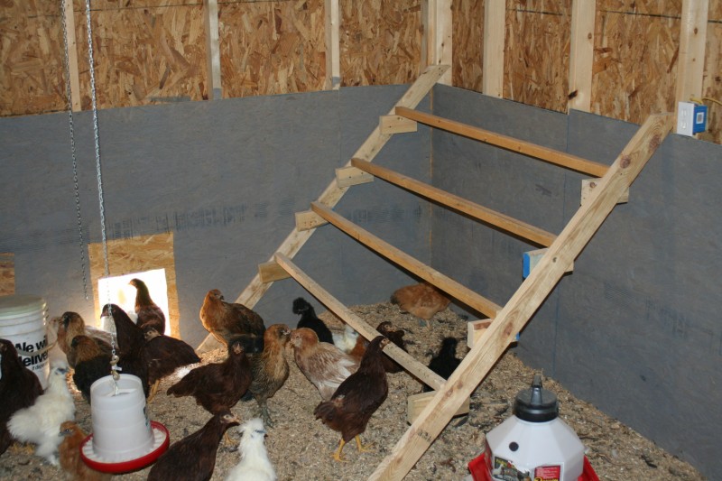

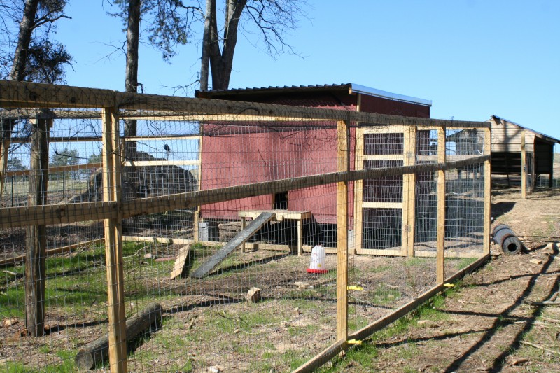

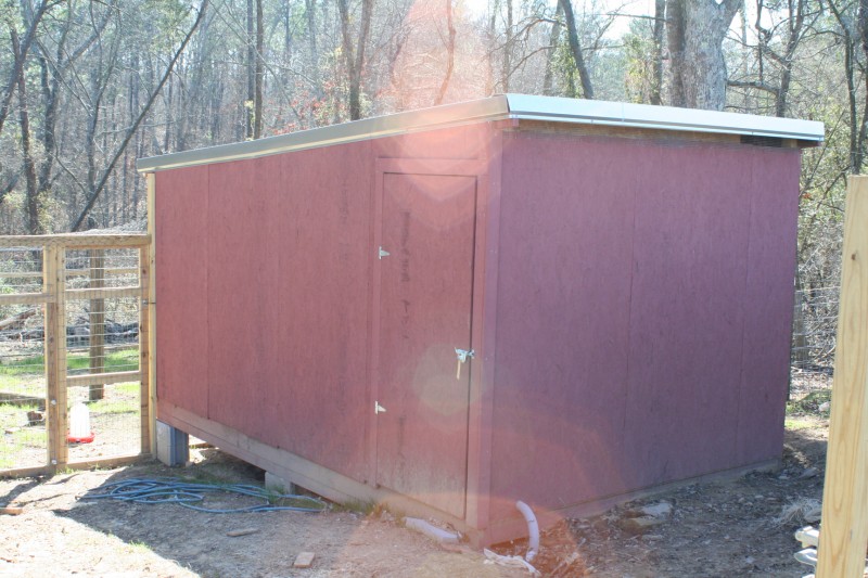

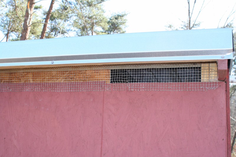

My coup is 10x16. I have a total of 25 chickens. 8 Rhode Island Reds, 8 Aracaunas (Easter Eggers), and 9 silkies (3 black, 3 white, 3 buff). In the silkies I ended up with 3 roosters (1 black and 2 white). The Rhode Island Reds and Aracaunas are all pullets.

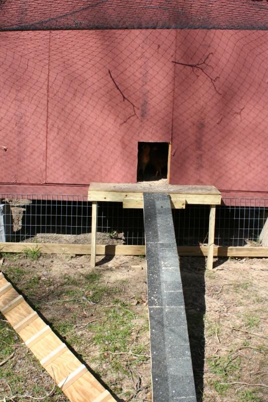

My run is 24'x40'x6' tall made out of pressure treated 2x4's. I covered the top of the run with a 25x50 piece of aviary netting that I bought online.
The Rhode Island Reds and Aracaunas started to lay at about 21 weeks. We are now getting 12-14 eggs a day from them. The silkies haven't started to lay yet.

Nice set up. Do you need that large of coop for 25 birds? Also, have you had any issues with your fencing? We do not have many mink or weasles around, but i have trapped a few. I think they might be able to get through that fence?
Thanks for posting the pictures!

No need for heat if they are adult birds. I did buy a waterer that is heated Heated Poultry Waterer - Premier1Supplies . It's well worth the money. If you look closely you can see it in the background of the Rhode Island red picture.
My coup has OSB on the interior and exterior walls. I painted the exterior with Barn paint, but am going to have to go back and put either Hardy siding or Pine siding over the OSB this summer.
I also, have a 14 watt CFL on a timer that comes on at 6 AM and off at 8 PM year round. That gives them enough light to stimulate laying in the winter time.
