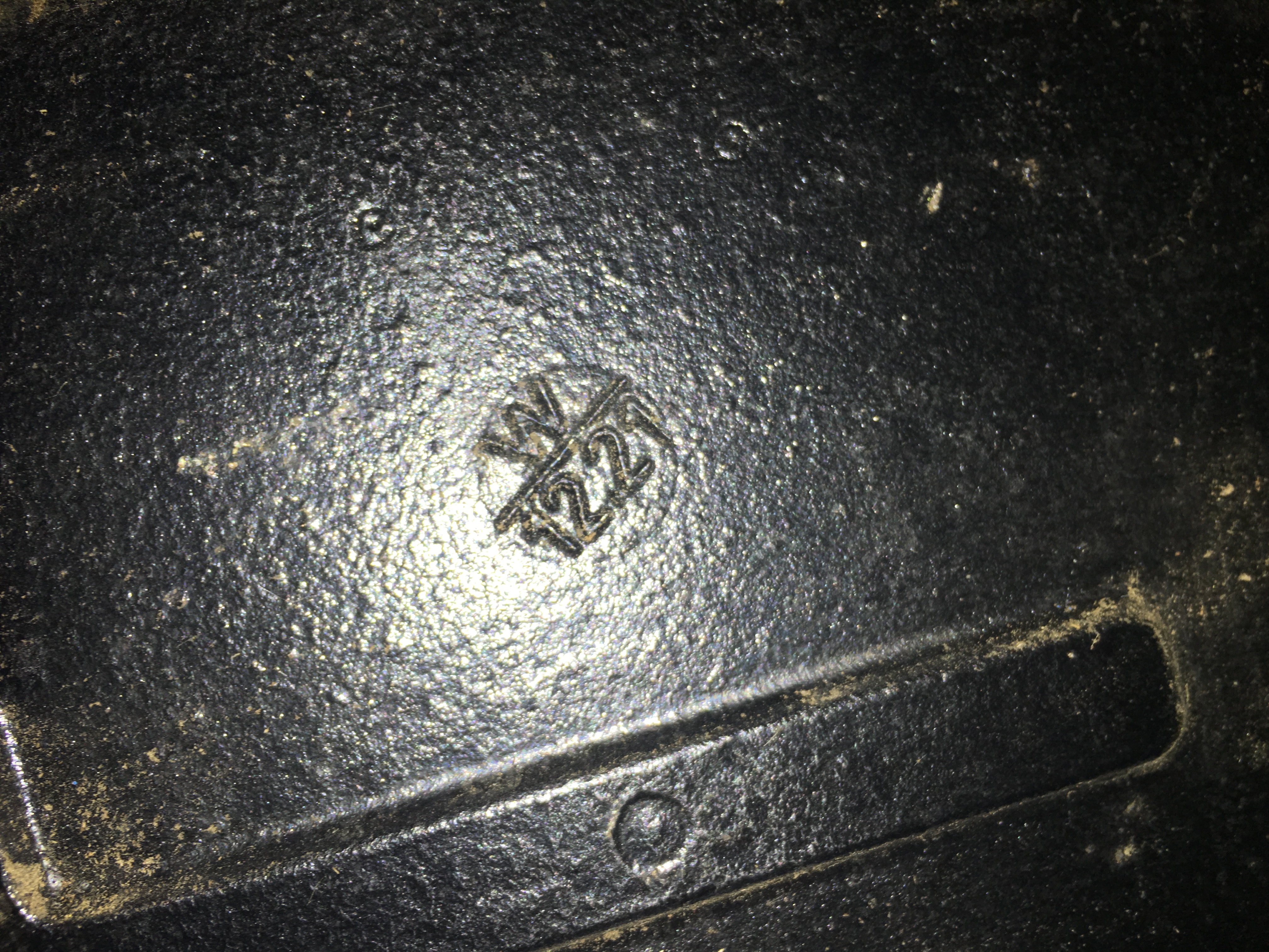

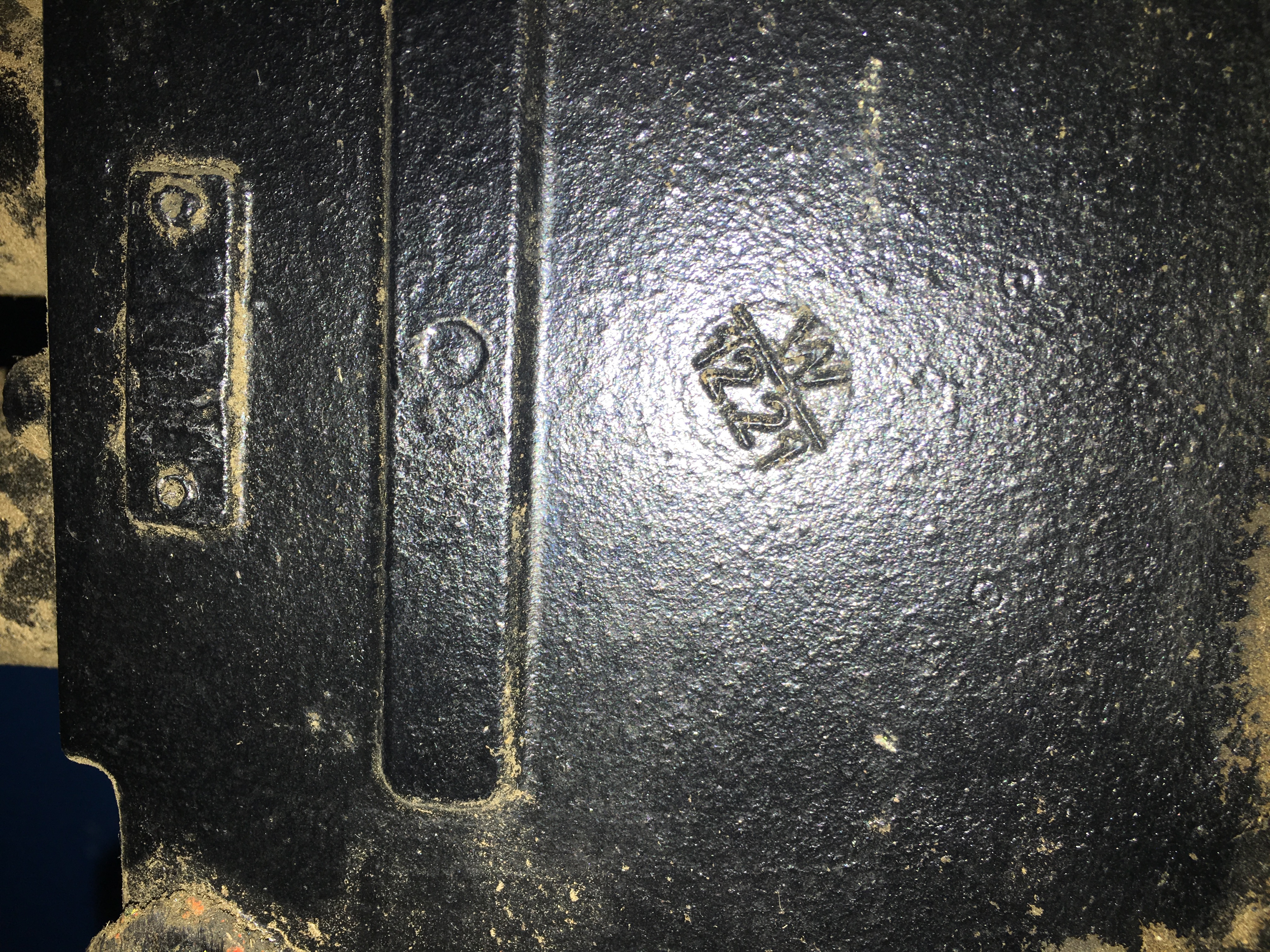

teg, you are right its plenty confusing to me. anyone know what make that loader valve is. only thing I could see on the valve is what's in the above pictures
