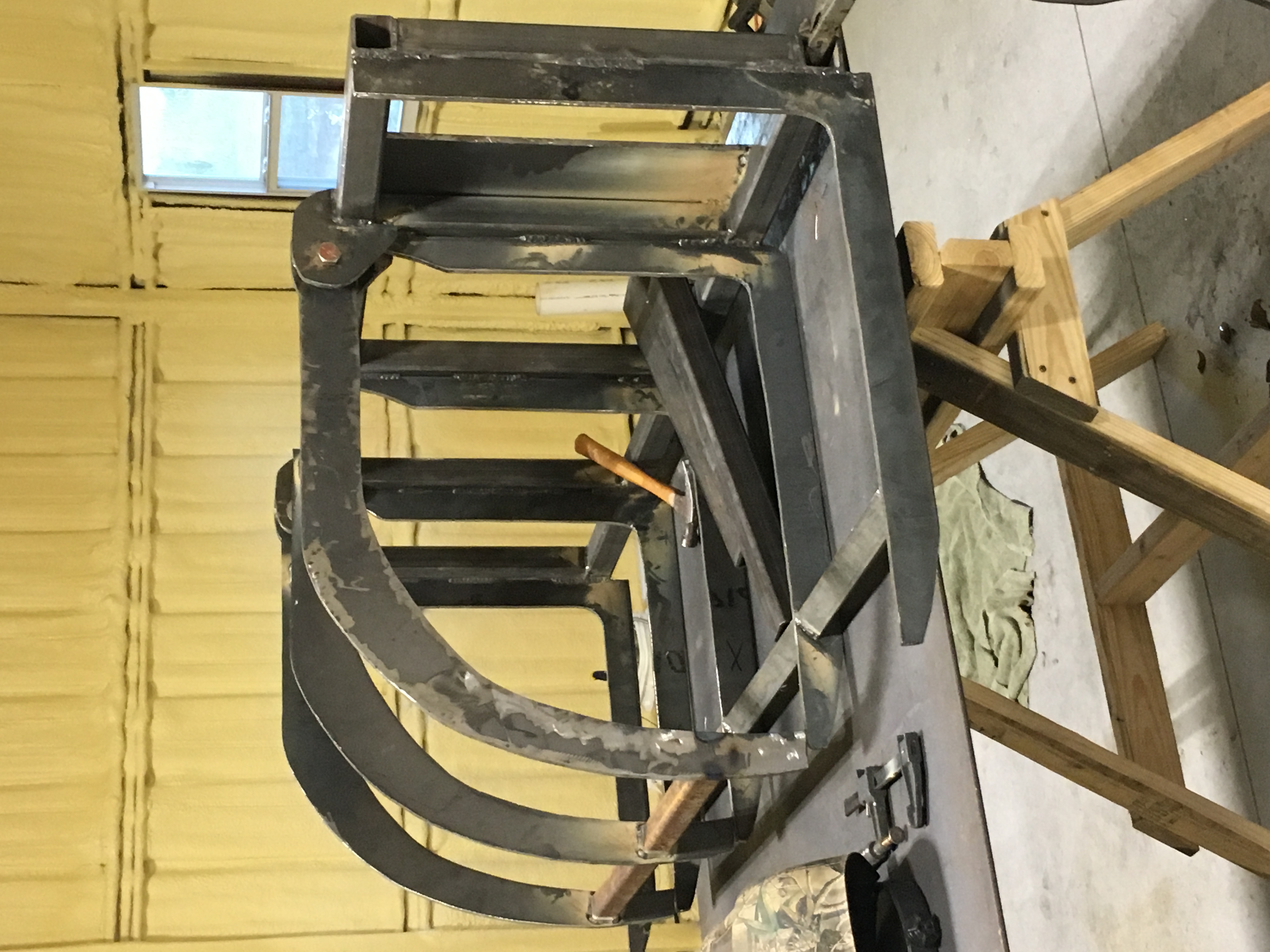

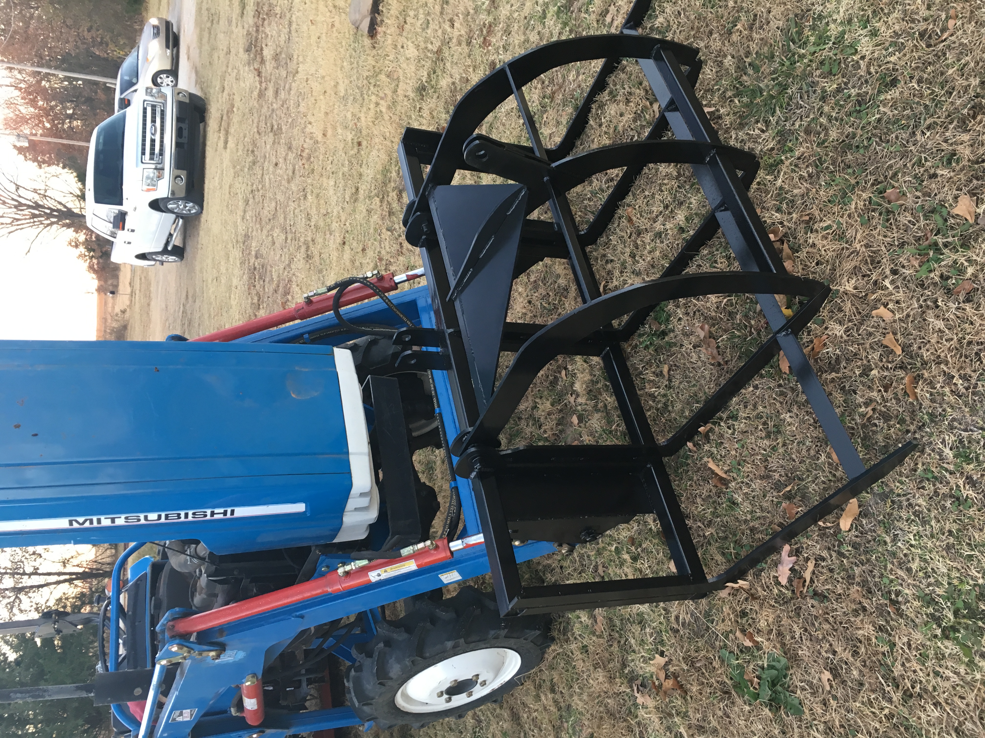

Just thought I would send a few pictures of my brush grapple.
