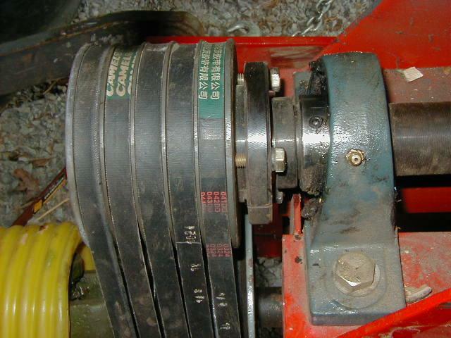

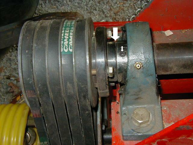

While we're at it I have a new problem that developed. The top pulley shaft holding the main drive belts is slipping out. I have attached a picture to show it. The picture attached shows everything as it should be. The big arrow shows the point of separation. The little arrow shows one of two set screws. I don't know if these set screws have anything to do with my problem. I tried turning the set screws either in or out and they won't budge. Tomorrow I am borrowing a set of hex keys that go on a ratchet. Either way I'm not sure if they're involved.
Does anyone have any ideas or experience with this? The next post shows the shaft starting to separate after only about 20 seconds of operation and the lowest throttle setting.

This photo shows the shaft as it is beginning to slip out.

Tony,
Had the same thing happen to my chipper. Turns out that the key was missing and the little bit of slippage caused the pulley to slip off the shaft. I took the pulley off the shaft, installed a key, and reassembled. I have about 20 hours on the chipper since the fix without any new issues.
The allen screws had nothing to do with my problem. They are there to hold the shaft into the bearings.
Mike
   / Chinese Chipper Review #168
Thanks for the reply, Mike. At least I'm not alone! What holds that pulley in place...just friction?
   / Chinese Chipper Review #169
Tony,
There is an inner sleeve and an outer pulley. They both have a reverse pitch so that it tightens down on the shaft when you tighten the three bolts on the back of the pulley. This friction is only meant to hold the pulley horizontally on the shaft. The key is what keeps the pulley from rotating on the shaft. You can look between the shaft and the pulley to see if you have a key in place. If you do, then you have a different problem.
To remove the pulley, you have to remove the belts, take out the three bolts, thread them into the three additional holes on the back of the pulley. By tightening the bolts, you push the outer pulley off of the inner sleeve.
Mike
