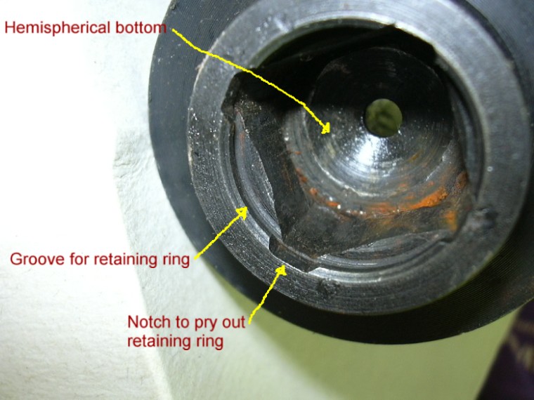

Here is a closeup of the socket. Both half-shafts had the same socket dimensions.
Mark

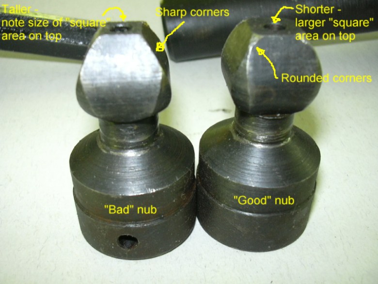

Here are the balls or "nubs" before I reworked them. After the grinding on the rough one, it looked identical to the smooth one.
Mark
