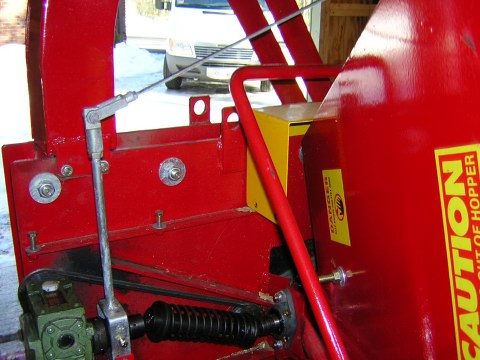

It looks like the cotrol rods are short. Here's a picture of mine. There's no interferance at all.

Hi TonyC - Sorry to hear that you had the same problem as I did. The retaining ring that I used was a 1" OD. This fix only has seemed to band-aid the problem though. Did some serious chipping last weekend, and seemed like I was going through these clips once an hour. Only good part is that it only takes me about 5 minutes to change it out versus the 6 hours it took me to get out the original. I would suggest getting the retaining rings in steel rather than stainless like I did the first time, I don't think they are as tough as the steel would be. I have ordered some steel ones to try out, but also ordered what I hope to be the ultimate fix, replace the factory part with an actual u-joint. It's not a cheap fix @ $35 but if it solves the problem, I'm all for it. It will require a bit of machining, and welding but I think it's worth a try. I'll keep you posted on where I end up on this. It seems to be only the upper joint by the gear reduction unit thats giving me a problem. I did a lot of studying this weekend to see what is causing the problem, and the only thing that I can see right off is that the angle from the gear unit to the feed roller seems to be a bit too steep for the kind of joint they are using. When you are feeding material through the unit everything works like you would expect, the spring holds the joint tight. Where it seems to get into trouble is with small twigs, and branches when the drum is in it's lowest position.

It seems there is something going on with the drive shaft that not all of us run into and while it may seem that I'm the only guy without problems, I'm the only guy without problems AND a computer. /forums/images/graemlins/grin.gif I am one of 3 locally who have these and we all have over 30 hours without issues. There are two dealers within 2 hours of my house, and they are both stumped.
I'd like to really figure this out so the dealers that import these can send a change request back to Jinma.
Is it possible that the ball end of the socket isn't cut down enough? The angle at the gearbox shaft and the roller shaft is the same as the shafts are parrallel. So if only one side is failing all the time, then there is something wrong/different with that end of the shaft.
If it were my unit, I would remove a small amount of material from the ball end of the joint where it is striking the clip before going through the effort of putting a u-joint in. A U-joint will have even a steeper angle to deal with as it will be wider than the current ball and socket joint.
Oooo, that leads me to this last thought, if the drive belt is too short, then the pulley's are closer together and the angle is steeper. I've seen replacement x-refs citing 36, 37, and 38" X 1/2" belts. The longest belt that can be tightened (limited by the slots on the gearbox mounting plate) would seem to be the best belt for the mechanism.
Please keep us informed and if you need any pictures of my unit to help, don't hesitate to ask.
