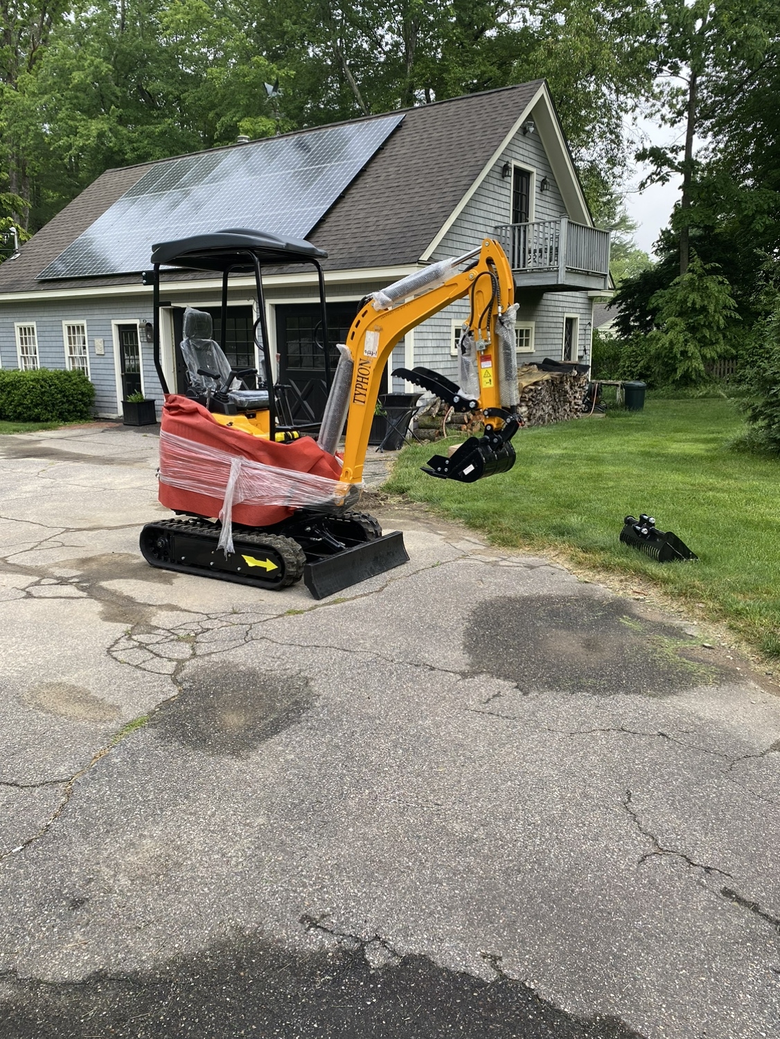

Well I got a note from Chris to contact the delivery dispatcher this morning and before I could call them the machine was in the driveway-l m on a trip now too so driver unloaded and drove up driveway- Liam the driver was a very nice guy

Like it says in my profile- coast of nh - north of Boston if you need a reference
The driver was from Pa so I think they bring them into east and west coast ports

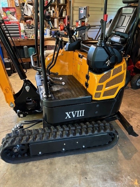

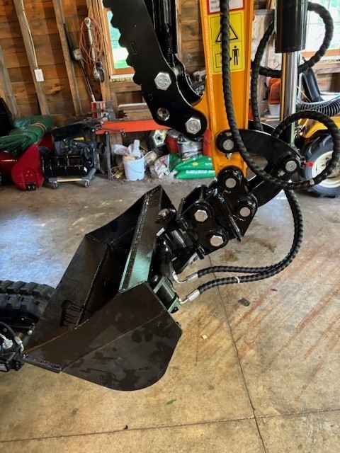

Took a few more pics today - got the QD and Tilting bucket installed, replaced the needle grease zerks with brass ones, and got it parked in the barn now so I can access all the machines. Still in clean up going over the machine and review/tightening everything, etc.
A few findings - the tilt bucket and foot control is too sensitive - it needs a flow valve on the tilting bucket to restrict the flow as its too fast - I need to research the options for flow control to the thumb and bucket circuit. The pilot controls are great as you can feather the controls, the bucket/thumb needs the same ability. I have a new foot pedal set on order that will sit closer to the floor boards and hopefully provide a little more feathering control for the bucket and thumb.
Also these machines don't have load sensing - another feature that adjusts the output of the Hyd pump to the load - that would be great to have - but probably another 2-3K in controls/pump.
Overall its well done for $12K - includes the quick attach, 24" screen bucket, and tilting bucket.
The seat is OK - a bit weak in the hinges and a rough ride, so may buy a $250 suspension seat if I can get one that fits the space.
