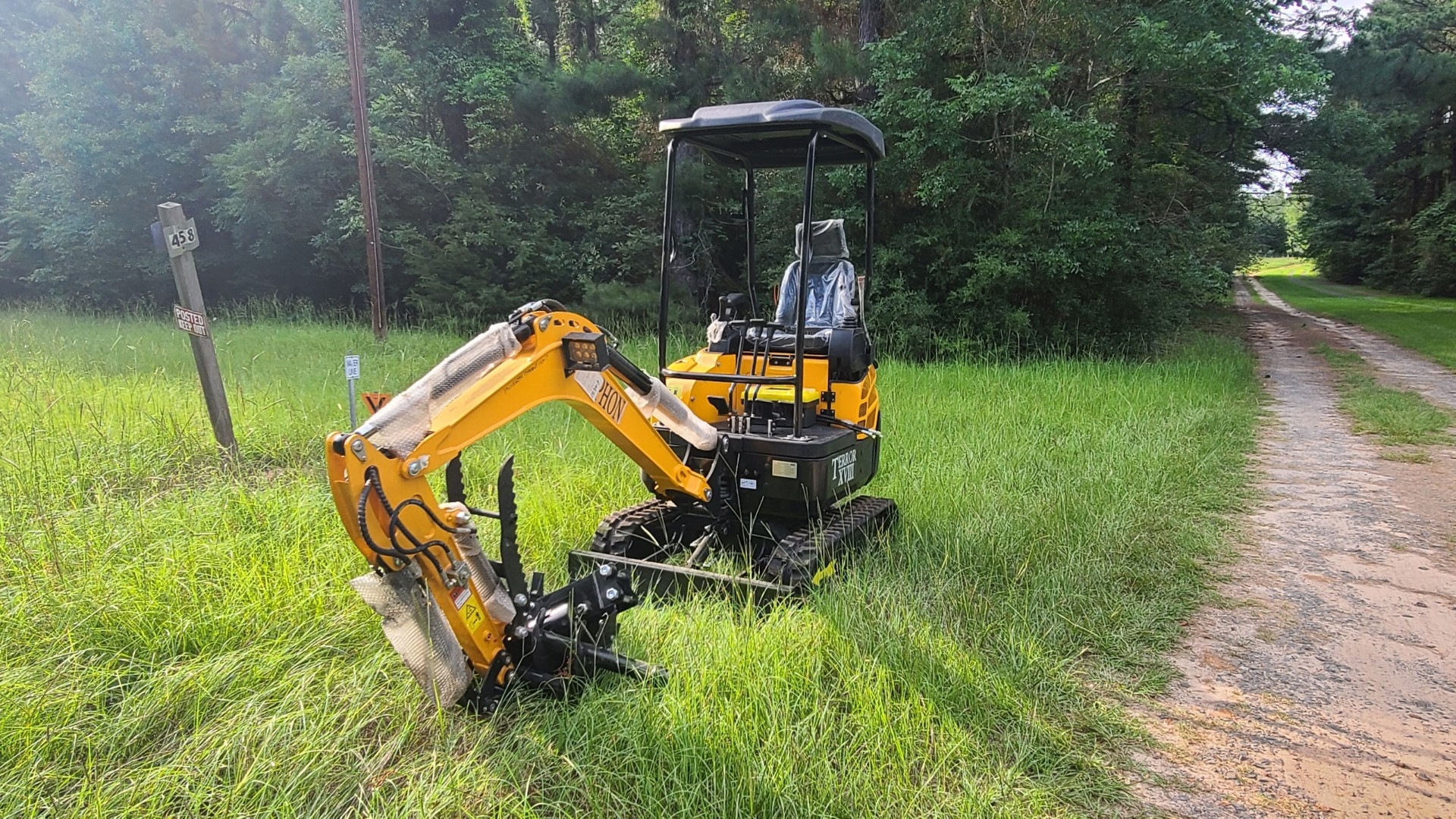

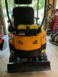

Got mine delivered a couple of days ago

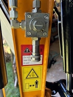

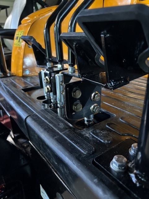

Still a work in progress here - waiting for the correct fittings to connect the Tilting grading bucket with the 14MM Hyd QDs I bought based on the Typhon suggestion (should have bought 16MM not 14)
Then have the drive motor protection from Central Digger supply on the way - not that this machine needs it - as the drive motor mounts and weldments are very robust - but I want to add the hitch plate.
Then the mod to the thumb/Bucket pedal was too sensitive and very hard to control. So I added a 2x3 plate and extended the pedal 3" out so I could easily control it with my foot. (the Aluminum ones were too low to activate the valve). Then by throttling back the control valve on the dipper stick was able to feather the tilting grading bucket with no issue.
More updates next weekend once I get the other stuff here. Then the mystery grease fitting on the dipper stick actually feeds the fitting in the stick (above the bucket pin).

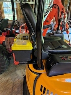

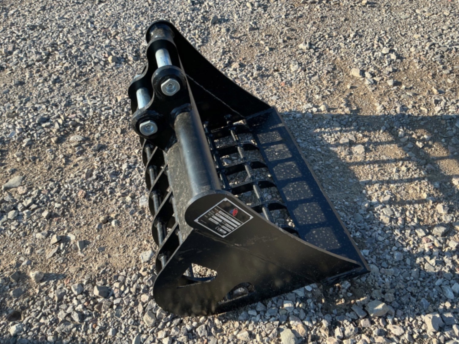

Finally got all the bits and pieces to finish the mods this week.
- Added the motor brace and hitch plate - welded on - the drive motor mounts are very robust on this machine - I dont think it was needed but its done now. Was going to add plate over the lines but decided to see how this works
- Added stiffener plates to thumb - 2 3" x 3/8" thick plates between the tines - the round bar just wasn't enough with the rocks I deal with - also made sure it didn't hit the boom or bucket
- Mounted the tool box behind the seat on the rops bolt and padded with adhesive foam
- Got the hydraulic Tilting bucket QD done finally - went to a local hyd house - needed two DIN14 seal gaskets and 2 14MM BSP to 14MM DIN connectors so finally have this solved.
- added 3/8" cutting edge to screening bucket - the stock sides are very thin so this was needed
- Got an 8" rock / trenching bucket - $180 - much better built than the stock buckets and the tines on the thumb mesh perfectly with the bucket.
- The fuel/oil tank cover rattled so added the black edging material around it and some rubber bumpers underneath and now its tight.
it's now going to get worked out this weekend and next week clearing a patch of ledge and rocks.
