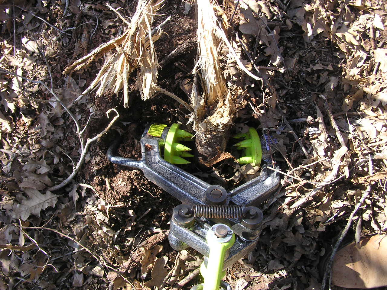

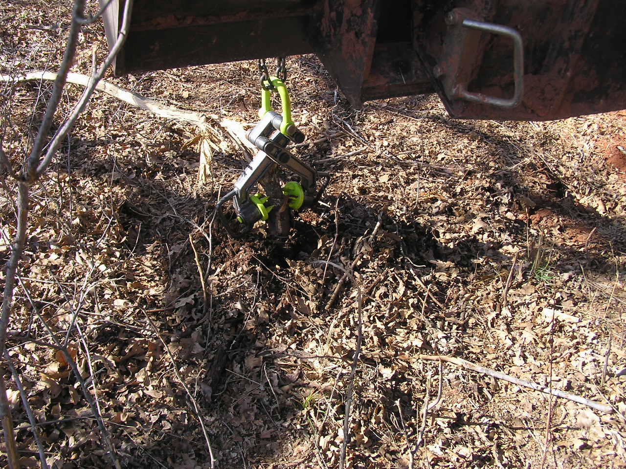

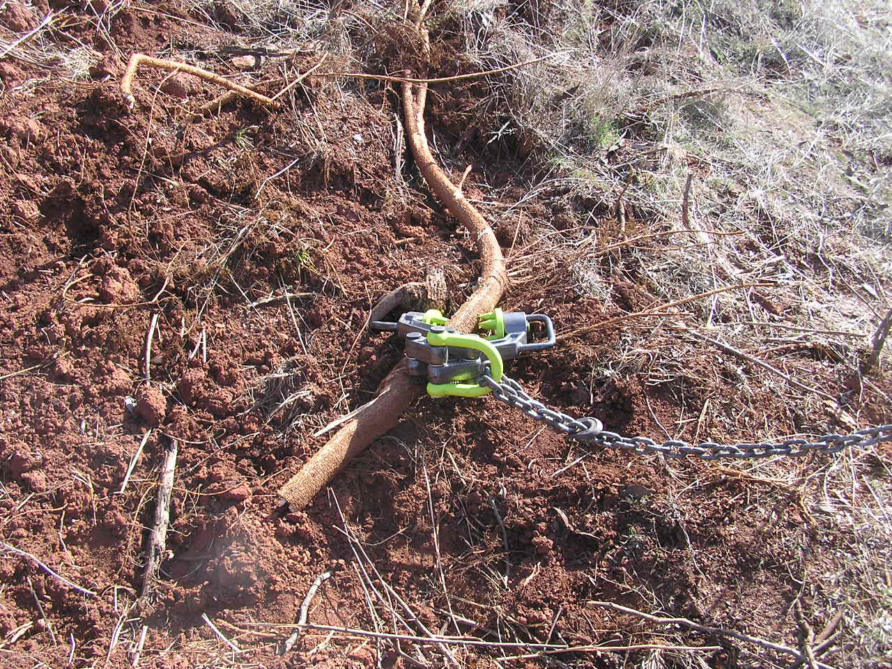

For pulling small trees, it's hard to beat a brush grubber. That's not a job for a choker.
   / Choker Cable Size Recomendation #17
A brush grubber is also great for stumps.
And roots.
