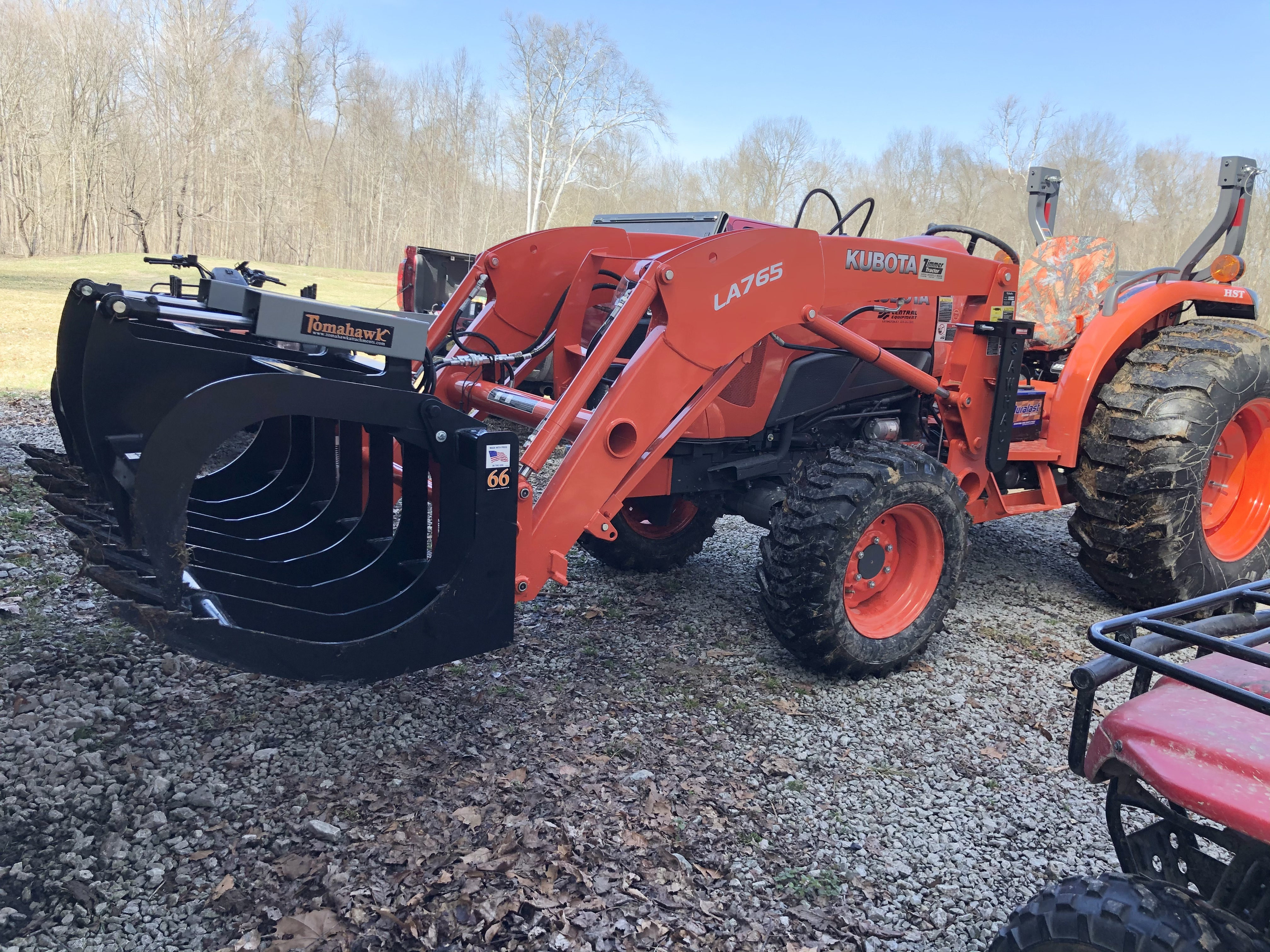

Then after got that fixed it I got the Summit 3rd Function Valve and added a Grapple.
Nice looking setup! I'm waiting on my grapple and planning to install my 3rd function valve today. Do you have any tips for how to wire the 3rd function? I've seen a bunch of videos on the install, but everyone skips over the wiring part. I'm guessing because it's taken for granted that people will know how to do it.
