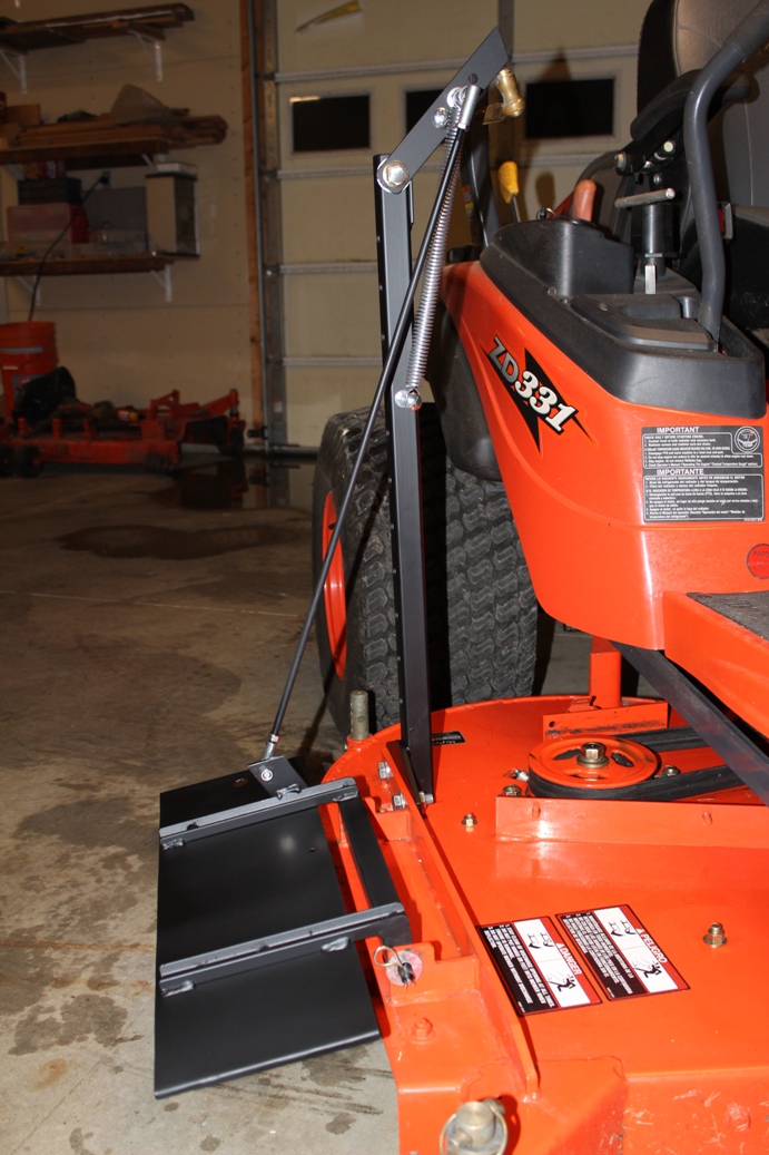

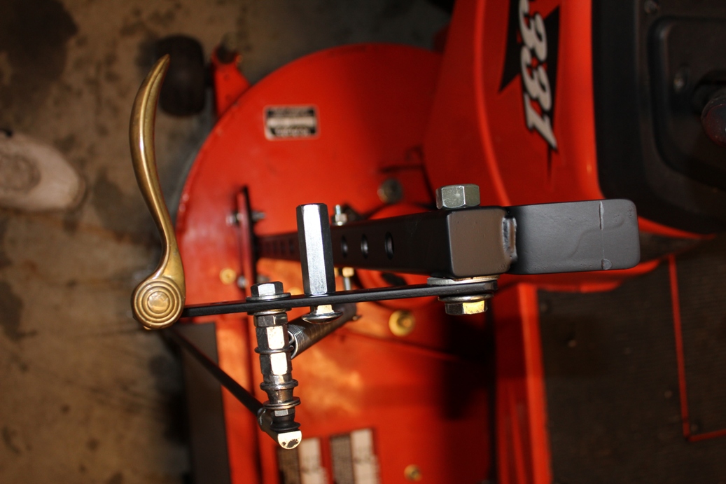

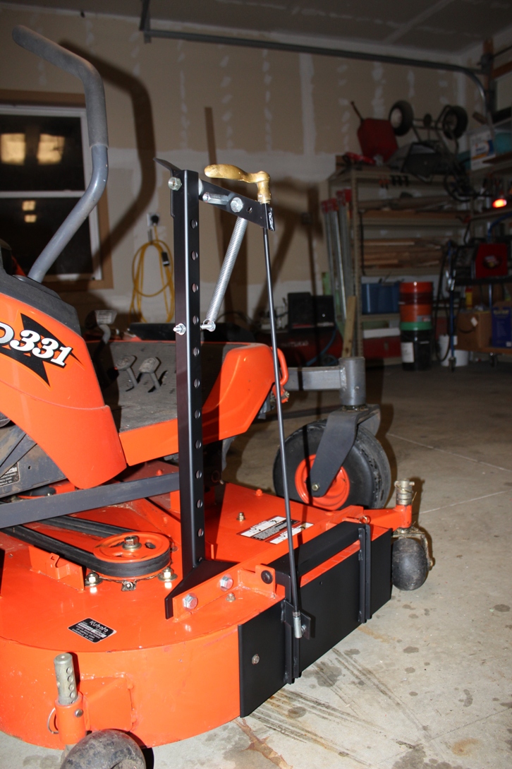

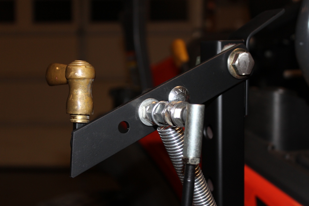

Completed and installed a chute blocker on my Kubota ZD331.
Used scrap metal I had laying around, and an old door knob/handle for the lifting arm. I also used some old hemi joints for the pivot points i had taken off a Harley Davidson shifting linkage.
I spent about $10.00 for the spring, a little hardware and paint.
Operates pretty smoothly. Will put it through it's paces next spring.
