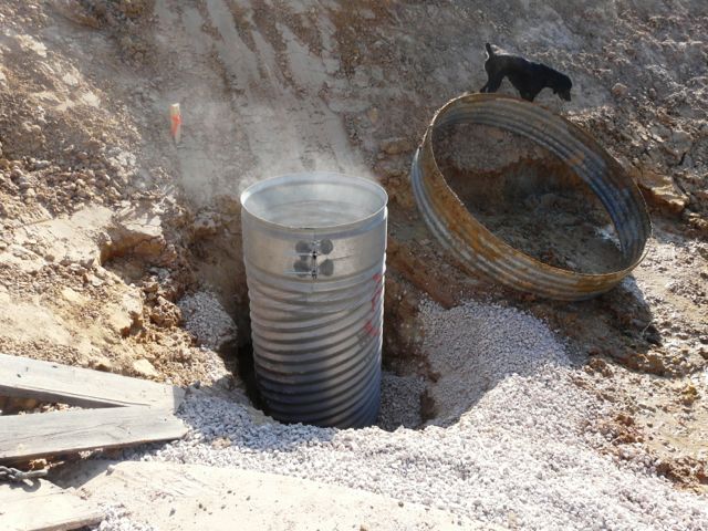

OK, now to the wishing well. Actually that is my next project down by my spring pond.
During the drought I dug down to the spring, cleaned it out, set in the bottom half of the culvert. I then bought a 3' piece of culvert (not in picture) to add to the top clamped piece and will make a wishing well. The water has cleared up and the culvert is full and I can see the bottom 5'. I was thinking of using rock and mortar around the culvert but your idea of a cement form using plywood or fiberboard is also a possibility. It looks like you will be the first so please keep me advised on how you do it and what it looks like.

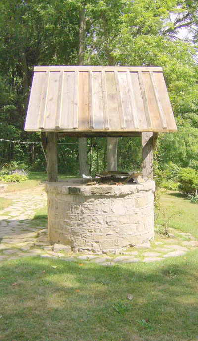

txdon thanks for the reply. I have been collecting rocks in my yard for the last two summers as I attempt to smooth out the yard. I have amassed a good number. All different sizes and shapes.
Never having worked with rock before I thought that after building the wall row by row with motar I might try to copy your center circle pouring technique, and pour small sections to use as the final cap stones around the top.
Something like this although not with nice stones as pictured, but rather my random collection of sizes, shapes, and type. Since it's not going to be functional I don't need to worry about the inside face of the well.
Still undecided how to best attach the roof to the base. Some place the timbers inside the circle, others outside, and in this picture I am not sure.
I've got a good size rock lurking in the ground so rather than try to remove it I thought why not try to pour cement around and build on top of it.
I am hoping such an attachment would help as I am in a zone where the frost goes down 4' below the surface.
The picture I tried to attach was one of your own showing the circular design apparently in the middle of your turnaround area.
I am imagining the well to be about 4' to 5' across. All outside work for the season is over up here. So I've got all winter to come up with a final design. Maybe then people will finally stop asking "what's with all the rocks in the back yard"!

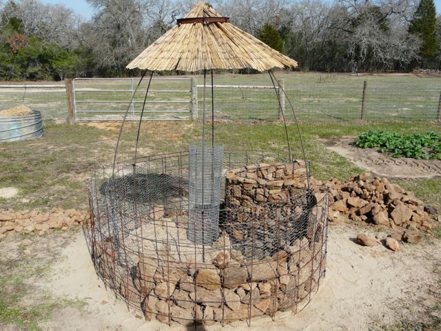

OK I got it, random rocks. I had random rocks and made a keyhole garden. The pictures below show how the exposed rock with no mortar would look. The top edge is river rock. (I'm redoing it this winter adding mortar.)
The braces for the top of your wishing well should be incorporated into the wall. (or at the least, inside). The hard part will be forming a good round circle that small with the framing material. I tried with fiber board and it was kind of tear shaped. Place dividers into 4ths or 8th when you pour so you can lift them. You could even leave a space for a 4x4 in the middle of two of the cap pieces.
