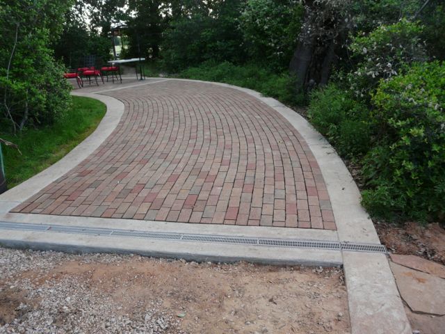

Paver Ron kept up the pace and kept me going till we finish laying section 4. Tomorrow we tamp the pavers smooth, recheck the spaces, and pour/sweep in the polymer sand. This is going to be a new record if we can finish tomorrow - a section laid and set in 3 days!
Here is a picture of section 4 with drain, but before tamping and polymer sand. It contains about 1200 pavers.

That would be a solution if the polymer sand was less expensive than cement and I would not be almost at the maximum spacing now.
After section 5, I will get an accurate count and decide where to put the last 40' of outside curbing to cut the entrance ramp off the paver area. Hopefully the "Q" shape of the drive will be all pavers except for the slash at the bottom of the "Q". Preliminary estimates indicate about 400 pavers short with a margin of error + - 400.
If I am short I'll just have extend the entrance ramp to the inner curbing (instead of the outer curbing) saving about 500 pavers.

Ron was giving me some ideas on where to put the final curbing. It can be installed in a even fashion in several places and a different type of material or design could be laid or poured in the shortage area.
With the thought of a mosaic design on the entrance to the circle this project is taking on a new creative twist.
I just need to come up with some type of design. I'll take a picture of the area of concern, so you can see the shape we have to work with and post it later. If I go with mosaics, I'm thinking more in the lines of nature (animals, trees) or farming (tractor), the theme of this rural Texas area, or a large Texas design.
Another option would be cement in the middle with a sidewalk wide boarder of pavers, on the last outside parts of the Q that nicely tie everything together.
Thank you for your ideas.
