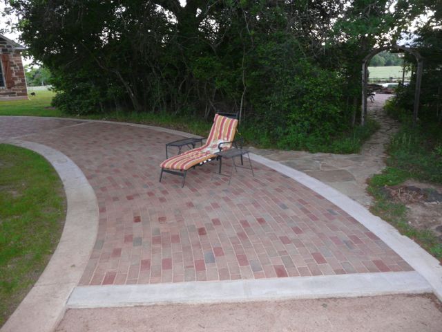

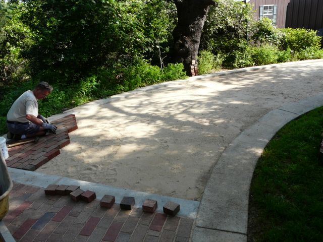

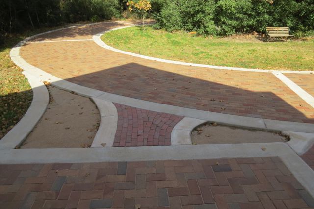

UPDATE:
Section 3 is complete. It is in the shade of the big oak tree and can be used as a patio also.

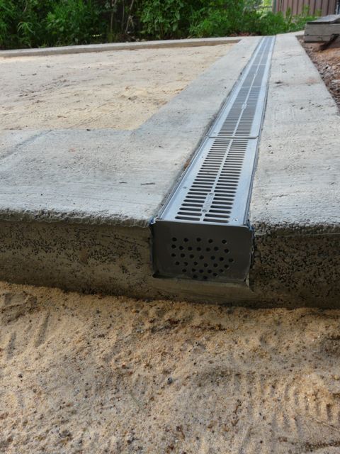

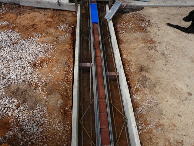

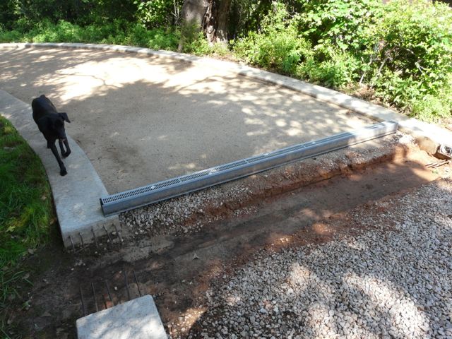

Section 4 is an interesting section because it contains the drain for the circle.
I loaded the drain with pavers so it would not float when the cement was poured. I also taped the top grill and installed it so the wet cement would not bend in the drain and make the top grill impossible to install when it dried.
I poured the cement underneath and 6" on either side of the drain in one pour. The cement is 7" thick.
I put on an end cap and drilled holes in it to allow the water in and keep out the snakes out.

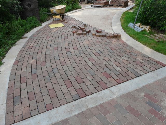

Section 4 - reinforcements arrive!!!!
Section 4 was started this morning with the welcomed help from Ron!
By the end of the day we had placed about 600 pavers and half of section 4 is complete. :thumbsup:
