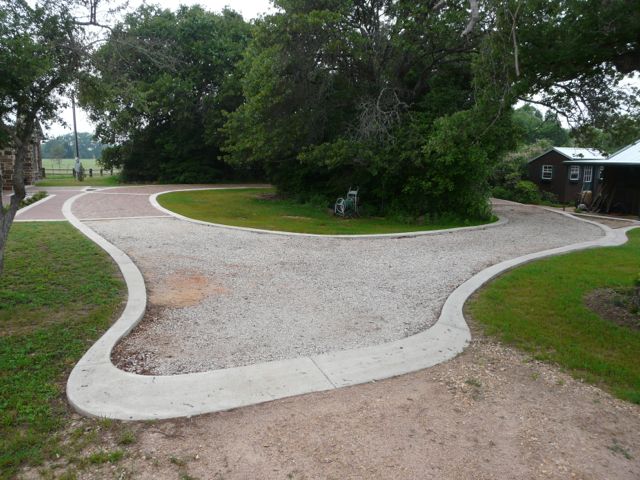

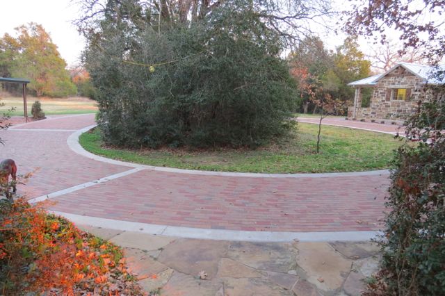

here is a good picture of where we are.
You can see the beginning of section 1 and the end of section 4.

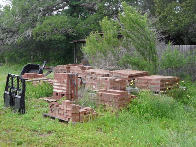

I have enough pavers for only 3/4 of the remaining curbed in area.
The other picture is the stack of pavers I have left.
A decision will have to be made shortly on which stretching method to use and have it not look like a stretching method.:D

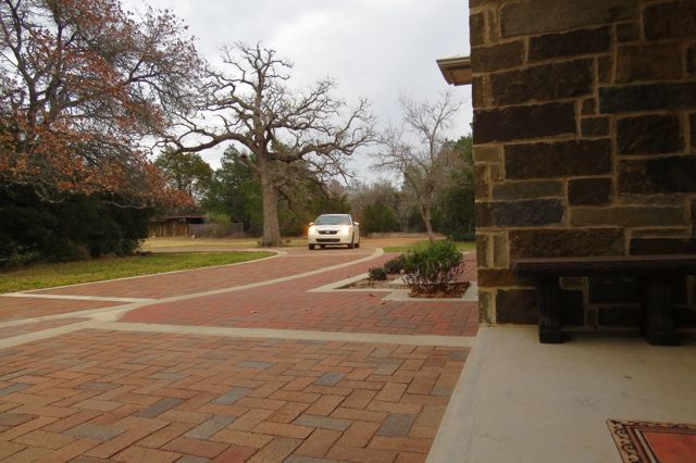

A couple of pics from the sidewalk lay.
The driveway pavers are on the porch at the bottom part of the last photo.
How many pavers did you use on the sidewalk? Can you pull them to get enough to finish the driveway and then put a different color or style in for the sidewalk?
I'm very nervous about a pattern or something artsy to make up the difference. They either come out amazing, or incredibly odd looking. Sadly, most of the time, it's pretty bad.
While ACME has told you that there are no more pavers, and I have no reason to not believe them, have you called each store individually to see if this is true? Or to see if they have sold to places with some inventory?
I had a job a couple of years ago requiring a Mexican Adobe brick. They where a lite tan shade that had to be just right for the job. I needed 2,000 bricks and was only able to find 500 locally. The people at ACME Brick here in Tyler gave me a list of brick suppliers in the DFW area that might have more. I called a dozen of them and half of them said that they might have what I wanted in their yard, but I would have to come and see for myslef. I was able to find the remaining 1,500 bricks in three different yards. It took a full day, and I paid a bit more for them then there then I did in Tyler, plus burning gas, but that's just part of what it takes sometimes.

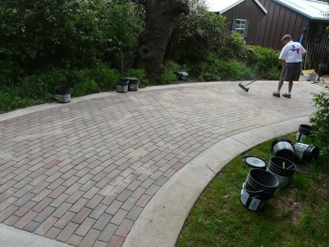

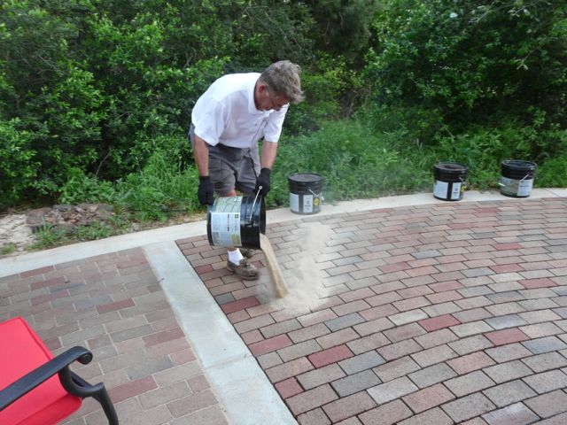

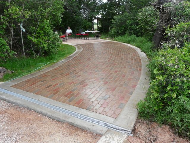

Today we finished section 4. YEA!
We hand tamped the pavers, recheck all the spaces, elevation and replaced a few that cracked. We then poured polymer sand and swept it in the spaces, hand tamped it all again to set the sand and re-swept it and then misted it.
